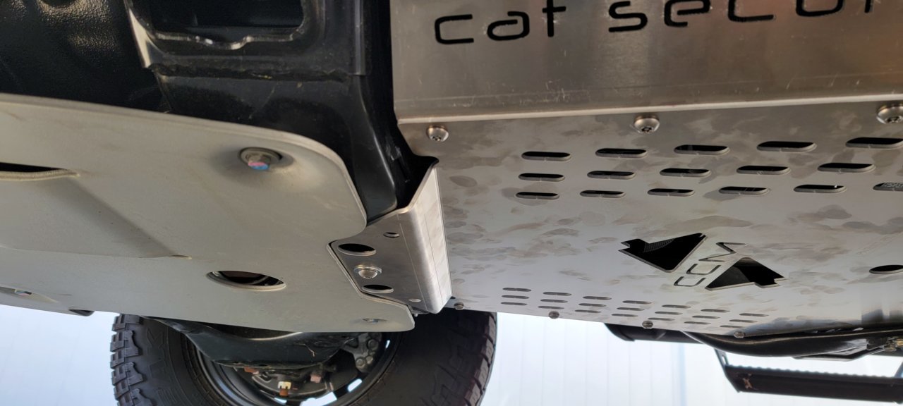

    Generally, skid plates/armor don't have the side wings needed to prevent a reach-around so a hand tool can still get up there. Some have welded on tabs to prevent this on their skids.

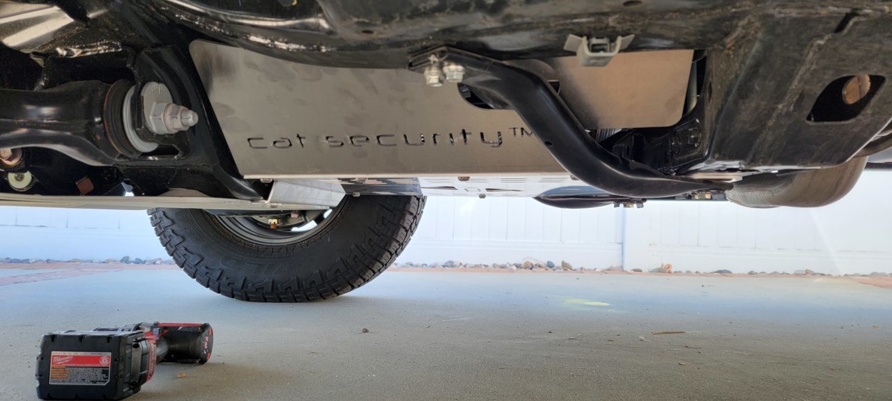

    Starting a new job on Monday here in Phoenix. The HR lady told me to park in back when I come in. Then she warned me, 3 people have had cats cut out of their vehicles recently.:goingcrazy: I asked about the security guard building at the entry gate...apparently there's no one in there.:frusty: She said the corporate office advised this division 's employees to install cat guards. Really? WTF! So, in the meantime, I'm going to drive the Subaru. We're saving for a new house and I hate to spend money on the truck right now but, DAMN... $2-4K to replace?:annoyed:
    Great photos BTW. :thumbsup:
    Looks like a TRD front skid(?) and your Cat Security fit nicely. I may need to consider putting one on with the option of upgrading to the TRD front plate later.
    Will most cat guards work with standard and TRD front skid?
    Are those "security" fasteners enough you think or, are there models where the sides are permanently attached?

    Wasn't aware of the D &T requirement. Are you sure?
  13. Feb 10, 2022 at 9:35 AM
    Chaosh1
    Chaosh1 Well-Known Member
    Mar 11, 2021
    #358942
    369
    2021 Tacoma TRD Pro
    I didnt, And if you search the forums most people didnt. I jsut beefed up the center front security point with a wide washer set
    Dawelda[QUOTED] likes this.
