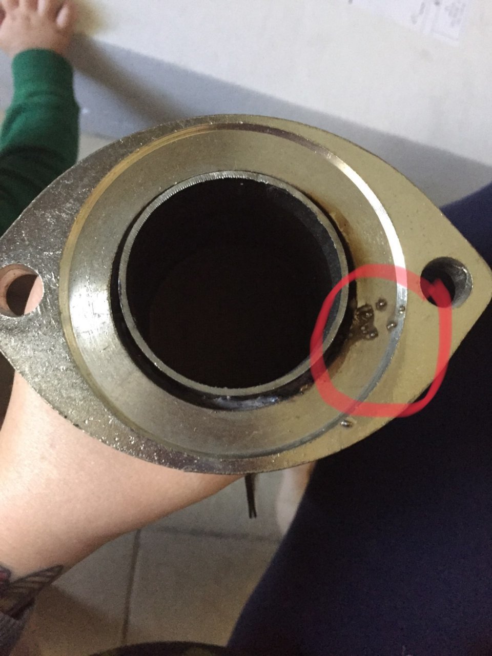

    For mechanics out there, I just purchase a cat from Flowmaster but right we’re the gaskets go in has some metal bits from the welding they did, don’t know if that will make it leak since I don’t think it’s going to be completely flushed to the cat. Does it matter? Or it’s all good.

    It will leak if those are large drops, either grid it smooth or return it

    Yeah I think I’m just returning the damn thing.

    Will not leak. That's why toyota use compression, one time use gasket designed to seal the entire surface.
    Magnaflow is decent unless you can fork the thousand for oe toyota cat.

    I have notified our Senior Tech of your inquiry and I will post his recommendation as soon as I have it. In the meantime I wanted to encourage you to give us a call at 707-544-4761 to get a speedy solution to your problem. My apologies that this was missed during inspection.

    Because the stock exhaust uses a "crush" style gasket or "doughnut" in between connection points you should not have any exhaust leaks when properly installed.
