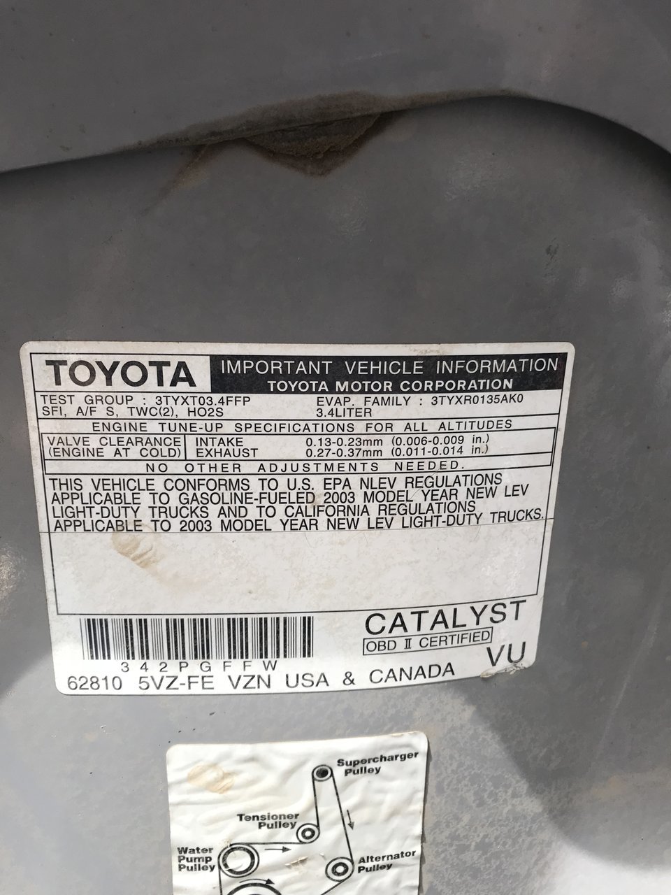

    Take a picture of emissions label and I can look it up to see if there is an aftermarket option for you to use. If they are indeed bad than you have something else going on that's destroying them. I would figure out what's causing failure first before anything. Convertors should last the life of the truck if everything working correctly. You burn coolant at all?

    Here is the pic. I’m not burning coolant at all. Now that I remember I’ve already replaced both converters twice since I bought the truck in 2011
