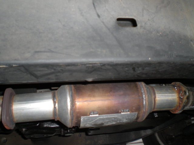

    Here’s the upstream cat from mine. ‘03
    not going back in

    Thanks, my front pipe has a flange, it's not welded. I appreciate you posting that

    So do you have the one cat version? My pic was a bad representation bc the PO cut out the downstream cat and welded pipe to it. I then took that out and did a full new exhaust from header to tailpipe in the pre-99 one cat configuration, just with a “test pipe” instead of a cat. All bolt up. I’d say if yours has the two cats, that exhaust you want should bolt right in, but if you have the one cat setup, it won’t work. You’d need a longer piece to mate up with your cat.
