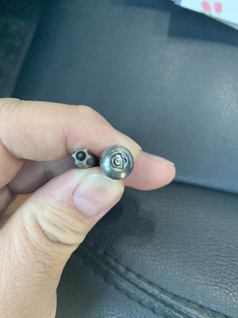

    Well this is getting a little ridiculous now. I finally get the screw and it’s the wrong head. My key is a for 6 point star(left). The one you sent is a 5 star type head (right)

    Our sincere apologies for the mixup. We should have requested for a photo of your tamperproof bit prior to shipping as we have a variety of them. Thank you for your patience and understanding throughout this process and we hope the Cat Shield serves you well!

    Got the correct missing screw. Thanks @MillerCATCorp

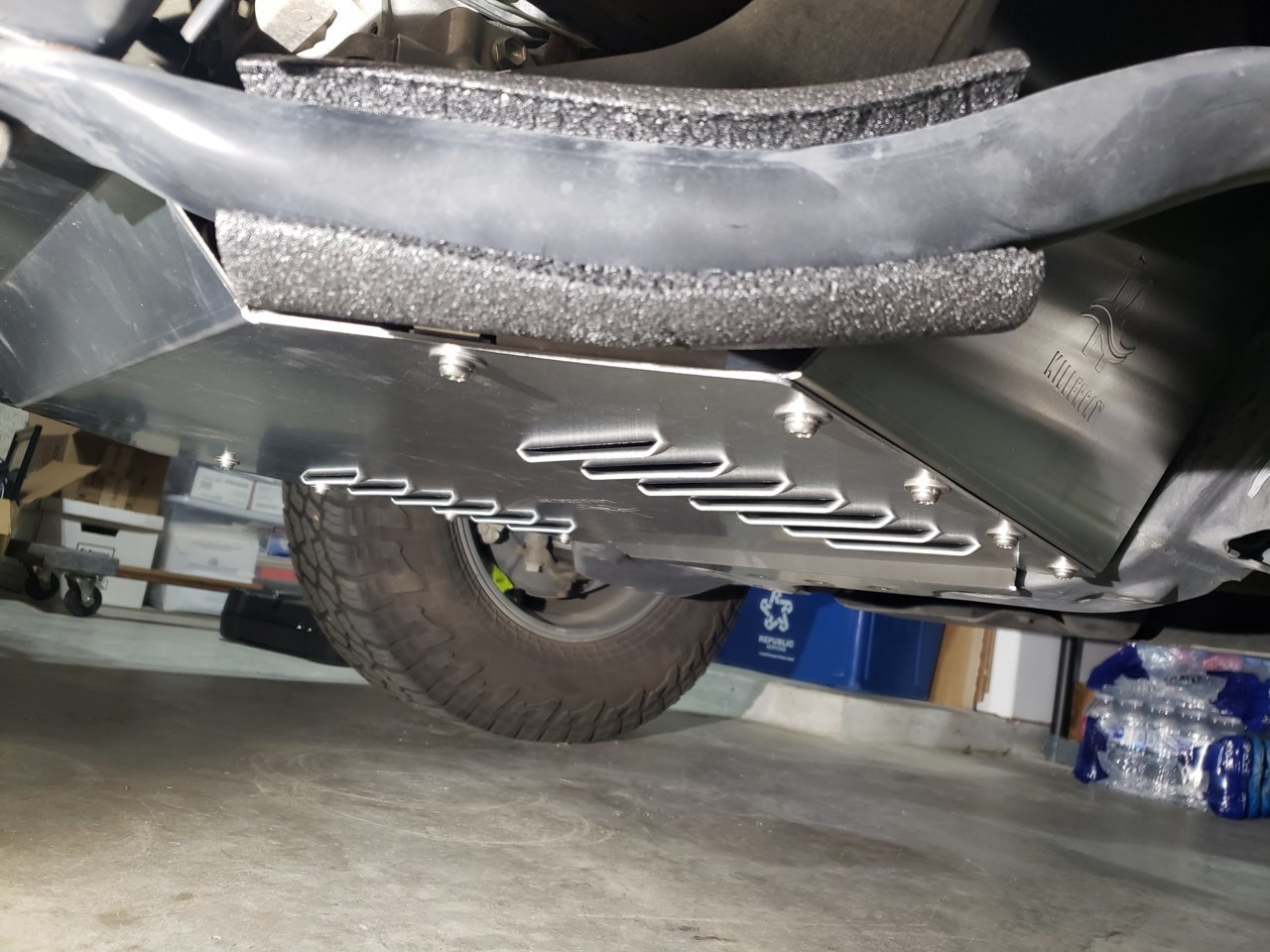

    Installed the Millercat aluminum skid. I’m impressed with the product and the install was straightforward, all hardware needed was included. I did add 2 pieces of pipe insulation for potential rattles, one on the passenger side crossbar and one on the driver’s side where the top corner is close to the frame. AE0FF7BF-2DCC-4E22-8398-DEB61169E640.jpg41167AE5-6D2C-4B15-B5A1-7CD92A635147.jpg

    I think it's 1", just some I had laying around. It doesn't completely wrap the cross bar but doesn't need to, its wedged in tight and has been rattle free.
