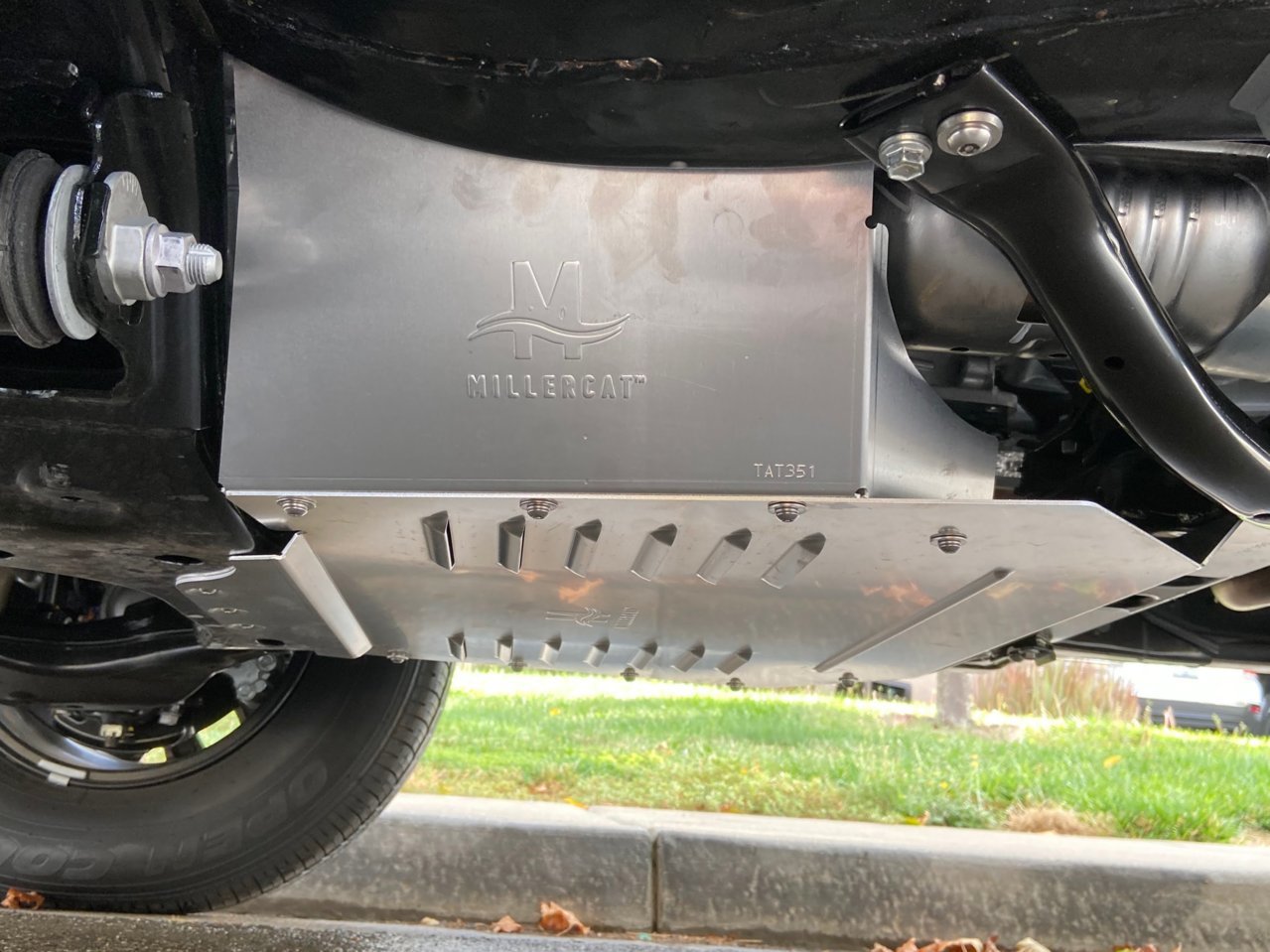

    I was picking up some parts for my taco at the dealer yesterday and saw someone picking up an oem cat for their truck since it got stolen. I decided to look into this shield since it was pretty well known. Started reading this thread and put an order in but found out they are a local company to me. Did a shop pickup and installed it right away.
    Several takeaways:
    - I should have sprung for the stainless version since it appears to be more robust. The aluminum version I got is a little flexy.
    - after installation, I noticed if I pounded on the shield it would rattle near the rear brackets. I put some 3m vhb tape between the shield and where it meets the chassis to quiet this down.
    - the infamous 3 bolts on the front were slightly problematic lining up, but not terrible. I hand tightened all bolts, but the 3 bolts in the front seem to just snug up and any more tightening, the threads will strip.
    Overall, I'm happy with the product and I hope it helps in deterring any thefts!

    Thanks for sharing. Would you please point out where exactly you applied the 3M VHB tape?
  17. Sep 16, 2022 at 9:26 AM
    #137
    stan23
    stan23 Well-Known Member
    Jun 20, 2014
    #132351
    2,460
    stan
    Santa Clara, CA
    2025 DCSB TRD Sport 4x4
    I put them here. It was really obvious after installing that if I hit the shield with my fist, it would rattle here, no matter how much I tightened the cross members, I would get a rattle. I almost want to say this probably wouldn't happen with the stainless version because it is thicker and heavier, but no idea.

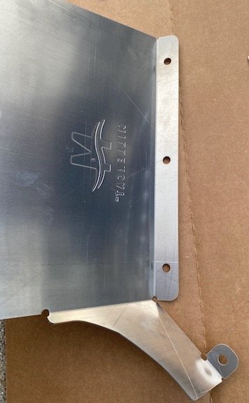

    Unfortunately, I received mine Friday, and the smaller shield did not have the threaded nuts installed on it.
    I did contact their support and they stated a batch of these went out. I was told they would ship me one but I have not received a tracking number or more information yet.
    Thankfully I did not start tearing things apart and checked things out before I started.
    Edit: The replacement shield arrived in good order. I suspect this was a costly error on their part having to ship out replacements.
