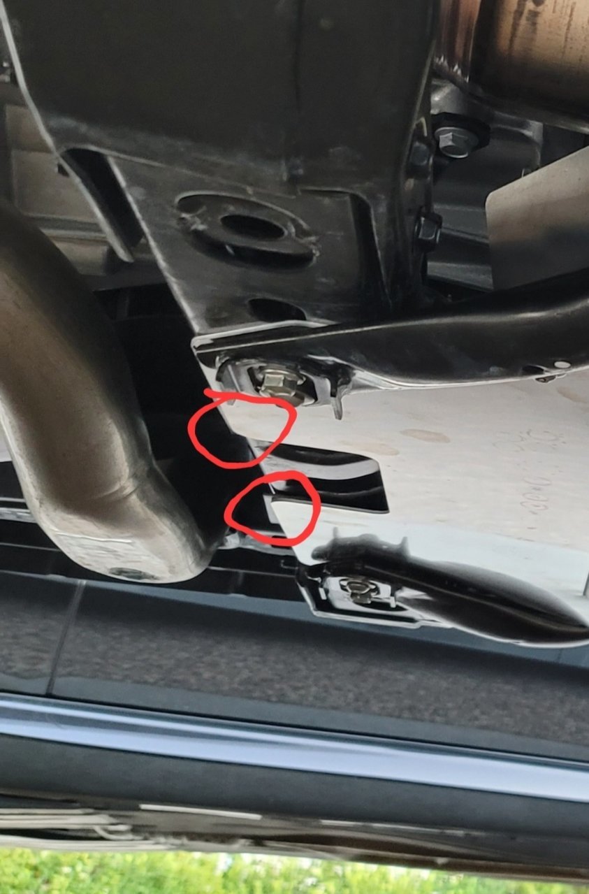

    I was amazed at the closeness of the shield edges to other parts on the truck. When first positioning I expected problems and a need to trim but it turned out fine. Awful close but nothing touching to bang. I flexed shield as I installed to make sure.

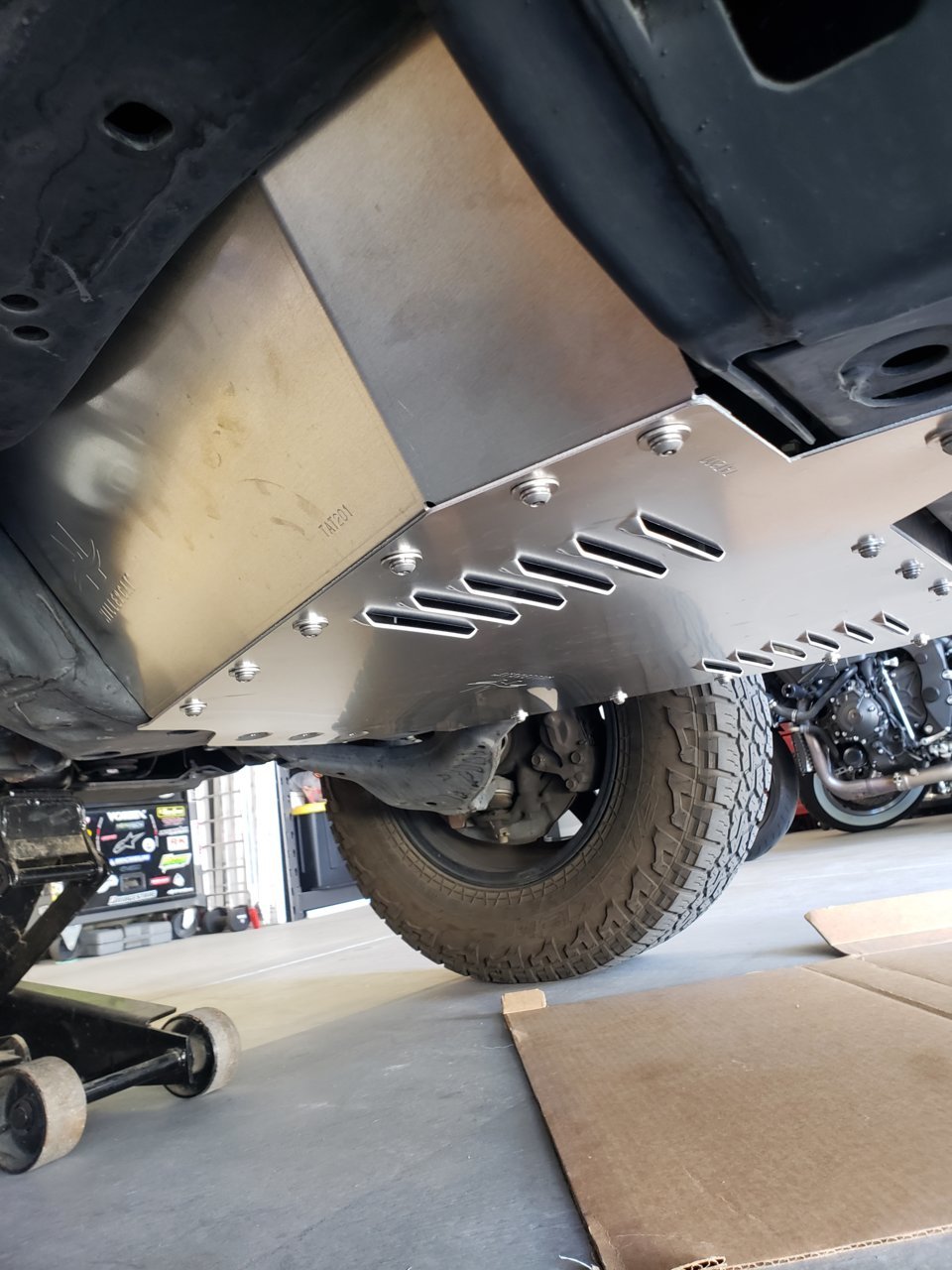

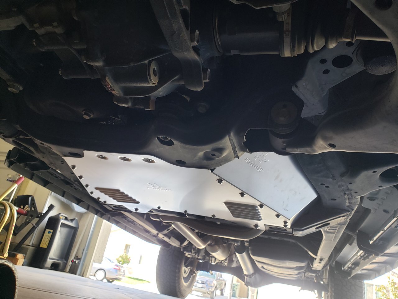

    Fast shipping, great instructions and straightforward installation.
