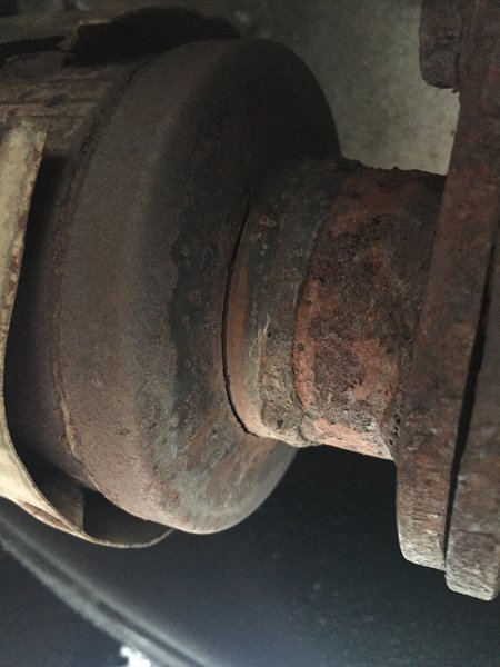

    I'm glad I searched the forum for this, I was about to start a new thread. I have a bad front cat, there is a crack and I can hear the exhaust leak pretty bad. After I looked at it I'm kind of worried it will just come apart while I'm driving. So of course I'm looking for a new cat. I already have a cat back exhaust from magnaflow and it's in good condition despite being on my truck for 7 years in New England. So I looked for a new cat from magnaflow and there are two different direct fit bolt on cats from magnaflow for my truck. One is OEM (part number 51679) and the other is "STANDARD/HM" (part number 23759). Does anybody know what the difference between these is? The other confusing part of it is that they are both sold on Amazon but Amazon says they don't fit my truck and the OEM part number is cheaper than the "STANDARD/HM". I just want to make sure I'm getting a the right part for my truck.

    And here's a picture of my failing cat:

    #35969
    70
