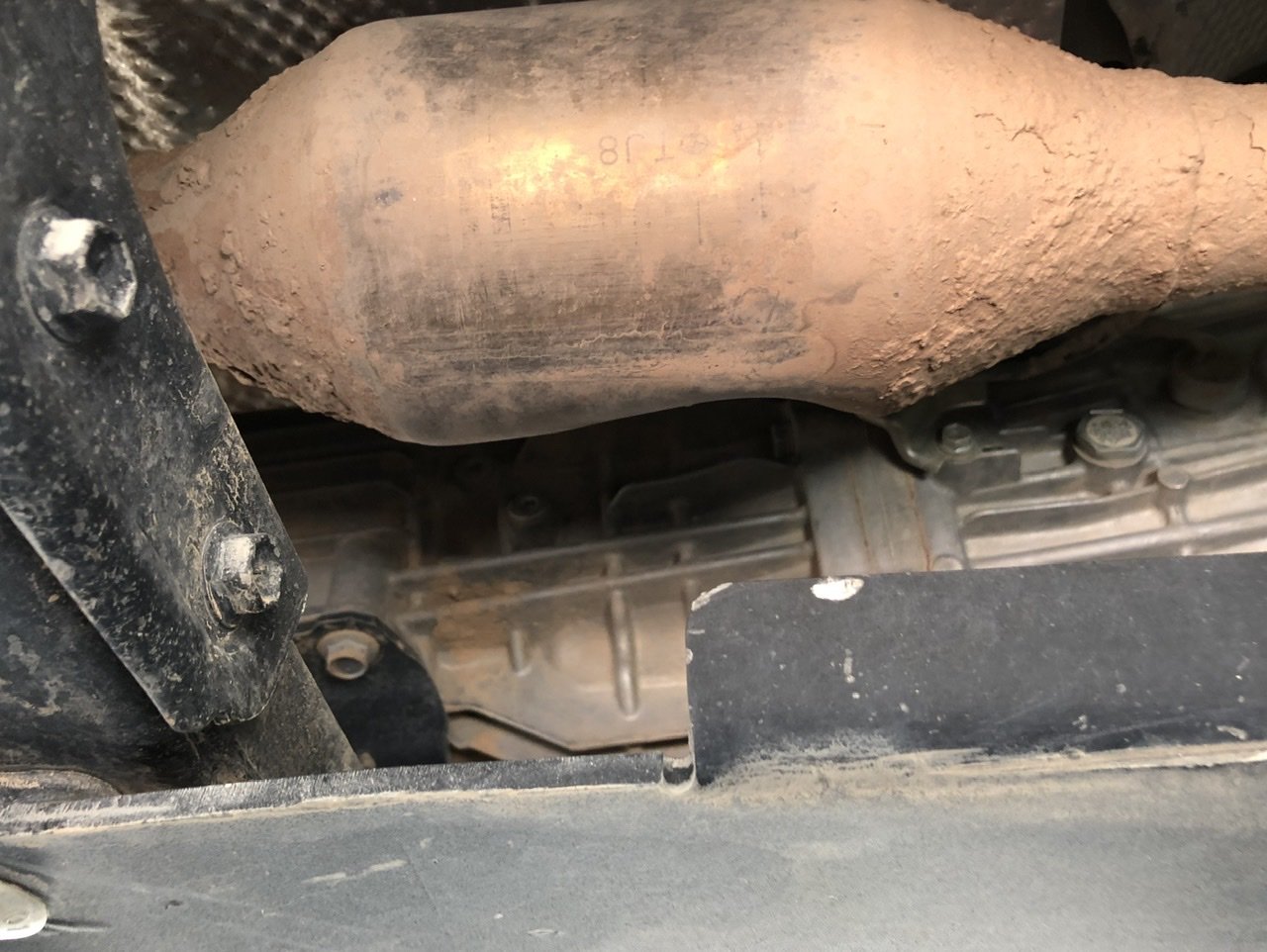

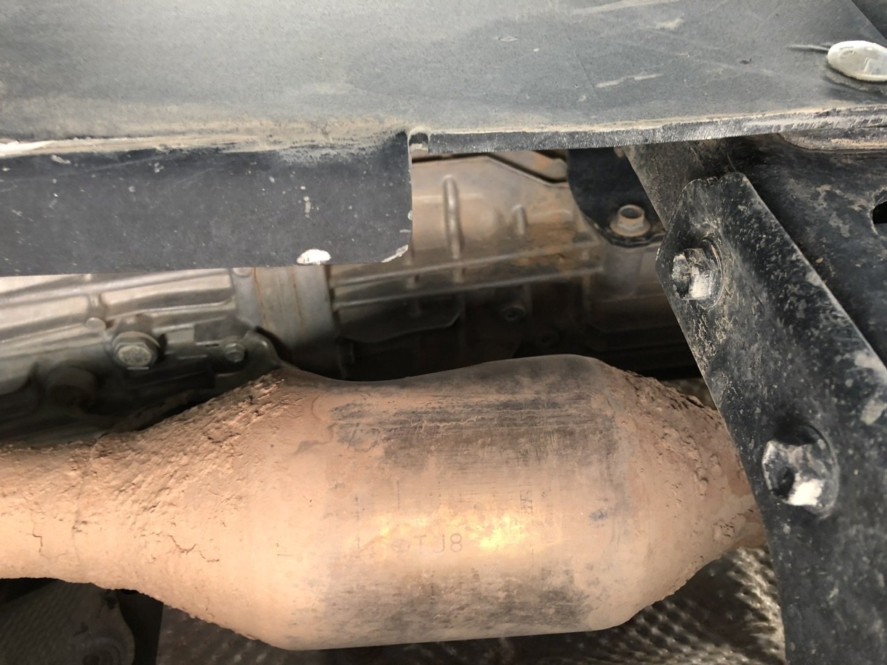

    Hey guys, during my ride home yesterday ( on pavement ) my truck developed a clattering noise, like metal slapping metal....I poked my head around and it sounds like it's coming from the front catalytic converter-- I noticed a dent/depression in the side of it that doesn't look like it should be there, however it's on the side of it that my skidplate mostly covers. The dent also doesn't look new--there's plenty of caked on mud and dirt.
    Has anyone else experienced this noise before, and can anyone post pictures of theirs to see if the dent is supposed to be there?

    Took a peek at the heat sheilds, knocked on them a bit. No change, no rocks fell out. It did not make the noise when I started it, but when I parked it was making the noise.
    Makes me think it's definitely the cat. No idea when or how the dent got there but seeing it in daylight I'm certain it's not from factory. It's in a spot and direction that there's no conceivable way it could be caused with the skidplate there and intact....so it must have happened when I first got the truck....
