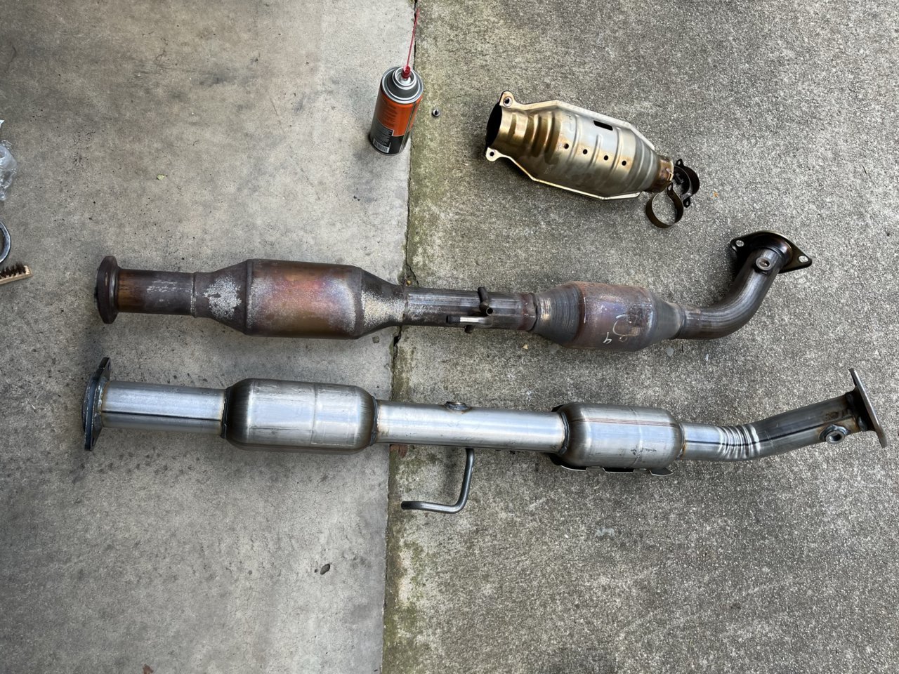

    I had this same situation a few weeks ago with my 2013 Regular cab. In just a matter of a few weeks after first hearing the rattle, the truck lost power and then it threw a code with C.E.L.
    My code reader identified the downstream O2 sensor as having a fault.
    I ordered a new pipe with catalytic converter and both upstream and downstream O2 sensors. Replaced it all and it the truck runs great.
    Good luck with your truck.
