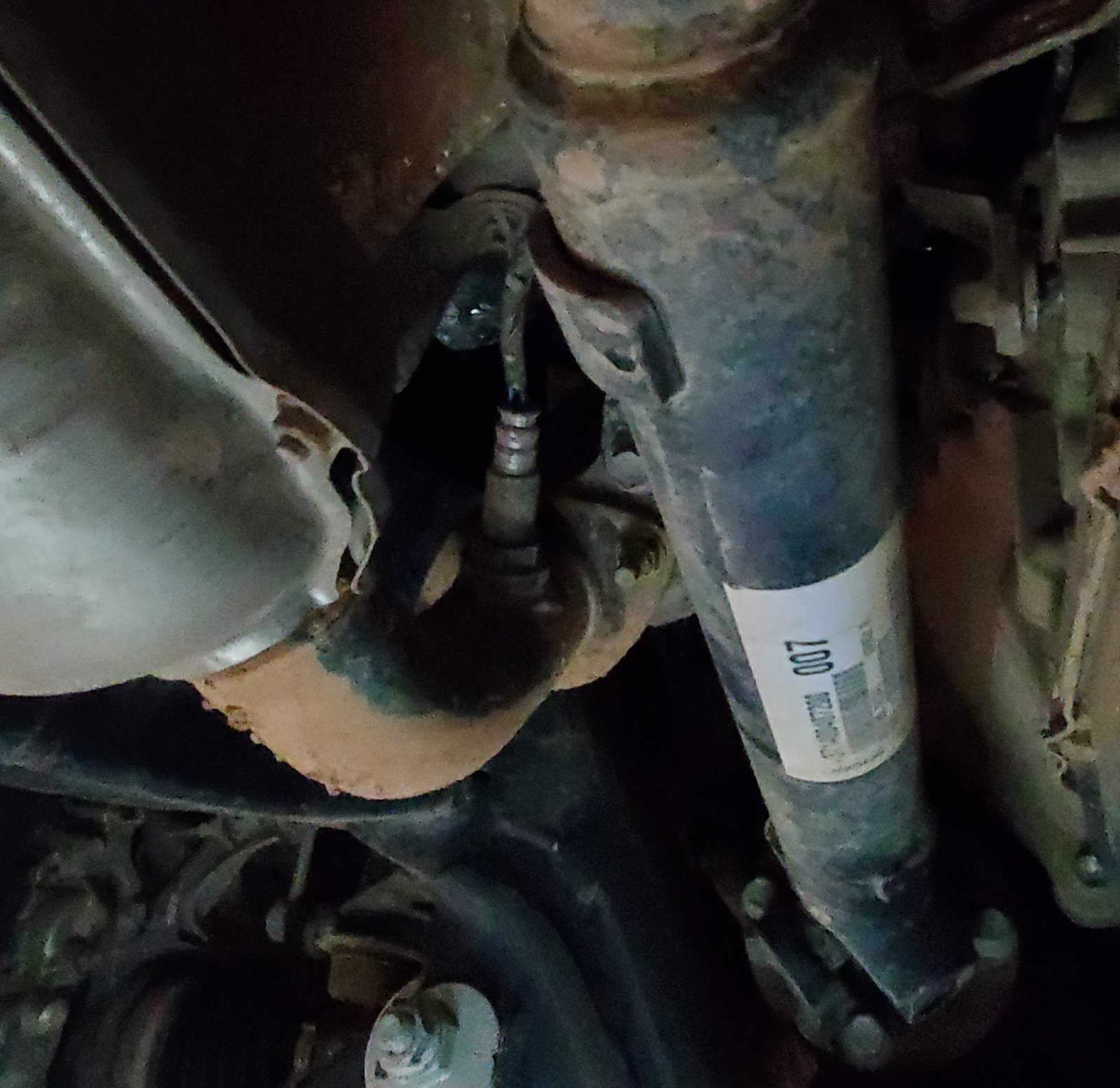

    Sorry for the crappy pic but, not sure what I'm getting into here. Trying to remove driver side lower cat. Two flange studs with nuts, one visible in photo. There have been several days of WD-40 soaking in advance of this.
    Appears to be a stud with nut retainer on it. I can't break the nut loose with a socket.
    Before I try an impact, I have 2 questions:
    1. If (that's if...) the nut comes off, should the cat slide off the stud or, does it need to come out too?
    2. Likelihood of breaking the stud while removing it and/or nut?

    PB Blaster may be worth a try too. I've had a couple times where WD40 wasn't cutting it but soaking with PB Blaster did the trick to loosen bolts up, so now I just use it from the start instead of WD40 since it seems to handle rust lockup better.

    Not a bad idea, that shit works! We used to call it Peanut Butter blaster!:rofl::rofl::rofl:
    I wanted to use Kroil but, mine is in a can and I can't dribble it uphill:frusty:

    I don't ordinarily work on cars.
    I found a breaker bar and they all came loose. I'm all good. :anonymous:

    Penetrating fluid doesnt like to work upside down, also it doesnt make a bolt any less tight.
    Heat is the answer, a small propane or butane torch to heat it up stupid hot first is the best thing to do.
