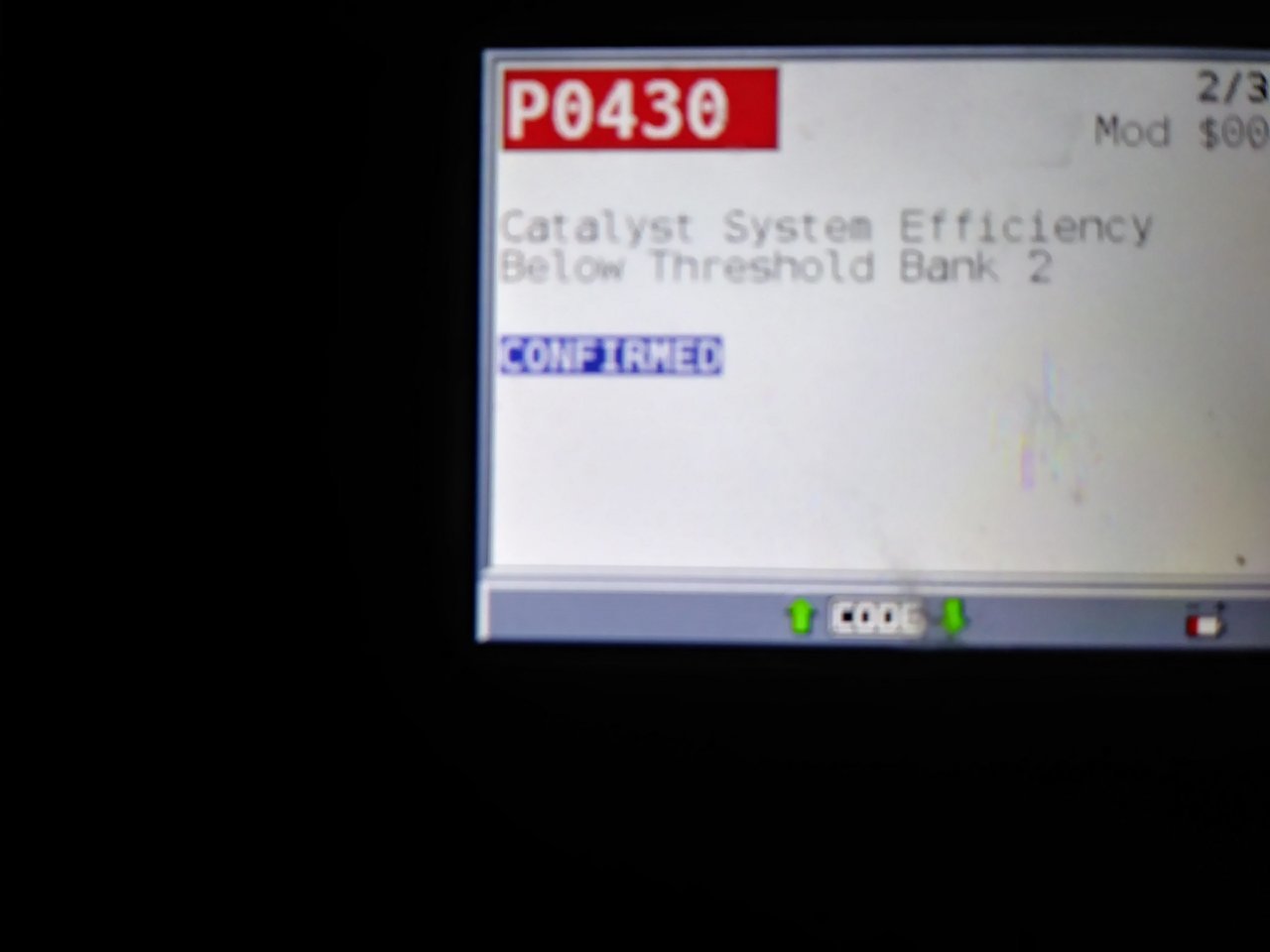

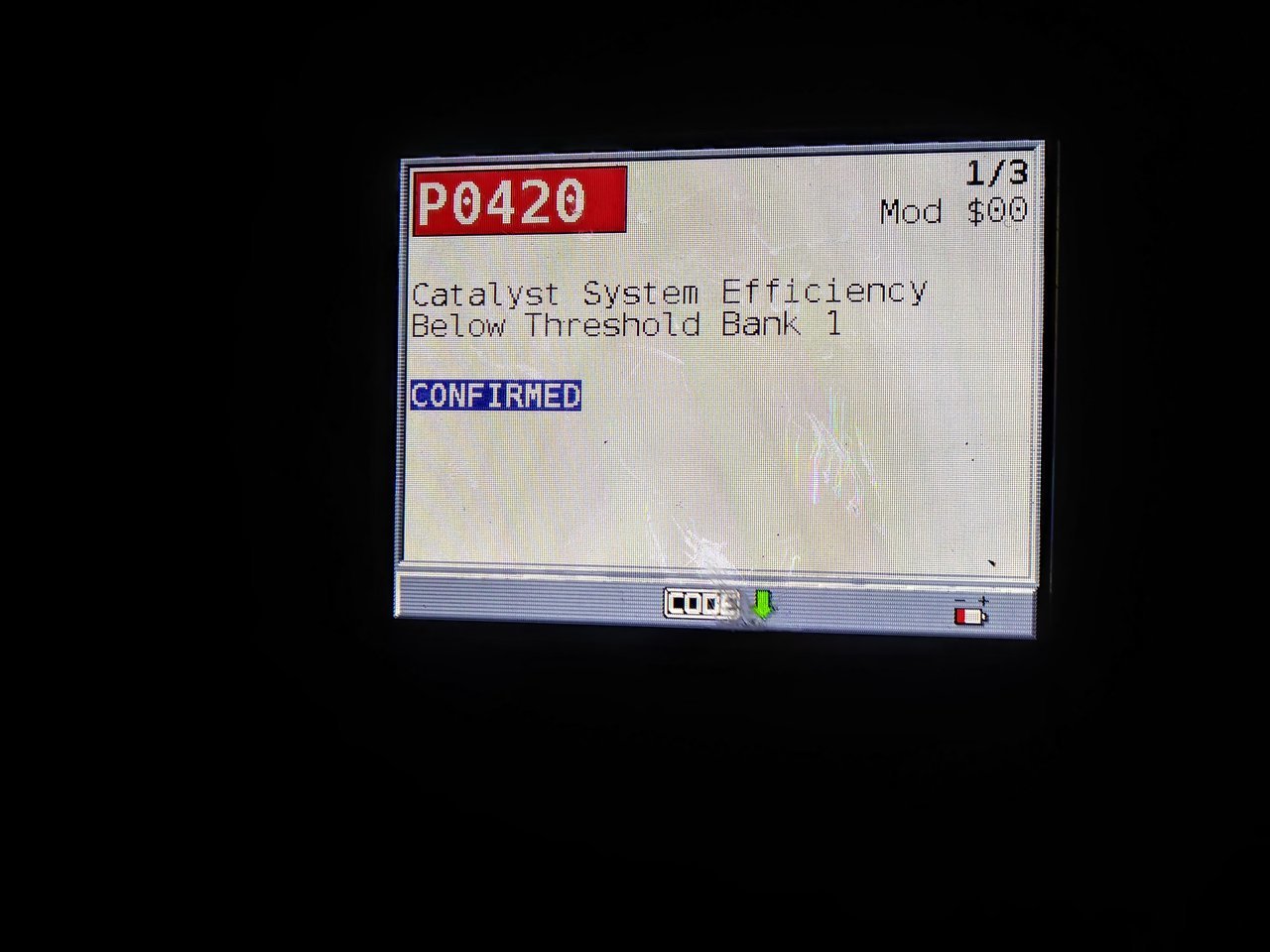

    Ok so after much research I found out that besides the ridiculous amout the dealership wants to charge you for this, there is only "1" company approved by the state to sell an aftermarket catalytic converter for my '06 Taco. Now tell me, what does a company have to do to get the entire state of California on LOCK? I don't know but I'm inclined to think that whatever it was.....it was worth everypenny. The only problem is....the part has not gotten the nod by the state yet...?!? My tags are due by mo months end...? My chk eng light is "ON"...what are my options? Pay double at the dealership or can I get an extension or something till they they get off their fat asses and make a decision? F#*K!

    I had the P0420 code. It turned out to be the donut gasket connecting the cat to the Y pipe.

    If in fact I.need a new cat then, yes. But, I don't want to have to be bent over by the dealership. I saw a post regarding a guy that had to replace his and they charged him $3,000.00! HELL NO!

    I hope that's all it is. Because the alternatives just don't fit into my budget at this time. Plus, 3G's on an '06 with 164,000 miles...? I'll would have to give that some more thought. I just put "CATACLEAN" in my tank last night. With don't know if it's just snake oil but I do know it cost me $25.00 at AutoZone! IT BETTER DO SOMETHING!!!!

    That stated, are you sure its the cat? Lots of other things can cause that issue.

    Well, I put in the Cataclean and had the code cleared. Sure enough, the light came back on after 40-50 miles. Whatever is causing the code...it's still a problem. When I spoke with the muffler shop they had been told that the fix would be approved by the state of Ca in 2 weeks. Great right? We'll see.......to be continued.....

    Did you ever look at the donut gaskets at the Y pipe?

    If your cat went out there is an underlying reason why. A cat converter will last a very very long time at 14.7 air fuel ratio. I highly suggest that you investigate your running condition before you go replacing the cat. It would be mini financial suicide not to do so. The last thing you want is to replace the cat without verifying proper running condition, otherwise the cat will fail again in short order.

    Take 30 minutes and get under your truck to check out your exhaust. If anything I would unbolt the exhaust before the muffler and check gaskets and such. I gutted my secondaries and got a check engine light cause the exhaust wasn't seated right at the flange before the secondary cat and o2 sensor.
    If it is your cats, get after those oem headers asap
