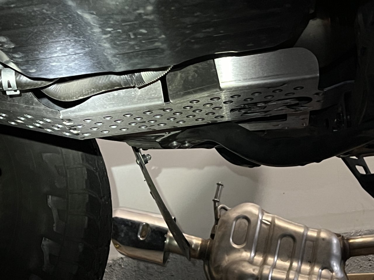

    I do not like how converter touches the shield. Seems like it should have been bent with a deeper cup. Give it at least a 1/4" clearance.

    I finally got mine on and they fit exactly like yours do. The cut-out has ~1/8”-3/16” of clearance from the rubber hose, but it does make contact with it if I push up on it a bit. I don’t think it will rub the hose under normal driving, but I could see it possibly wearing into the hose over time, especially if you spend a decent amount of time on dirt. I don’t think it would hurt to add even a little more clearance than the already updated design.
    My driver’s side shield also presses up against the cat like yours. I hope that won’t be a problem in the long run (wearing into the cat, or creating more heat, etc…). Thoughts @CaliRaisedLed ? I think making the whole thing about a 1/4” deeper would be better.
    I was wondering how hard it would be to bend these out of the way by hand if a thief really wanted to (since they aren’t bolted at the front), and honestly it would not be hard to do. Whether a thief would bother is the question tho, and I’m sure most thieves would move on to an easier target without trying. However, if they did give it a good yank while under there, they would realize pretty quickly that it can be bent out of the way at least enough to get a sawzall in there without a lot of trouble and then yank the cat out towards the rear. I think some spot welds connecting all the vertical bent tabs would add considerable strength and make bending them out of the way a lot more difficult.
    All in all, I think they are decent for the money, and will likely deter non-determined scumbags, but they could benefit from a few more tweaks IMO.

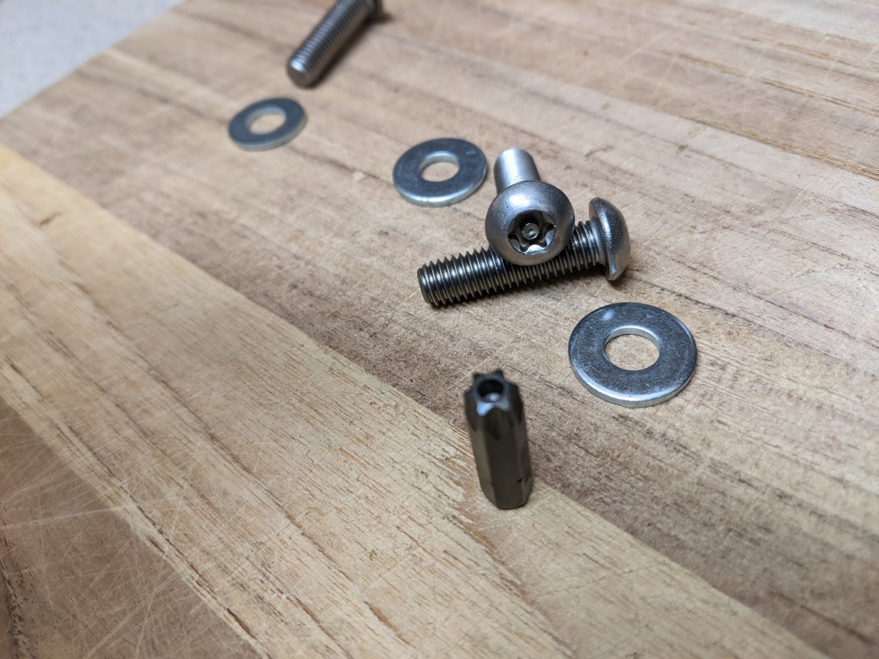

    I got mine and I'm very impressed with the build quality. They were easy to install my self and thanks TW for the torque specs. Wait time about 2-3 weeks (I forgot).
    I was worried about a rattle and decided to use 3M outdoor tape. I also decided to use my original bolts/washers. Didn't want to lose the security key and drill it out years from now. Wheel locks anyone?

    The “security key” is a standard bit that you could easily replace.

    Yes you are right. I had a bike rack (one up) and kept losing the damn key. Haha
    For others this is what I meant by security keys/bolts.
