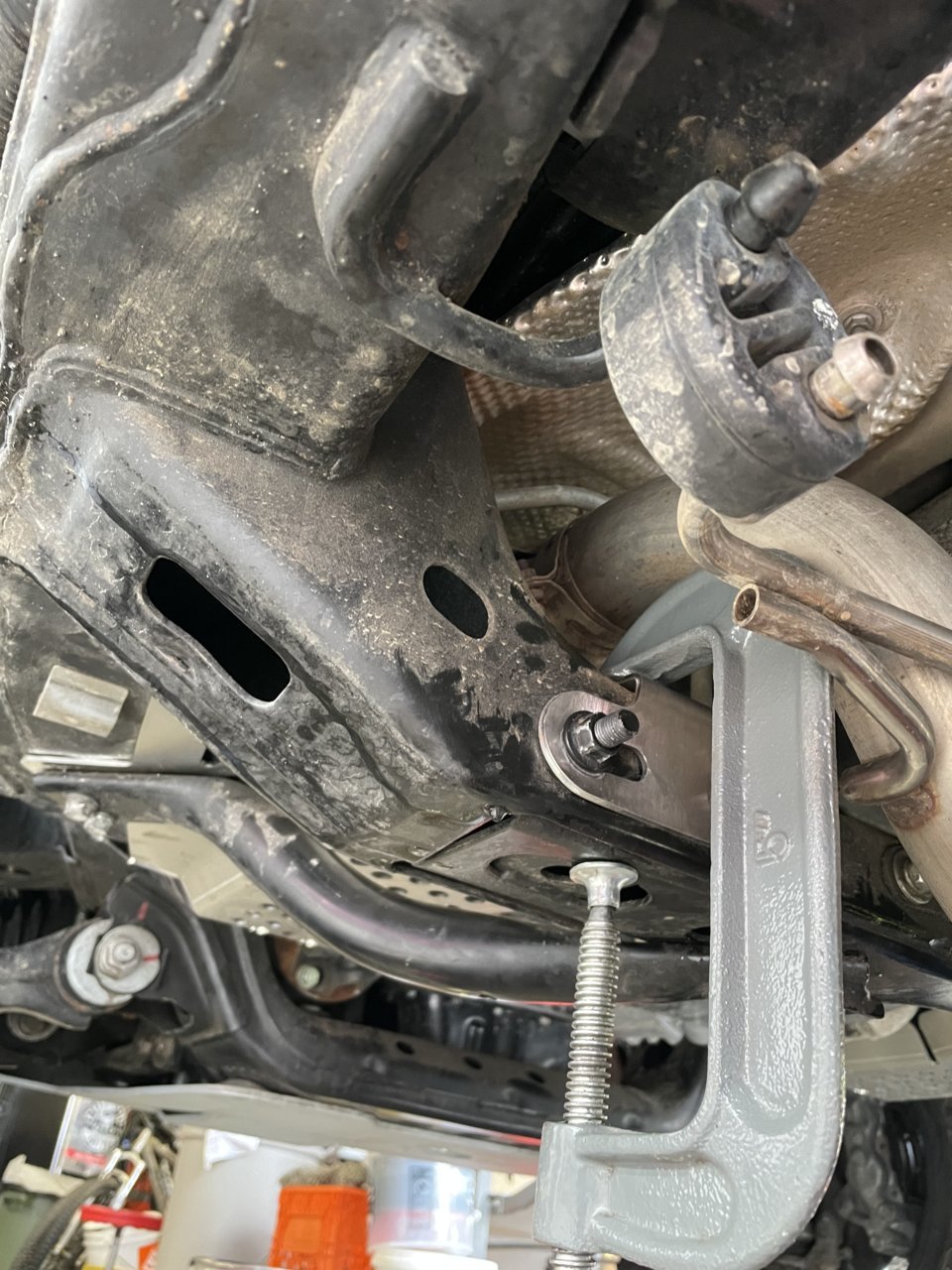

    I got my shields installed yesterday morning and as other mentioned about the drivers side making contact, mine was too.
    I fiddled with it a bit and thought I had enough clearance between the cat and the shield but when I backed the truck off my ramps I heard the exhaust rattle a little bit.
    I figured I would just live with the rattle but I woke up this morning and decided I would try to make a little more room between them. I ended up removing the shield and then put a little bit more of a bend at the back end of the shield where it goes over the crossmember. After installing it loosely in place, I put a c-clamp at the rear to keep it pulled down while I tightened things back together. Once the clamp is removed my gap closes up a bit, Going by eye it looks like I have 1/4” to start but go down to 1/8”.
    If I hear them rattle again I’ll grind the two holes for the crossmember bolts upwards so the shield will sink down a little closer to the crossmember.

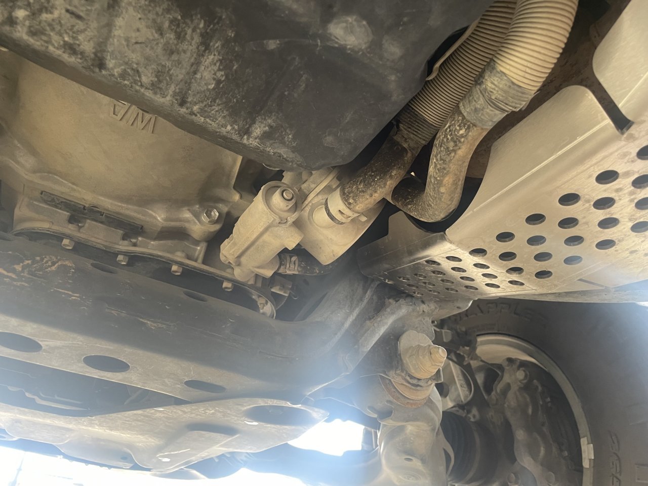

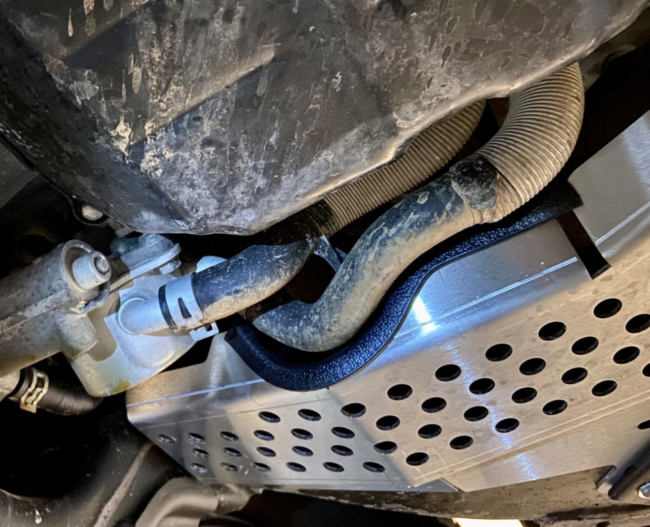

    Put some edge guard on there today. Maybe when it gets a little warmer and I have more ambition I’ll take it off, cut the opening larger. Technically it’s not touching but with enough big bumps I think it could. For now I feel a little better about things.

    Where did you get the edge guard and size?
    Im assuming @CaliRaisedLed is not providing edge guard for the buyers that got the first batch and ordered in November?

    regarding #2 coolant line (passenger side), will you all provide the rubber edge guard for customers that purchased the first batch in November? I even commented on your youtube install video when I noticed this possible problem the day before I ordered
