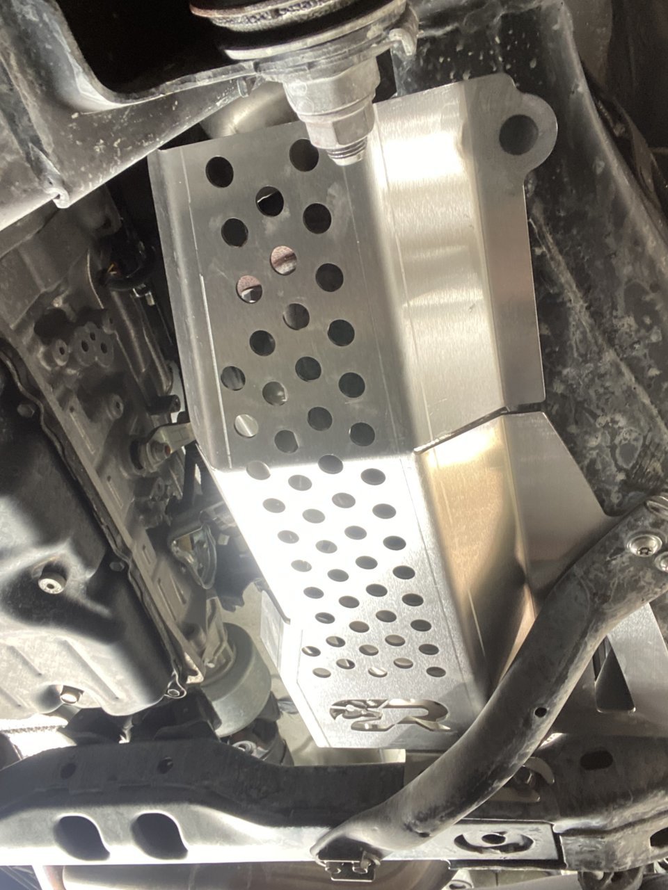

    Got them on took about 30 mins on the 2wd truck was not jacked up. No hoses or cats close to touching!! Perfect fit. Couldn't just push grommets in maybe if they were warm a small screw driver helped no issue though, passenger side went on perfect with socket and impact, drivers side I had to snake the front around the alignment bolt with the rear on the cross member bolts and pulling the front toward passenger side then up it’ll go. Couldn’t get the far most trans member bolt with a socket after installation I used two 14mm wrenches or vice grips would work. All good!! No edge guard needed. Thanks

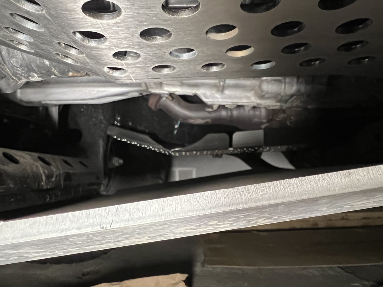

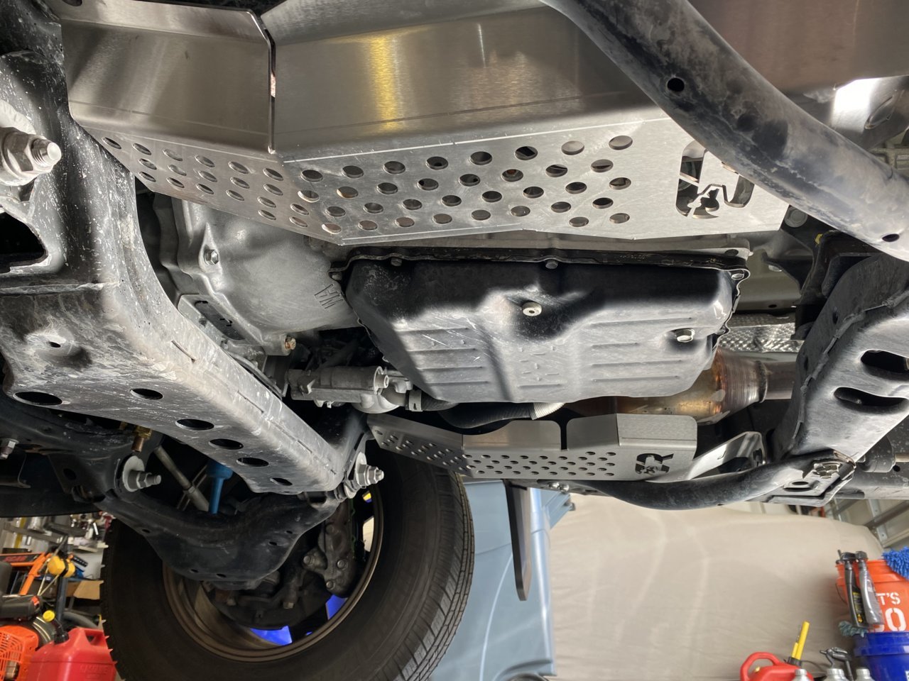

    Installation on a manual was pretty straight forward. Passenger side has a big gap that would make it possible to still get to the cat. I have a trans skid that help cover it, but would suggest that a different version be made for the manual trans. IMG_0830.jpg
