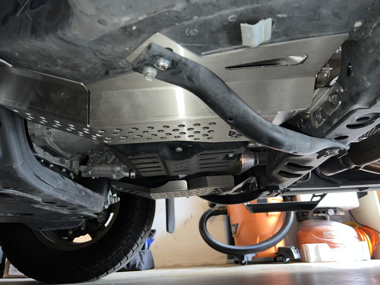

    So finally got my shields on. Installation was pretty easy. Anyone else’s shield bent when tightening the side to the frame?

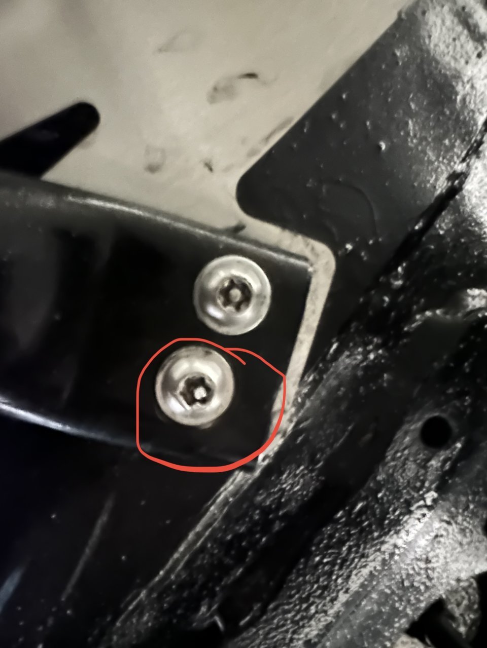

    I think I stripped one of the security bolts. Any tips? Might have to pick up some screw extractors

    jam a flat blade screwdriver into it. has worked for me in the past.
