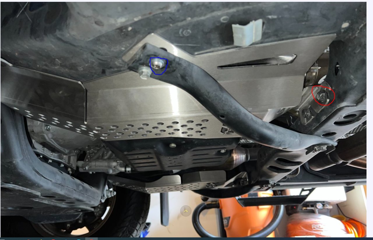

    Kind of pissed off right now. Snapped a bolt getting the brace reinstalled. The 35ft/lb figure for the braces floating around are incorrect. The wrong information is in a number of areas where the actual figure is 24ft/lbs. I really wish the main post included the torque figures and the installation kit included them well.
    Such a stupid problem that would be resolved if the torque figures were listed here. Worse that the wrong figure is higher than lower. Glad I didn't strip out the nut in the frame and instead the bolt snapped.
    TRDRed and CenCal805 like this.

    Yeah, I made the mistake of using a torque wrench to tighten and now one of my security bolts are stripped and one of the bolts that secures to the brace snapped today when I was trying to remove it. I suggest anyone planning to install is to tighten it and then 1/4 turn.

    I'm sorry that happened, but thanks for coming on here to help the rest of us that have yet to install. Are you saying that you stripped the bolt or nut that is below circled in red?
    Thanks for getting us the right torque specs, sorry you were mislead and are saving the rest of us this headache. Just so I'm clear the the bolt below circled in red should be 24ft/lb? Do we know the correct specs for the bolt circled in blue?

    No, I stripped the security bolt circled in blue and one of the bolts on the other end of the brace snapped.

    Nah, the right spec of 24ft/lbs was right on the money. That 35ft/lbs was causing the bolts to shear. You can find on a few past pages where some were saying don't go over 30 on the torx bolds cause they were breaking. This was just caused by a bad figure floating around that was breaking bolt factory and security torx screws lol.
