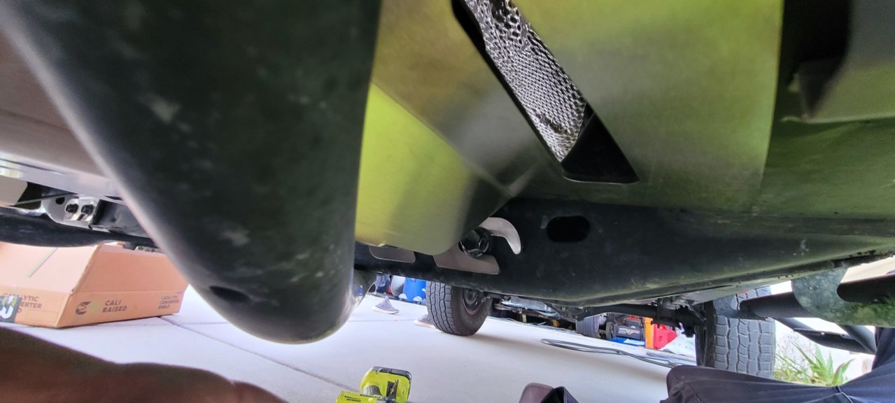

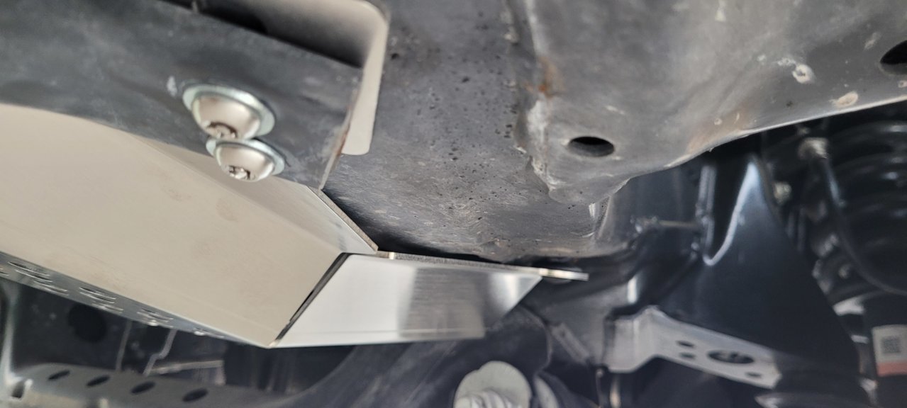

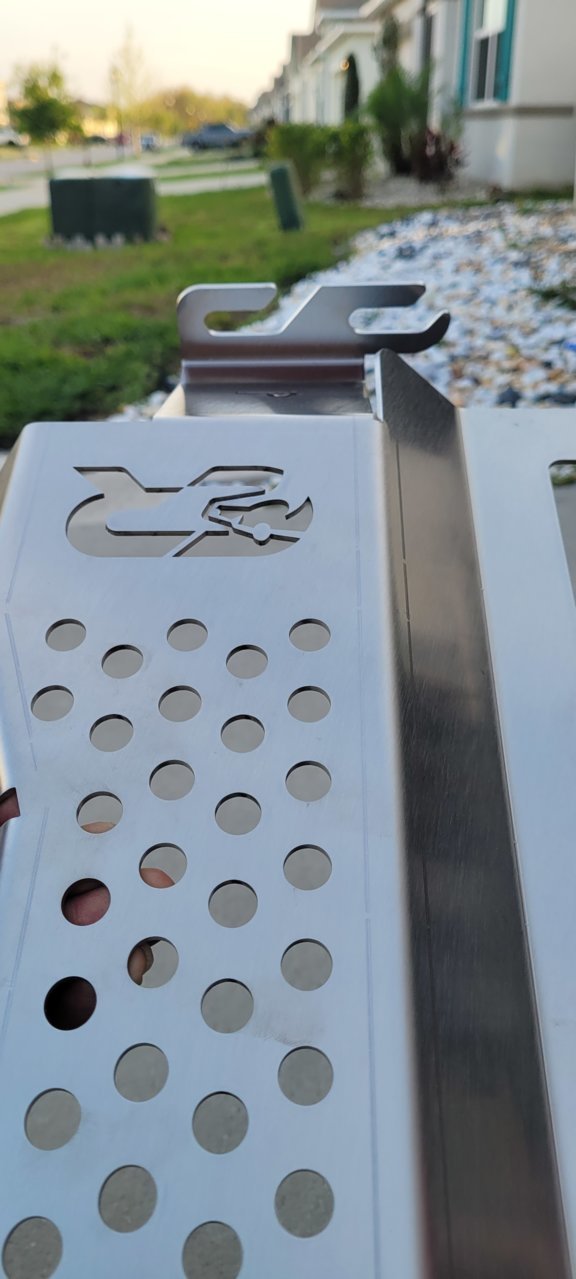

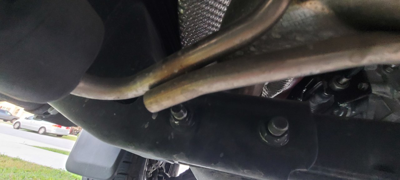

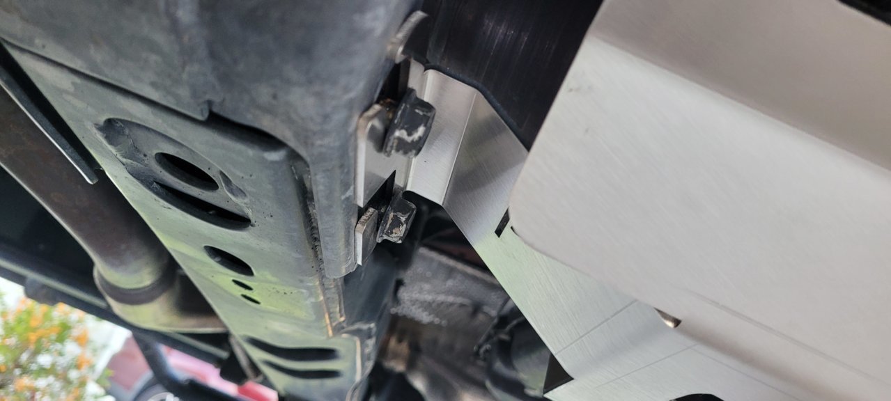

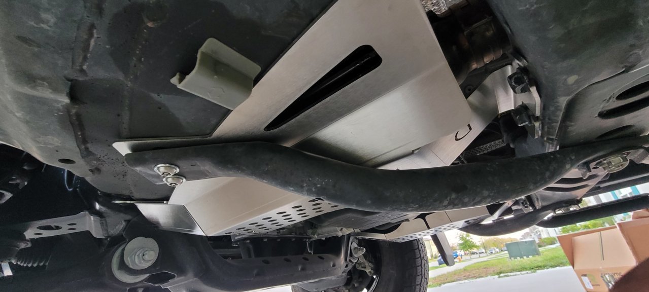

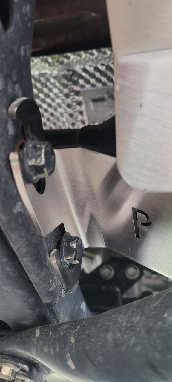

    Im assuming this is the new design for 4wd. Poster says they have a TRD Pro, does that come in 2wd?
    At any rate, I see no need to go over the cross member to mount it, like mine does. It only saves someone from pulling the crossmember bolts out. This other design can go around the bolts so you dont need to pull them out. Had to make it idiot proof.

    You don't need to pull the bolts out for the ones that go over the cross member.

    Yeah I know I put it on. What Im saying is I dont see why you need to go over the cross member on the 4wd version. If you made it mount to the front side it would be much easier to install, except that you would have to pull the bolts out to mount it. But I can see on this other version they have cut out the bolt holes so you dont even have to do that, just hook it onto the bolts.

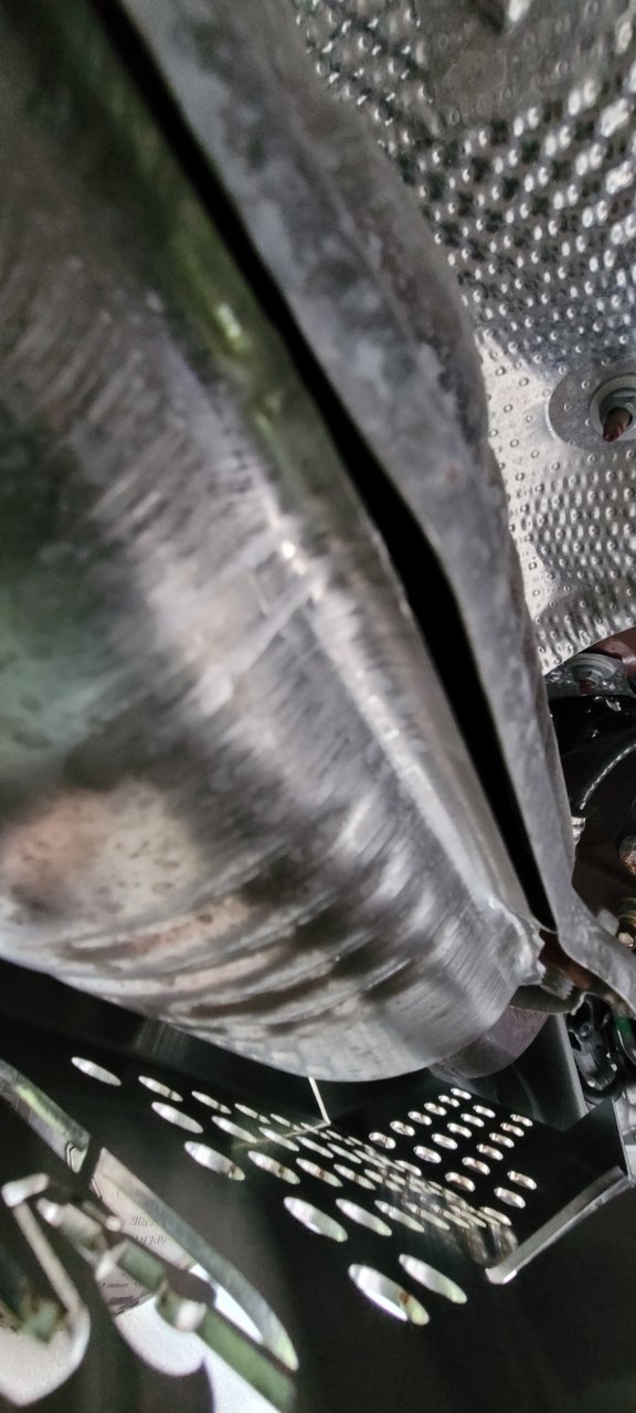

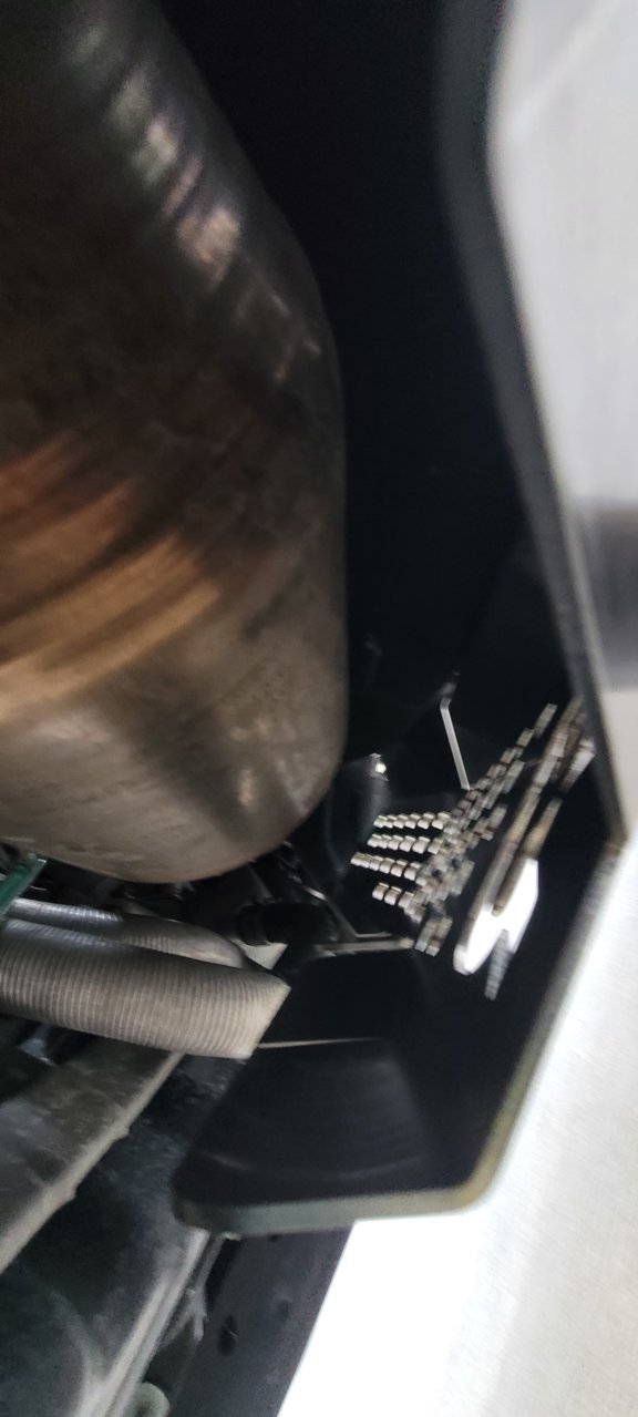

    Received mine after roughly 6 weeks. Before I installed I added some foam tape because I was afraid of rattles toward the front where they use the rubber spacer, I also added it where it would make contact with other metal parts. The install was easy but noticed like others the drivers side touches the cat. I did hear a slight rattle so I added washers but it made it worse.. truck is 2020 TRD OR, tomorrow I’ll have to call and see what can be done. Just by looking at it I feel they didn’t bend enough to compensate for the Cat.

    Just installed mine today on my '21 Off-Road. did the passenger side first and it was a breeze. The driver's side did take some elbow grease and it does touch the cat after installed. I noticed a little more noise in the cabin; likely on account of those exhaust vibrations are now in contact with the rest of the truck. It's not horrible and mostly noticeable only while at idle. I like that these are there, though. It is some peace of mind.

    Haven't installed mine yet, but that has been my thought... that they didn't bend it or contour it enough to clear the cat. Apparently the truck they tested it on didn't rattle, but there are too many at this point that do. Was hoping that they did a redesign and made it protrude a bit more to clear it. Hearing that extra washers made your worse is not good news!

    It could very well be I didn’t use enough washers. But the fact we are all having to do something is a bit frustrating.
