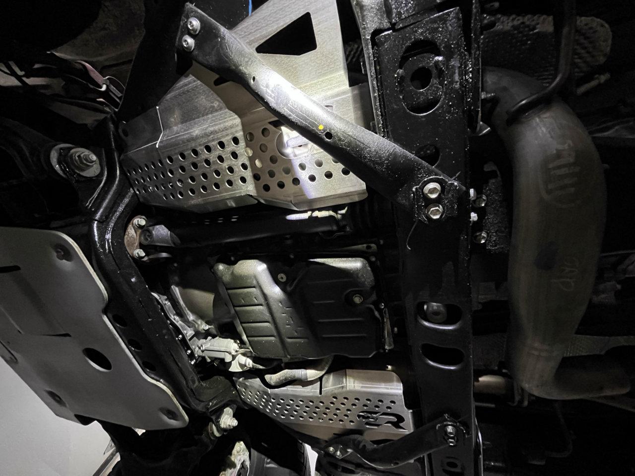

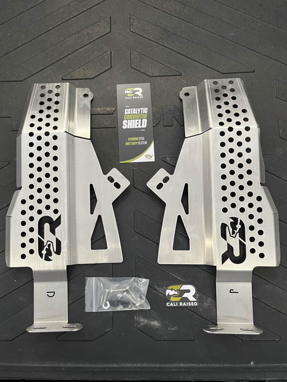

    They arrived today and I installed them. The install went smoothly without any issues. I was even able to install the Riverside without removing the bracket.
    The driverside definitely touches the Cat. There isn't a vibration heard while moving forward, however, while backing up into the driveway there's most definitely an obnoxious vibration coming from the shield. This just isn't acceptable to me and I'm very disappointed. There is plenty of room to bend the shield so it's not touching the Cat. I'm really hoping for a correction/direction from @CaliRaisedLed. I have not installed any additional washers to try and alleviate the noise as of yet.
    That said, they do look great installed and will hopefully deter and would be thieves.

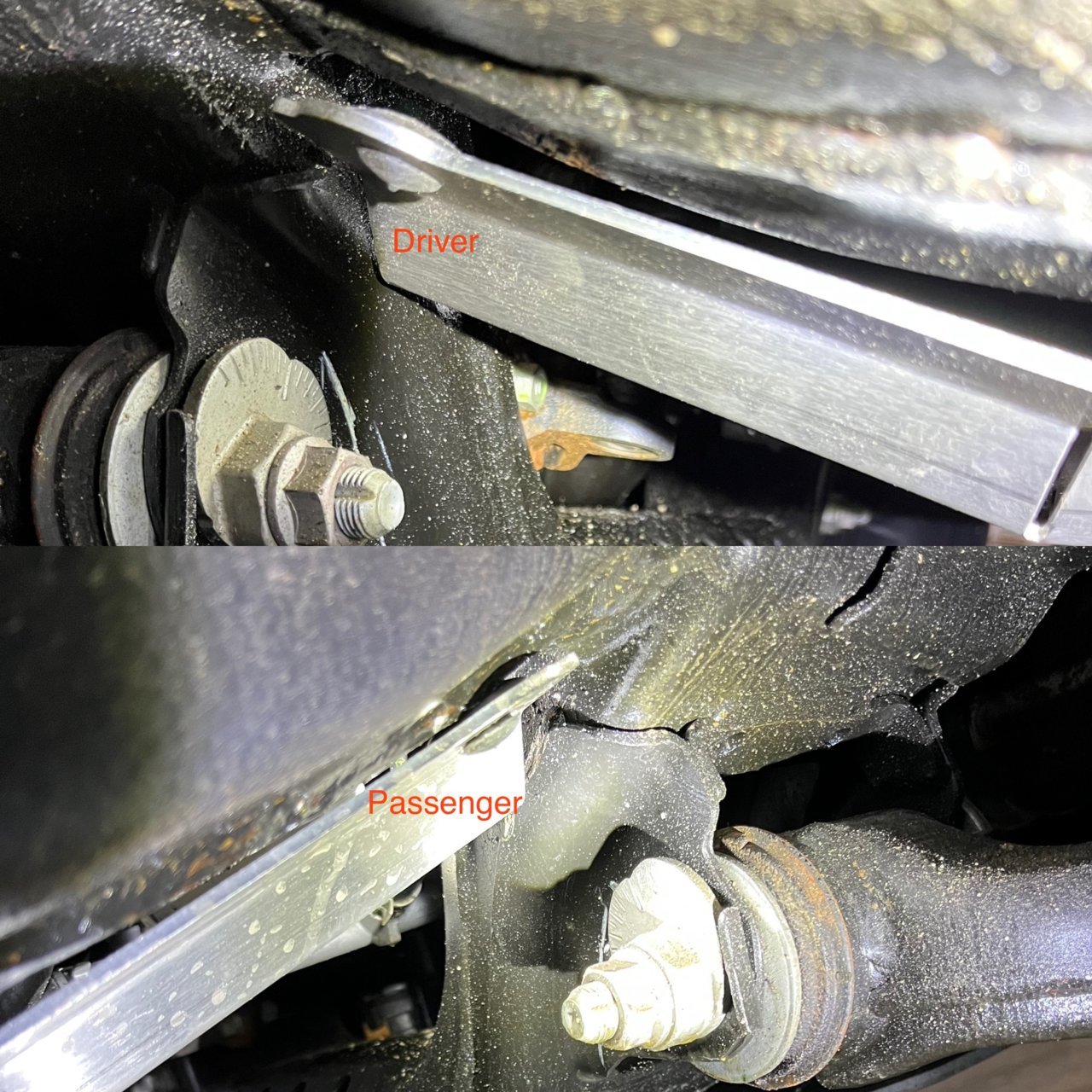

    1/4" stack of washers made it worse. I'm removing the driver side shield and waiting to hear back from CaliraisedLeds engineering troubleshooting department that I was directed to immediately by CS.
    The vibration noise happens initially when driving forward, in reverse, in reverse with wheel turned or not turned. It's too annoying for me, especially on a brand new truck.

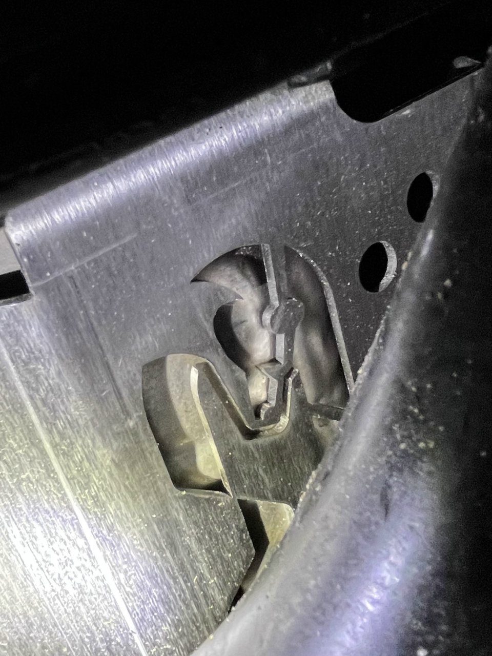

    Question, is the only part of the shield touching the cat the Caliraised emblem section? I was wondering if cutting that section out would be a solution. I know it would create a big open spot and not look good, but it's under the truck.

    I can't really tell if the shield is touching other parts of the cat since it's too tight to get a look at it. I just went by feel and the fact that it's clearly touching where the logo is cut out. Hadn't thought about cutting out that area further. I do have a sawzall but other than cutting the random pipe I'm not proficient with it. Might be worth a try I suppose.

    Can anyone without a rattle take a look and see if the Driver side grommet is touching or not touching? After many different configurations with washers, aluminum plate spacer, tightening certain bolts first, etc..., it seems like the issue has more to do with the shield not being secure/solid in place. If you look at my passenger side, the grommet is touching and the shield is solid and doesn't move. My driver side, the grommet isn't touching, and there shield has room to move and vibrate at the grommet area.

    My rubber grommets didn’t make contact with the frame on either side, and the gap got worse on the driver’s side after adding washers (the shield was pressing against my cat without them). I didn’t even drive it with those gaps though, because I could get the shields to rattle by pounding my hand on the frame not even very hard. So I got some rubber feet for like DVD players, etc… and i stuck a couple on the frame (with a dab of superglue) to make contact with the grommets. No rattles.
