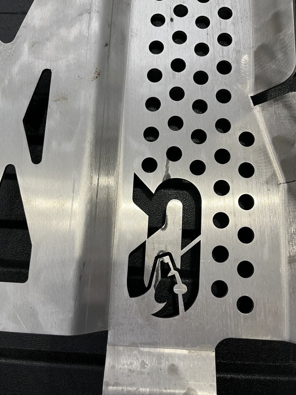

    MTBTACORN
    MTBTACORN Well-Known Member
    Mar 17, 2011
    #53212
    447
    Ontario, Canada
    23 Tacoma TRD Pro 21 Sportster S
    Thank you for confirming your grommet is touching on both sides. I feel that it needs to in order to create stability and eliminate any shield movement/vibration.
    Really glad to hear you’re having success with your shields. Here’s a pic of my shield showing where it was rubbing the cat. The shield was only on for about 40km or so.

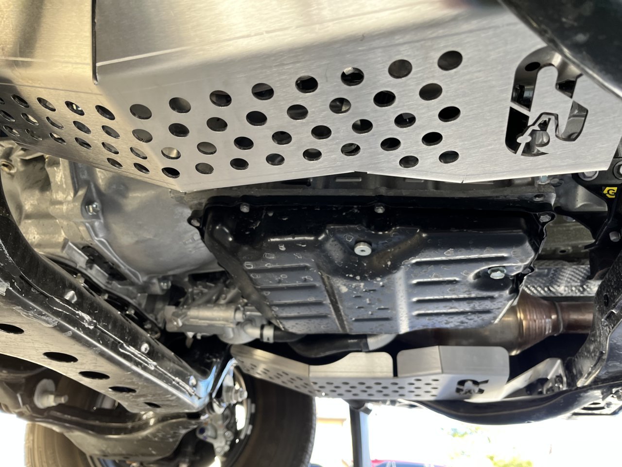

    TRDRed
    TRDRed Well-Known Member
    Jan 8, 2023
    #415070
    1,198
    Pacific Northwest Playground
    2020 TRD OR DC SB OTT Tune
    Nice! :thumbsup: Looks like it clears the cat on the passenger side by a LOT. Doesn't look like it, but I can't tell for sure, but does it touch the cat on the driver's side?

    iScramble Well-Known Member
    Jan 23, 2023
    #416144
    46
    2023 Silver Tacoma SR5 SX
    Plenty of clearance on the driver side, no rattle whatsoever. It’s the 2WD version so no known issues with touching with it. It’s the 4WD version have been reports of touching.
