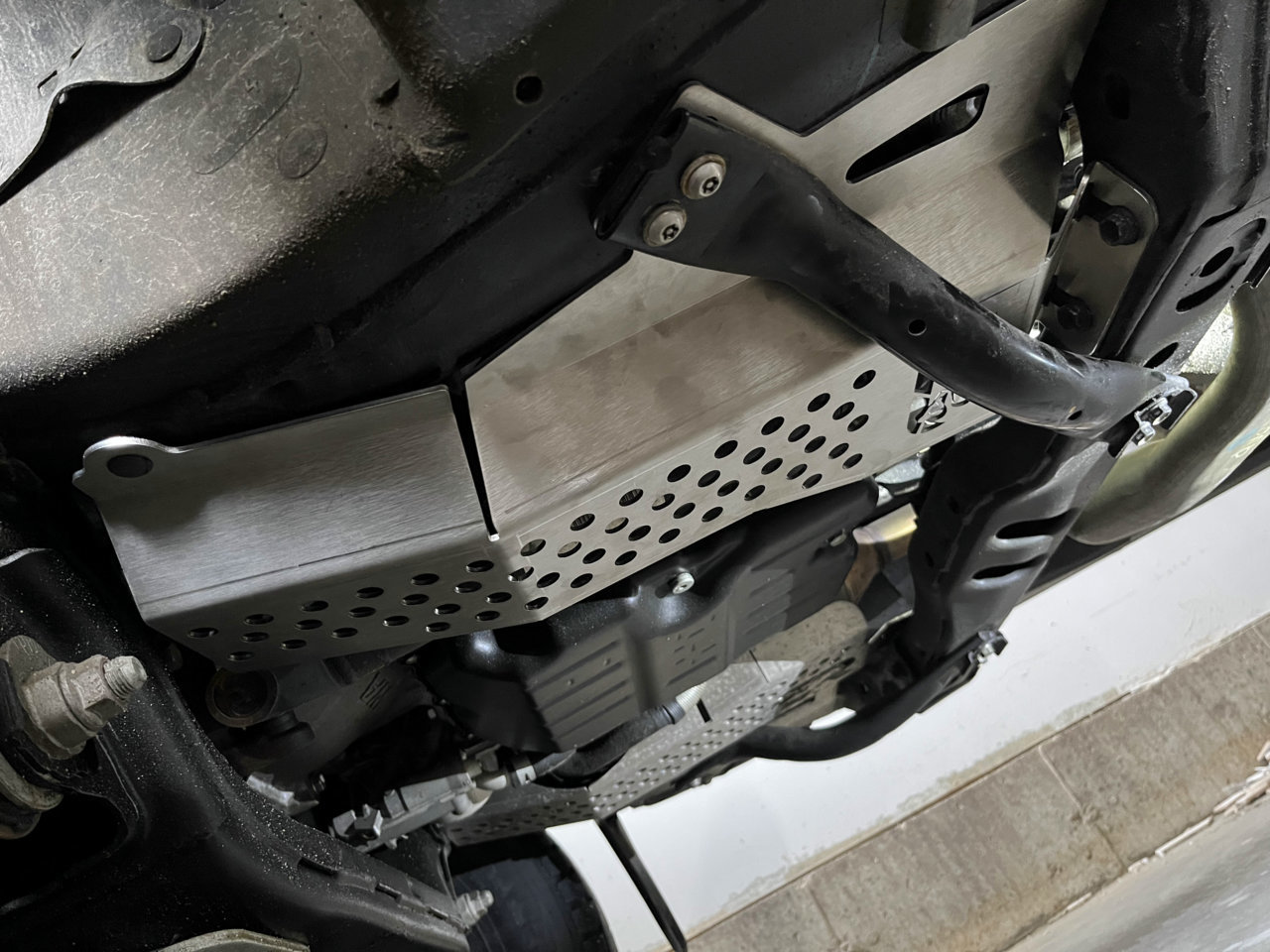

    IMG_8797.jpg I attempted to install the driver’ s side today no luck. I even remove the spacers no luck. Cali stated they had an issue with these so if you want to tried that second video without the spacers good luck. I reached out again to their engineer department. Hopefully they have a fix for it. So the options are tried the new video installation without the spacers or or they can send you out a shield that has the corrected bends. I went with option two. Reason I attempted to install without the spacers and still was not able to get a proper alignment. I re-install the older model just to keep a peace of mind. Note* removing the second bolt is not as easy as the video shows. Even with all the trouble after two hours I had all the original components back again. Will keep you posted if I receive the driver’s side with the new bends.

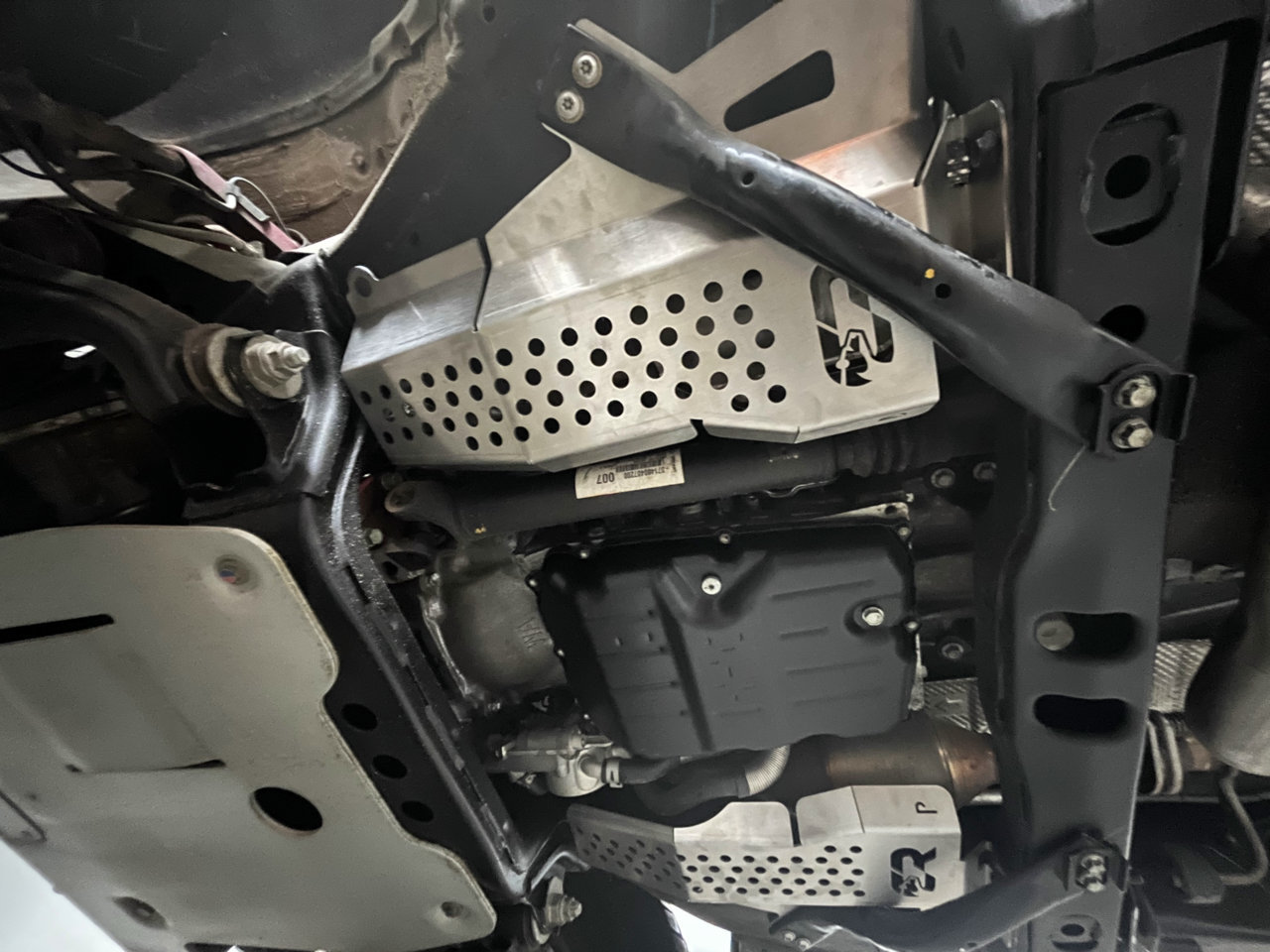

    Just installed the V2 with the original crossmember bolts as directed. Everything lined up and the install took 20min. I would suggest pushing the crossmember bolts all the way towards the front in order to have everything line up nicely. Then just follow the install in the video.
    Took the truck for a short test drive and no rattles were heard. I'm very happy with the shields and @CaliRaisedLed and Chris in engineering for all the assistance they have given me to finally have my cats protected. They have done an outstanding job.

    Are those the supplied longer bolts on the transmission support bracket?

    OEM bolts.

    Have enough threads left on the nut side?

    Lots of thread left. You're not adding the spacer and the OEM bolts have a flange to them so no washer needed either.

    So far Cali Raised has not requested us to return the V1, I had an issue with the driver's side on the V2's alignment. Cali Raised indicated that there was an issue with some of them. Moving forward they called me today and told me to expect the new V2 driver's side sometime this week. This one should come with all the bends.

    So, you decided not to use the new hardware and kept everything OEM. I tried that route but still the driver's side would not align. After reaching out to Cali Raised they told me over the phone that they had some issues with the first ones they send out and to expect the corrected one sometime this week. Thanks for your input.
