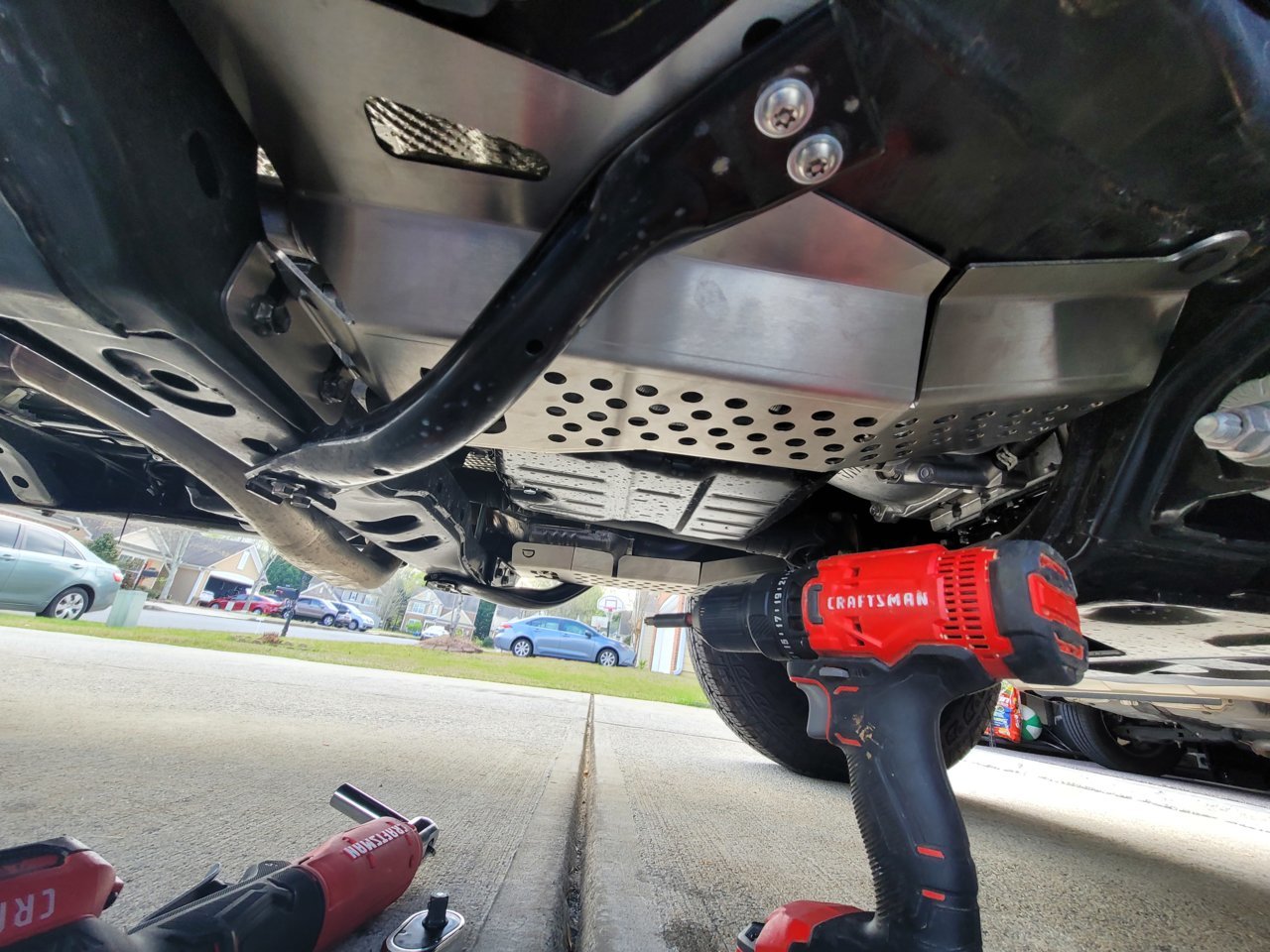

    I had my crossmember bolts all the way forward with the nuts right on the ends. They were sticking out a good half inch or so. If you don't pull these forward enough the wing tabs have trouble aligning. After that, I followed the exact same bolting procedure as the video.

    Took mine back off cause of the rattling. Reached out to Cali and they sent me a link to fill out a form. Wanted pictures for proof of shields. Mine were bought back in late December. Will see how it goes.

    I bought mine in the same timeframe as you. They swapped mine a week ago with absolutely no problems at all.

    I got one of the first new units that has the missing bends but with the updates instructions I was able to get them mounted and so far seem to have no issues.

    Good job! No rattles, nothing’s touching the cat?

    Nothing touching and no rattle I've noticed yet.

    SKILLZ!!! Nice work

    Did you install those without lifting the truck up off the ground ?

    Interesting, looks like the same metal lengths, just not the fully completed bend. Good ole hammer trick may solve that one lol.

    Hopefully by Monday I will let you know how smoothly it went. With Easter tomorrow only option is to work on it Monday morning. Also with the new ones they are not sending the hardware other than the security bolts which makes sense to me.
