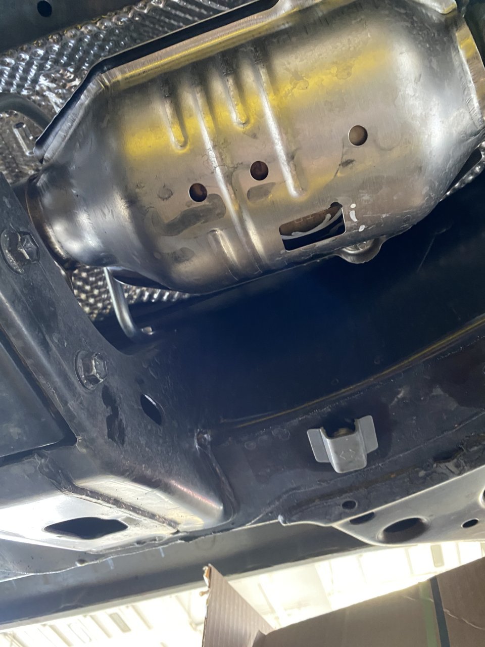

    How about a pic of the other side? Curious if they come up further to protect the Cat more.

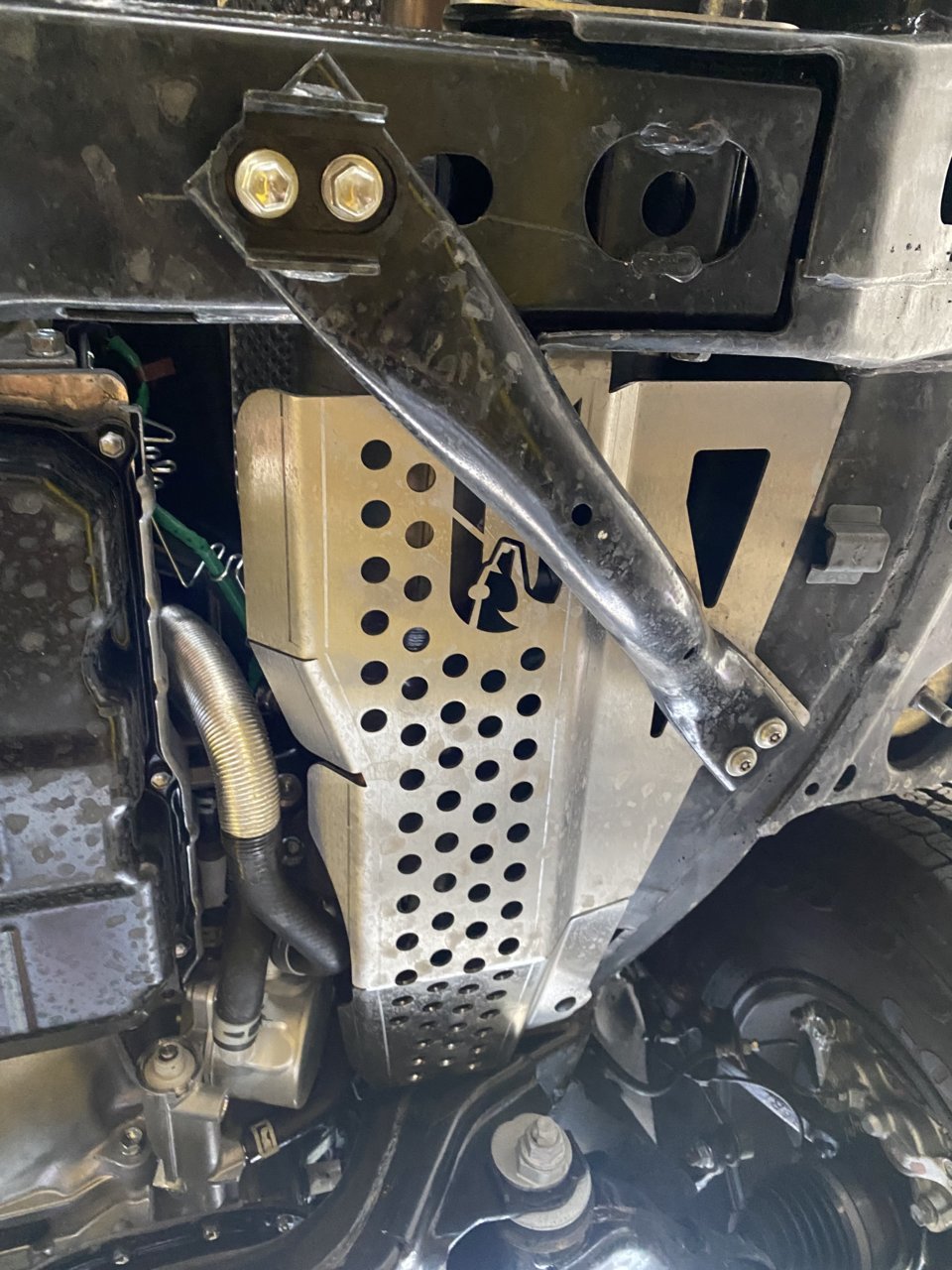

    Installed the gen 2 today, shown with RCI tranny skid plate. I was running the RCI shields, but they didn't cover the cats as much as I'd like mounted to my older version of the skid plate. The driver's side didn't align quite right, so I had to screw the security screws in first, then floor jack the rear, inboard corner up, and tighten the cross member bolts while jacked. I do wish an adapter plate was included for folks not running the support bars. The included washers were too small for the opening, and larger washers would be too big and would overlap. May have to find large washers and grind a side down to fit.

    The only difference that I noticed is the bend where I circle it. Everything else is the same.

    Thanks. The pic was deceiving with the angle of the shields.

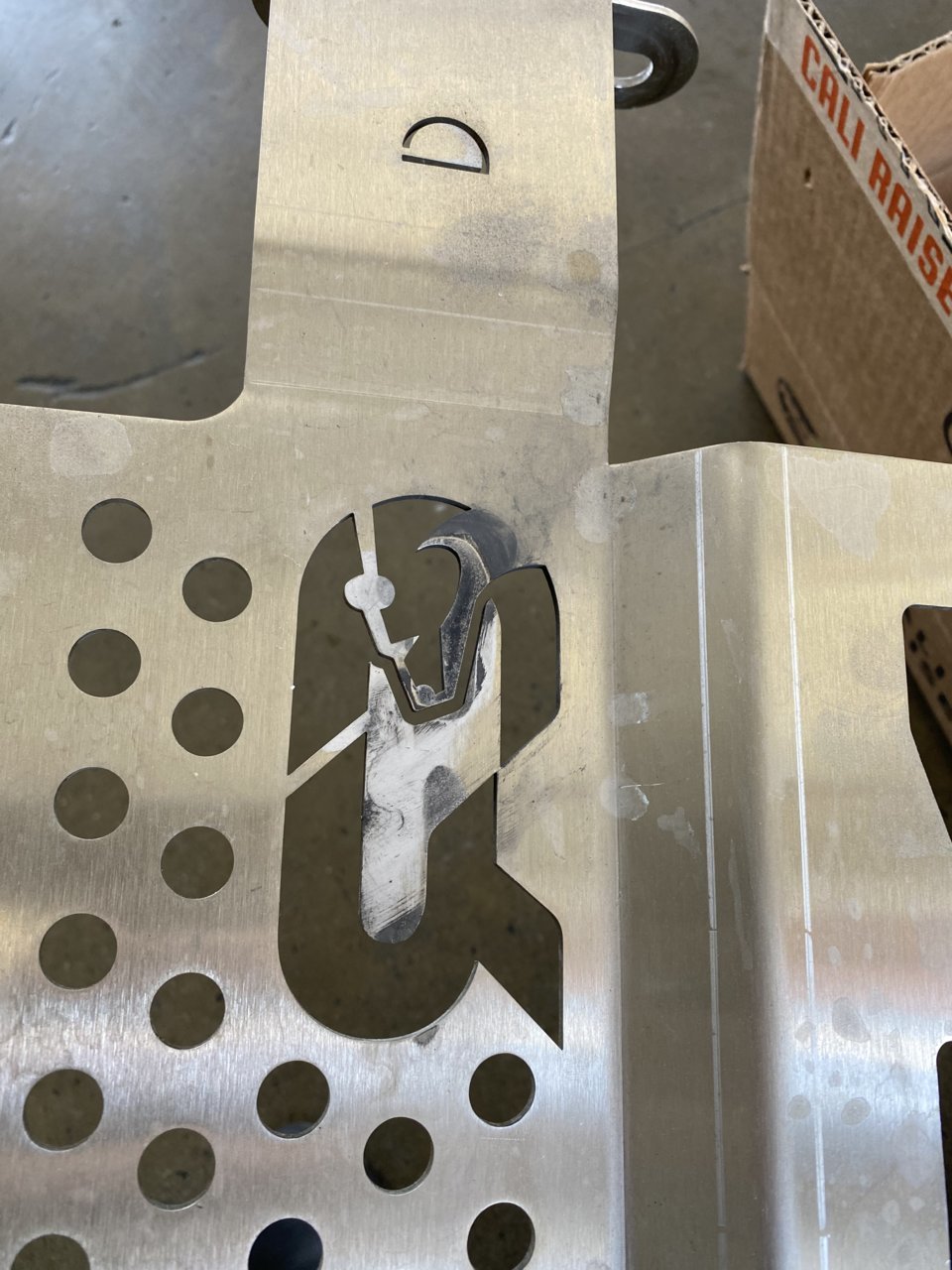

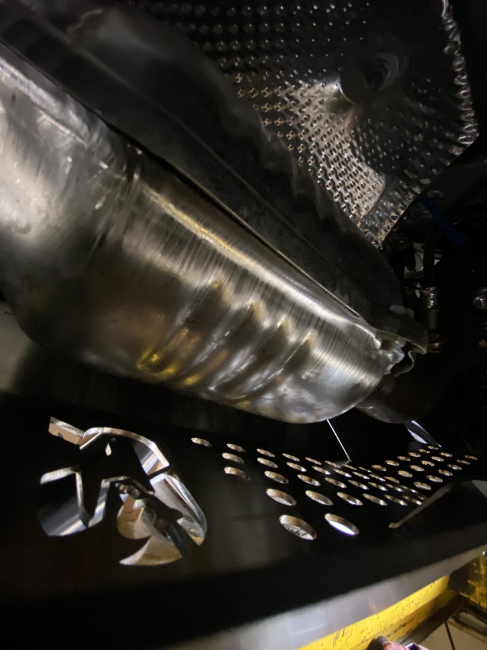

    I received our v2 (v2.1?) catalytic converter replacement shields yesterday and put the driver's side on this morning. Decided to just do the driver's side since the v1 passenger side wasn't causing any problems (no rattles and clears the catalytic converter). All went fine. I followed @CaliRaisedLed Chris' updated DIY video and although a tiny bit fiddly to get it all lined up, everything worked out great. Completed it all while it was flat on the garage floor.
    The latest version clears the catalytic converter completely - plenty of room to circulate the air around it and there are no rattles or issues that I can see or hear.
    For me, and based on Chris' video, the key with the v2 was to install the end that attaches to the transmission mount bolts loosely and do the same with the crossbar security bolts, then tighten up the security bolts, then the transmission crossmember bolts, then the inner two crossbar bolts. Once everything was snugged down it was good to go.
    Like @dietcokefiend, I opted to use the OEM transmission cross member bolts rather than the new ones with washers since the OEM bolts already have collars.
    I did have a big "ah, son of a... gun" moment after I thought that I was all done. I forgot to install the little rubber bumper at the end of the shield that snugs up against the frame. :annoyed: So I loosened everything up (didn't remove anything) and managed to squeeze the bumper in-between the shield and the frame and with the help of a little flat blade screwdriver, it popped into place. Phew! Tightened it all up again and, done!
    In the end the new version not only fits better, but is easier to install.
    So many thanks to all the folks at Caliraisedled for the excellent customer service and standing solidly behind their product. At this point I can highly recommend them! :thumbsup:

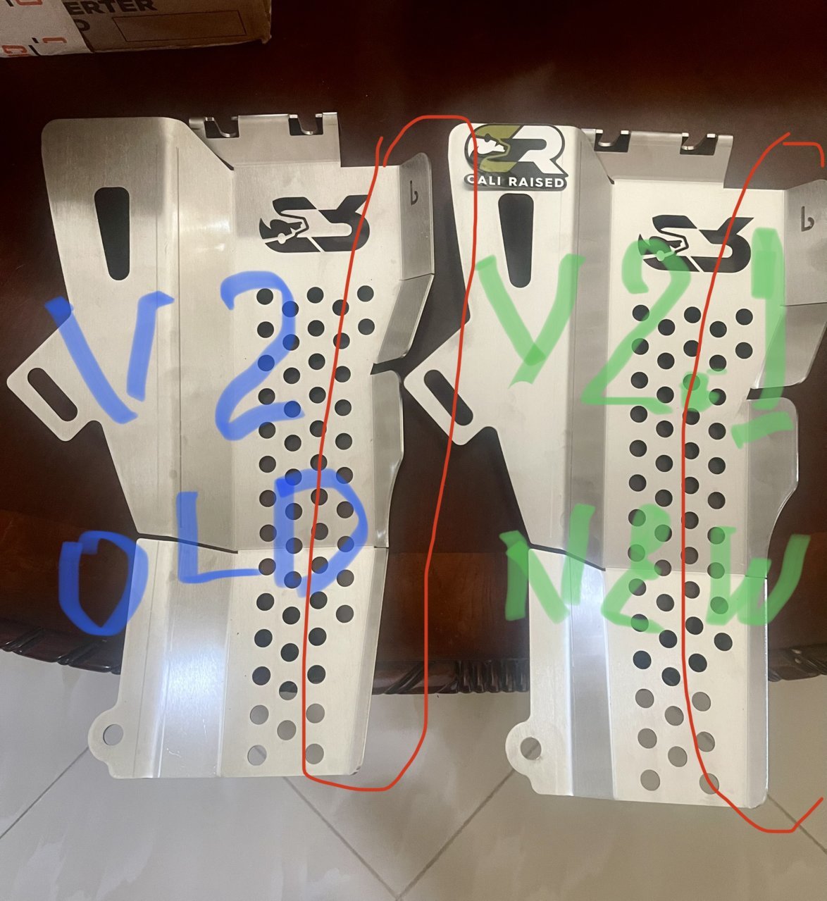

    IMG_8830.jpg I don’t think this one will helped, but like I noted on the first one the only difference is on the bend when placed one on top of the other there is a 3/16” difference. Everything else looks the same.

    Might still be the pic but looks like V2.1 has a higher upsweep in the red circles portion.
