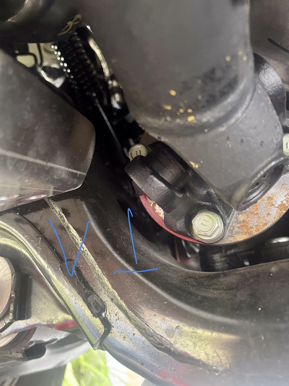

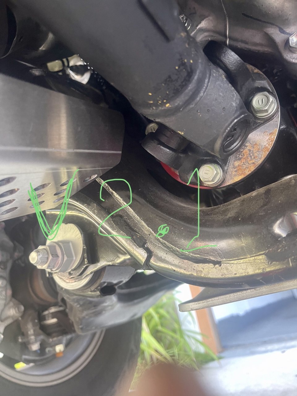

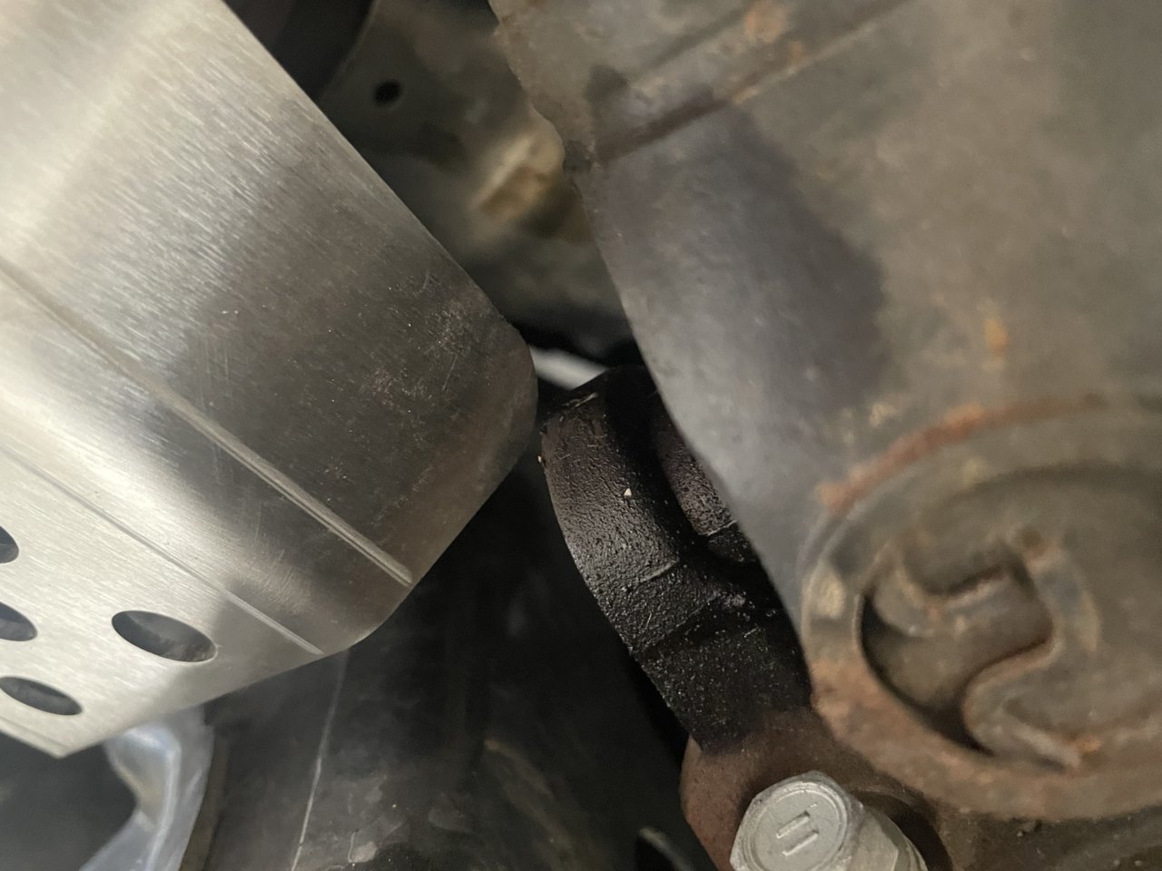

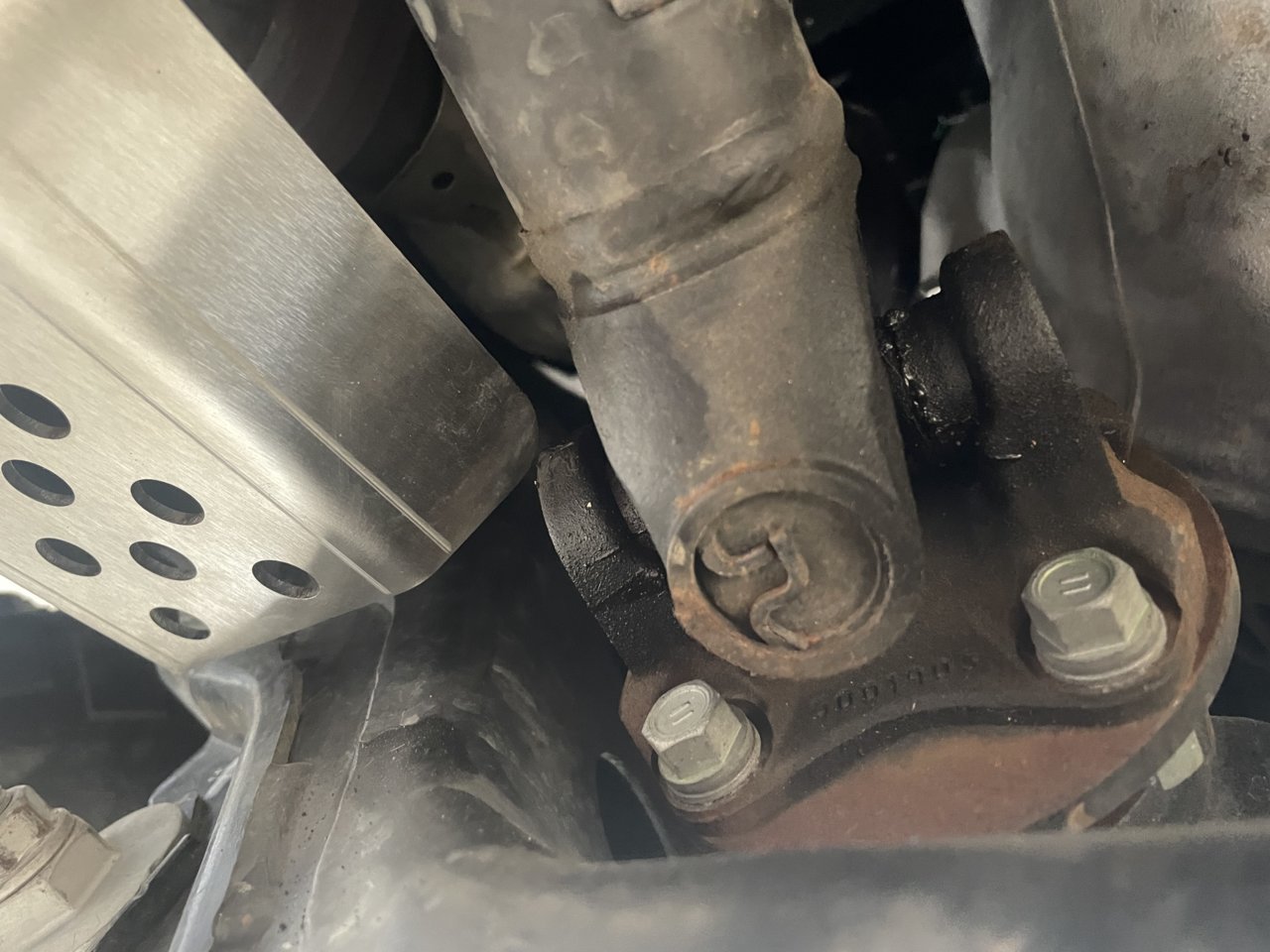

    Looks like mine have more space. Pics are from the same place just at different times and different camera orientations. Shields are V2s (not V2.1) with OEM crossmember bolts.
    I'm good with mine but I'd be concerned with @CenCal805

    Sorry, I should have added more info to my post. I'll edit it but these are V2s (Not V2.1) with OEM crossmember bolts

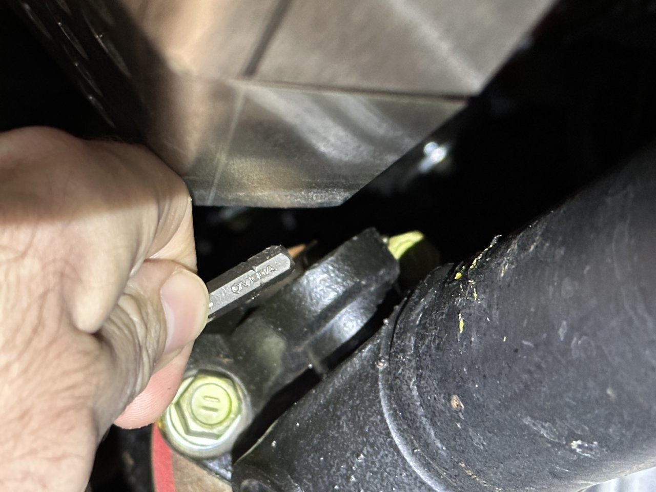

    Just went to check my v2 plate. Got that torx bit there for reference. Right around 1/4 of space in that gap. If one was offroading, how much movement can the transfer case get? That isn't exactly unheard of with rubber mounts.
    While one would expect perfect fit and finish, technically this fix is chopping off a corner, instead of trying to hammer in v1 levels of clearance. If a V2.2 version were to float around I wouldn't be surprised to see a shorter wing right there.

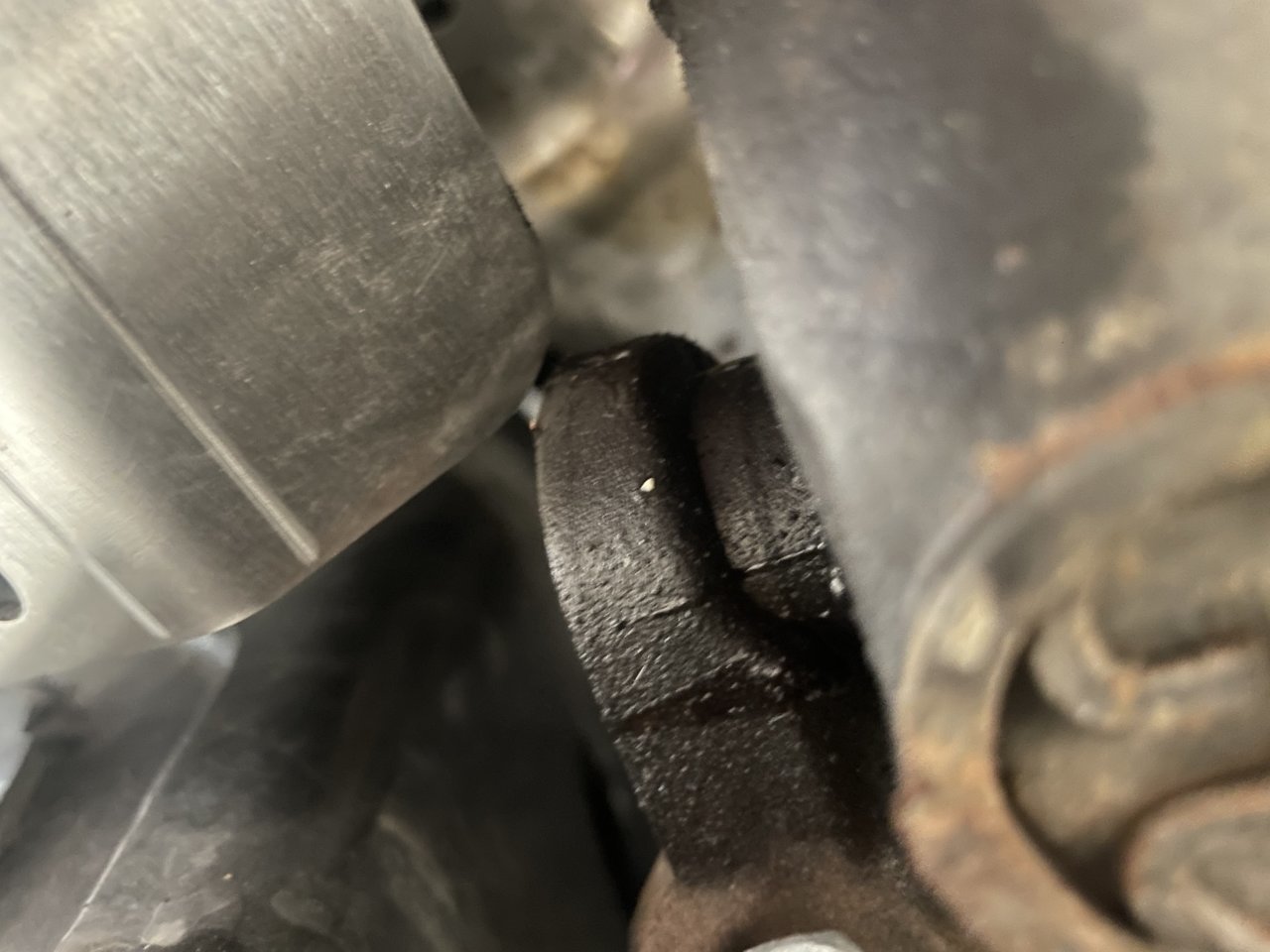

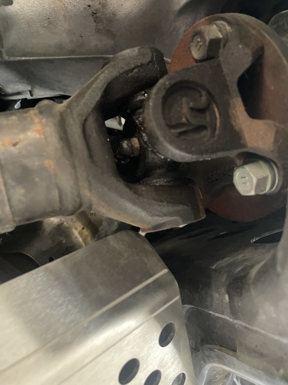

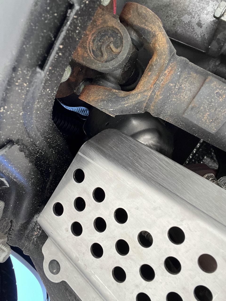

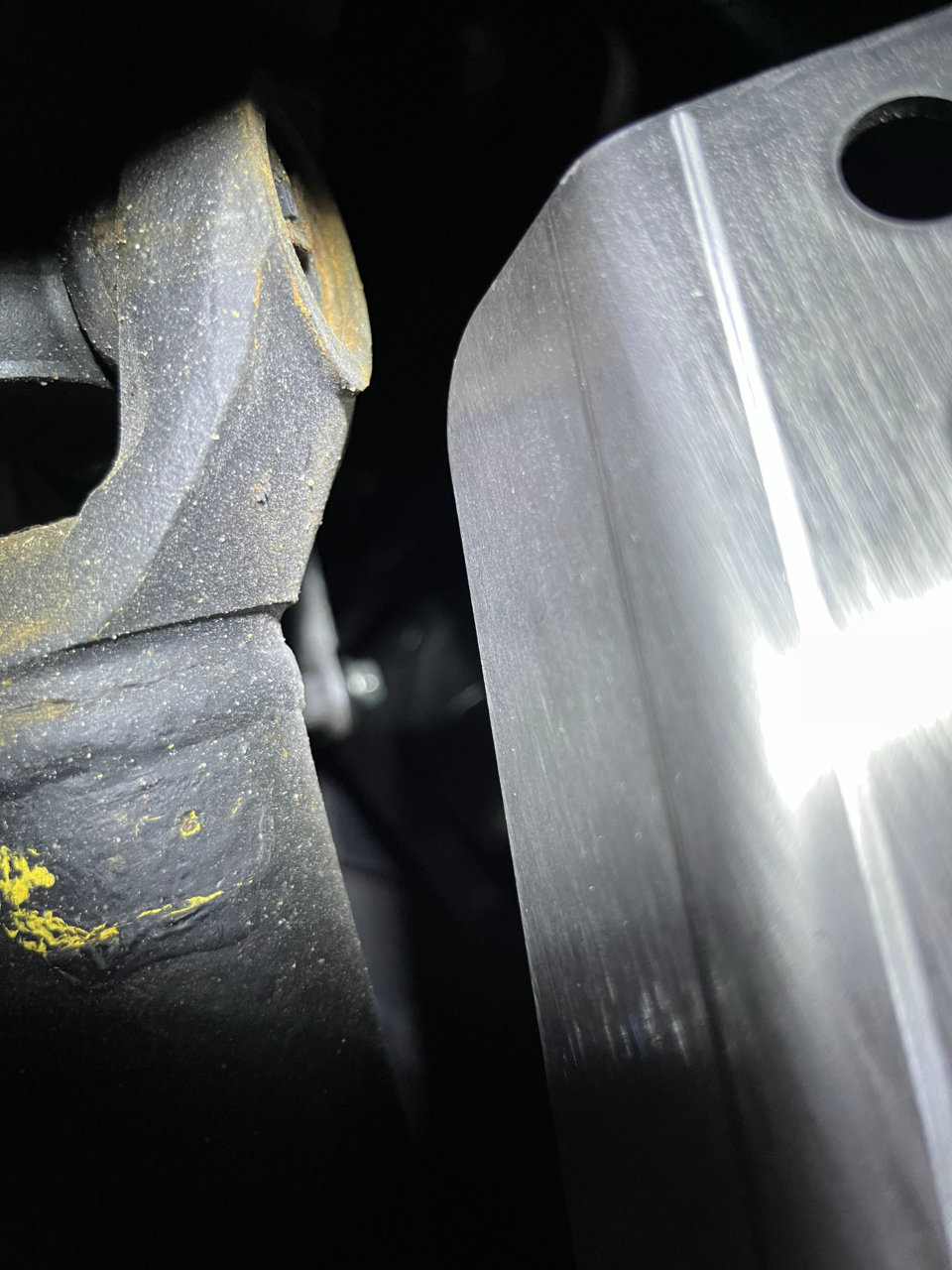

    Just got back in from working on the driver's side shield. I got under there and studied it every which way I could trying to figure out how v2 could be modified to shift it further away from the front driveshaft U-joint. The temporary answer turned out to be (for me), brute force.
    I removed the entire shield again and pondered the angles. There are a couple of solutions that would work with a redesign like @dietcokefiend suggested, but don't lend themselves to a DIY guy like me with limited fabrication tools - consisting of a few hammers a reciprocating saw, Dremels and such.
    So I ended up putting the end of the shield that's closest to the U-joint in my vice and bent that section inward. I started with 3mm distance between the shield and the highest point of the U-joint and ended with about a 9mm gap. Tweaking it that way did bring the bottom of the shield into direct contact with the cross bar, however since the security bolts are connected to the cross bar slightly further up, that doesn't seem to be a negative. In the end I think you could probably take a pickle bar and bend that part of the shield in a ways using the driveshaft as leverage.
    Put it all back together and it still easily clears the cat, I banged on it (no rattles), took it around the block, even put it in 4WD with no issues.
    It's still too close for comfort for me. So I'm going to forward my findings to @CaliRaisedLed to see what they have to say and/or suggest.
    I've attached a few photos, one before, one after and a couple showing the area of the shield that I bent inward to give some additional clearance in that area.
    Hope that helps and I'll post back with any more info that I receive.
