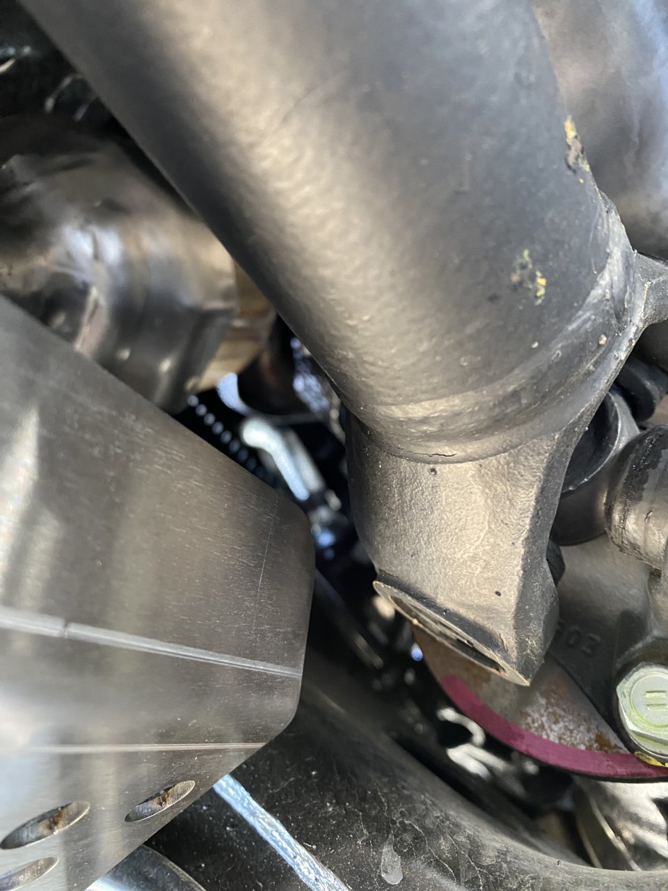

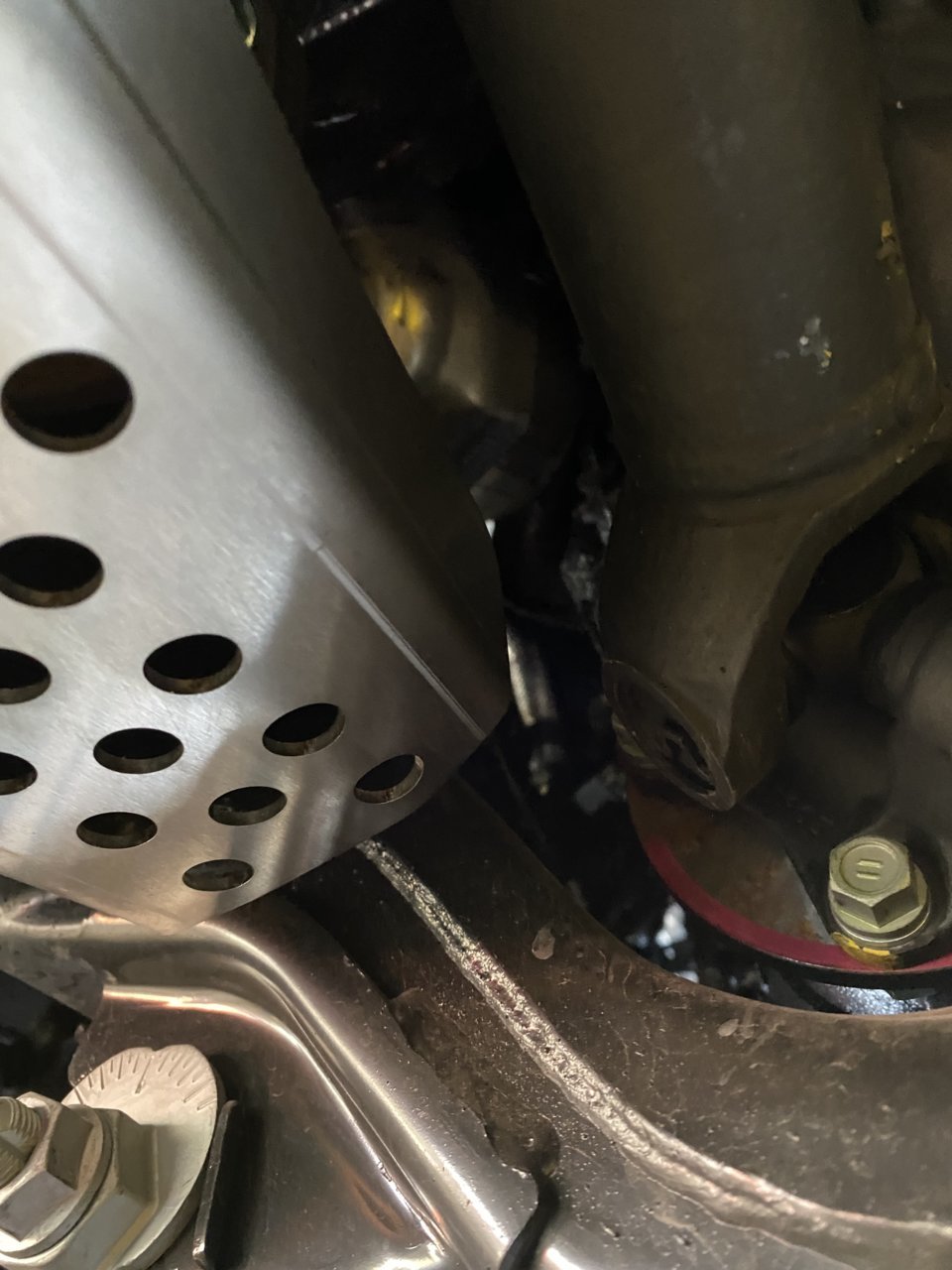

    Received an email from Chris (@CaliRaisedLed) which addresses *my situation* since I tweaked my shield to allow for about 9mm of clearance between the driver's side shield and the U-joint but others may need a little more guidance. It also confirms my earlier thoughts about the U-joint/driveshaft movement being vertical, not horizontal.
    "Hello Richard,
    Mon, Apr 10, 2023 at 1:09 PM
    Thank you for the detailed notes. I looked over your pictures and I believe your 9mm of clearance will be safe. The way the front diff is mounted to the truck, it does have a rubber mount to reduce vibration felt by the driver. However, if you take a close look at the two mounting arms they each have two bolts that connect in a front to back direction. This tells me that if the front diff does flex on the rubber the only physical direction it can move is up and down. I crawled under our test truck and checked how this would affect the CAT shield and from what I see, this will not be an issue for you. The way the tab is on the CAT shield it will not interfere with the driver shaft with even a major up and down movement. If it was side to side, it potentially could, however even with these rubber mounts, 9mm of side to side deflection would be quite extreme. Based on your pictures and notes you have a good install from my perspective and I don't think you have anything to worry about! Please let me know if you have any questions or concerns, thank you!
    Here's my earlier post regarding what I did to gain some additional clearance:
    https://www.tacomaworld.com/threads...2016-2022-tacoma.784146/page-50#post-28603447
    I'm going to rest easier now, but if you're not comfortable with how your shield is situated, it'd probably be worth getting in touch for some more detailed feedback from @CaliRaisedLed.

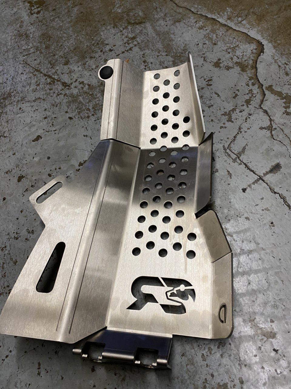

    It's pretty tight so I don't think you can get pliers in there, but even if you could, the shields are pretty heavy duty and it would take some Hulk strength to bend them by hand from underneath. I think your best bet is to remove it, put that part in a vice and carefully bend it in just a little otherwise you'll start to tweak the rest of it and that might be problematic when it comes to reinstalling it.
    At this point I believe I could actually install both sides in the 20 minutes or so the original video talked about... instead of the hour and a half that it took me the first time. :rofl:

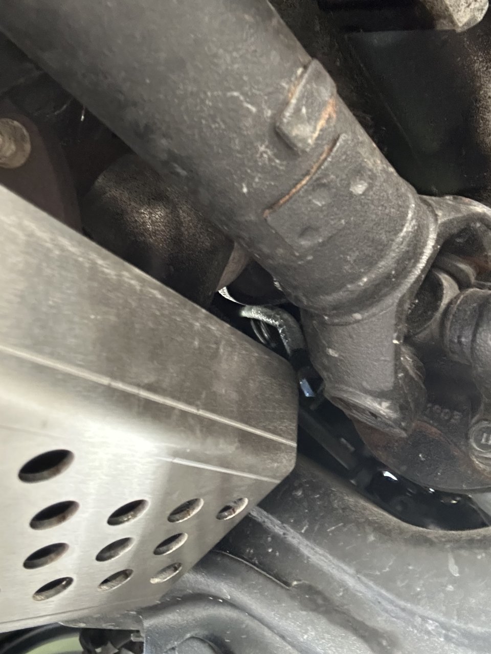

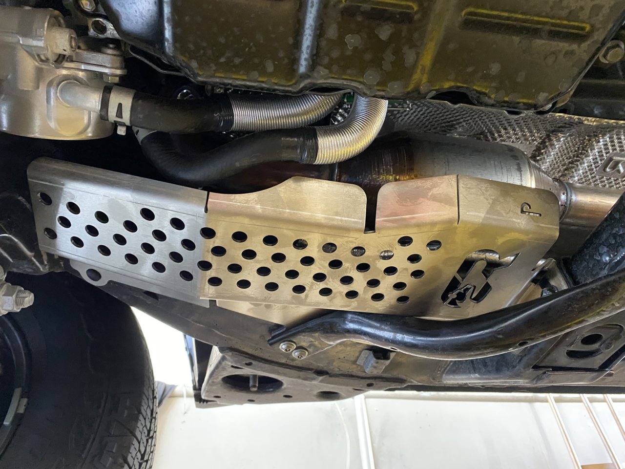

    I ordered my cat shield on 2/18 and received it on 4/6. I believe I got the V2 shield. The passenger side clears the transmission hose with plenty of space. I put some trimlok on that side just in case but is not needed. The drivers side has about a 1/4 inch of space with the driveshaft. I have no rattles when daily driving in 2wd. Also heard no noise when putting truck in 4wd. Attached are pictures and I also have a video linked below of the truck in 4wd to show clearance on drivers side with driveshaft. I don’t think this will be an issue but might end up using a angle grinder and cutting part of the corner off slightly for more clearance with driveshaft. https://youtu.be/ylpaANQ8IUg

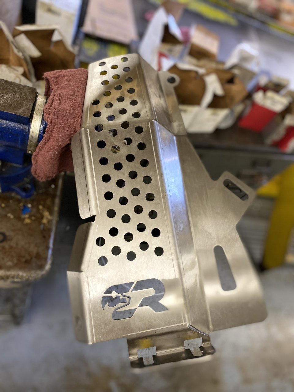

    I know right! I might just end up having to put the passenger side on haha but did you end up just bending the tab closest to the drive shaft? Or did you bend all 3?
    fasteddie23 and TRDRed[QUOTED] like this.
  16. Apr 10, 2023 at 4:44 PM
    #1036
    TRDRed
    TRDRed Well-Known Member
    Jan 8, 2023
    #415070
    1,198
    Pacific Northwest Playground
    2020 TRD OR DC SB OTT Tune
    Just bent the tab by the drive shaft. Luckily it's cut at just about the right place. Leaving the v1 on the passenger side. If it ain't broke... ;)
    [​IMG][​IMG]

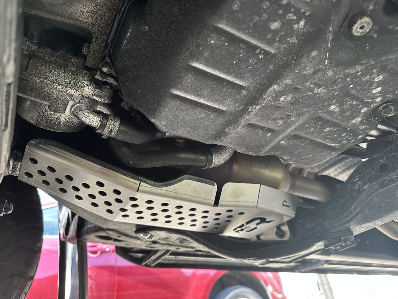

    Just got done finishing mine as well. Put a rag over the tab, put it in the vice and used my body weight to bend it haha. Thank you for the tip @TRDRed ! From the pictures it doesn’t look different but in person I feel like it is. Gives me less of a headache (for now)… ended up doing the passenger side as well since I was there and it looks like the v1 secured the cats more and the v2 exposes the cats a little more and the thieves can just slide the cats through the sides but these shields are just a deterrent so it is what it is. Hopefully it’ll be my last time taking these on/off. Reminds me of doing warranty work at the dealer :anonymous:
  20. Apr 10, 2023 at 9:22 PM
    #1040
    TRDRed
    Jan 8, 2023
    #415070
    1,198
    Could be the angle, but it looks like you have more space than mine. Well done! :thumbsup:
    Oh yeah, looking at the shield, you definitely bent it in further. So no alignment problems? Nice.
