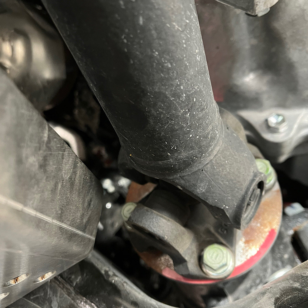

    Received yesterday. Installed today. Install was strait forward, no issues. Plenty of room between the cat and shield on both sides. I have about 3/4” (19 mm) between the front drive shaft and shield on the driver’s side. Everything fit up nice and tight, no rattles.

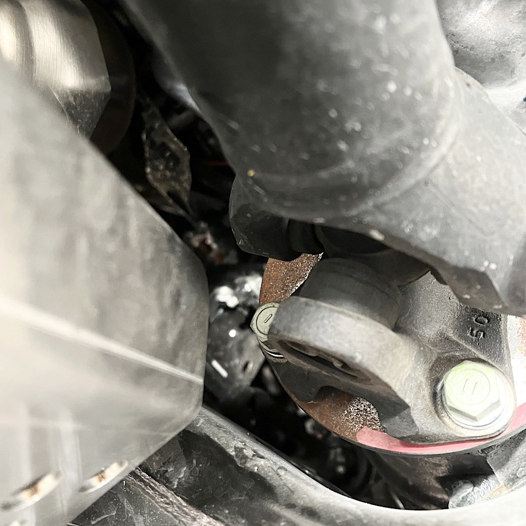

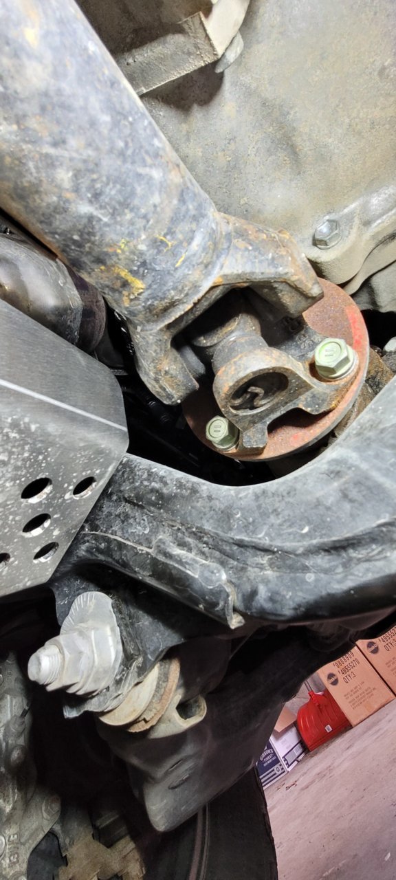

    You all think this is enough space. Installed the v2 today

  16. Apr 22, 2023 at 6:22 AM
    #1096
    MTBTACORN
    MTBTACORN Well-Known Member
    Mar 17, 2011
    #53212
    447
    Ontario, Canada
    23 Tacoma TRD Pro 21 Sportster S
    As long as it’s 1/4” or more, you’re good.
  17. Apr 22, 2023 at 7:31 AM
    #1097
    itzyoboipaul
    itzyoboipaul Well-Known Member
    Jul 18, 2013
    #108518
    2,922
    Paul
    PFville, TX
    2020 TRD OR Cement
    Close to 1/2”. Thanks for the reply and peace of mind.

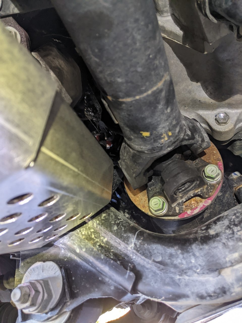

    Agree with @MTBTACORN, it looks good. Chris, the engineer at @CaliRaisedLed told me that 1/4" or so is sufficient space between the U-Joint/driveshaft and the shield.
    I was concerned as well and ended up taking my v2 shield back off, tweaking (bending) that edge of the shield inward in my vice and putting back on for about 9mm of clearance. Photos here. Haven't had any issues.
    You should be good to go!

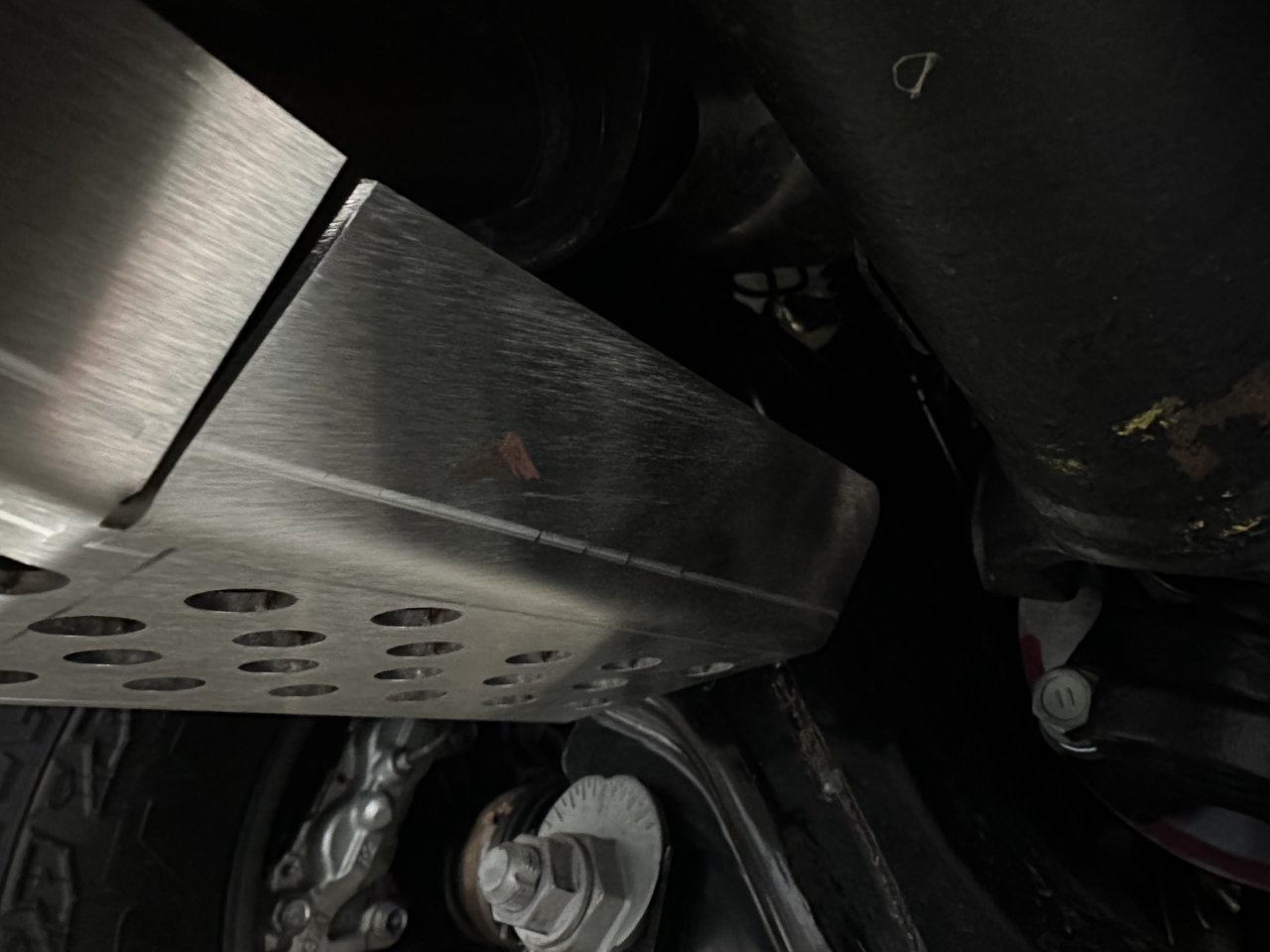

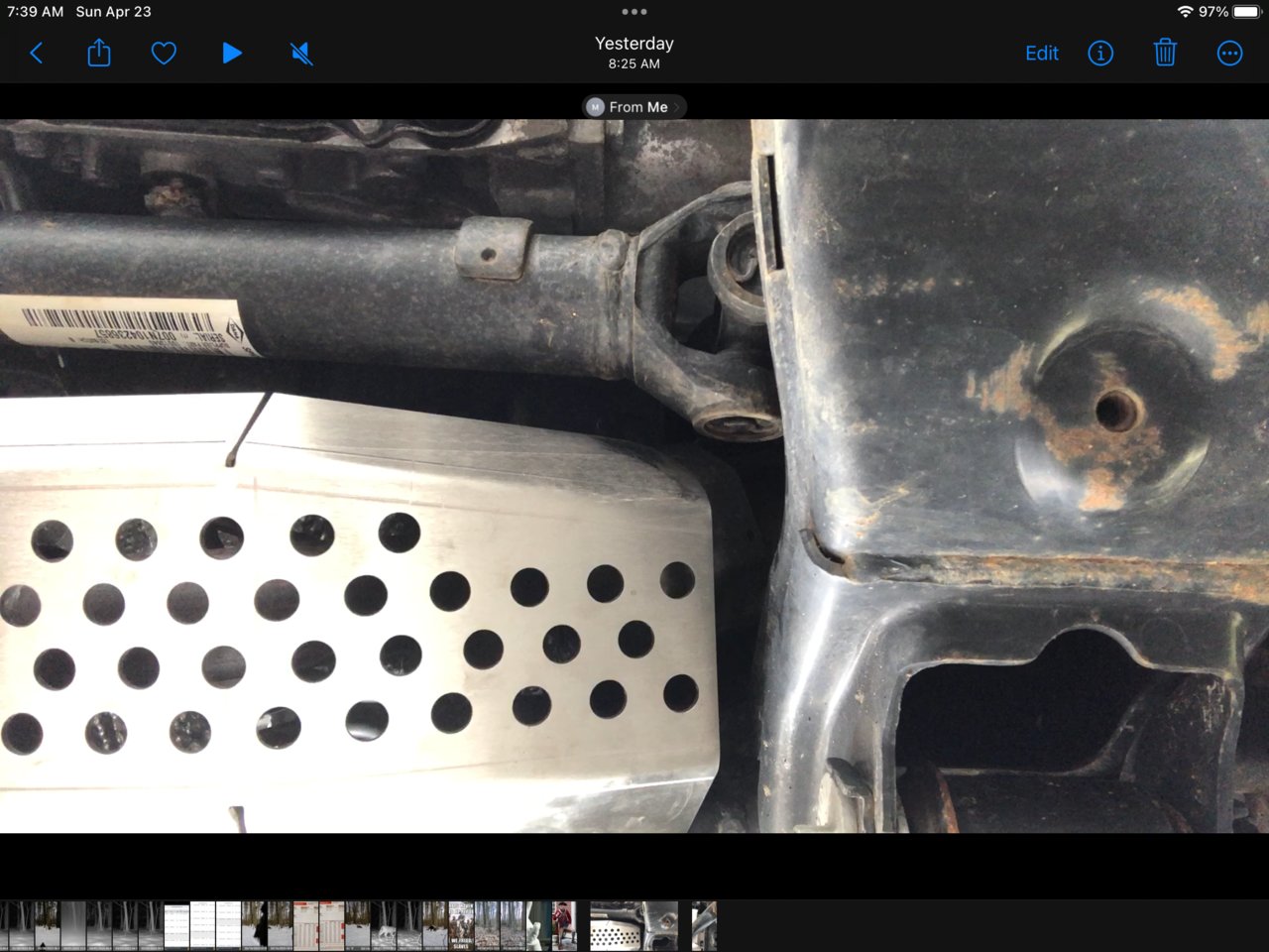

    Here’s my install info, received my shields about 4 weeks ago so I definitely have v2.0. Because of snow on the ground and a bad cold I finally installed them on April 20. Put the truck up on ramps, the driver’s side had less than a 1/4” clearance, so I took it down and went to a bench grinder and removed about 3/8”, reshaped it to duplicate the curve (radius) shape. Finished it with a file. It went in sweet and neat. I hope this helps anyone out there, road tested on some rough pavement and in 4x4, no problems. Photo isn’t the best but there’s plenty of clearance. 4051ED2A-3CD8-407E-9B66-8007501E288D.jpg
