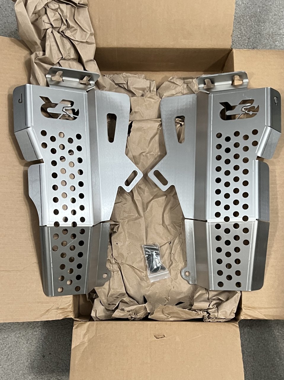

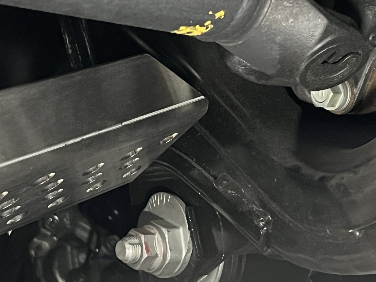

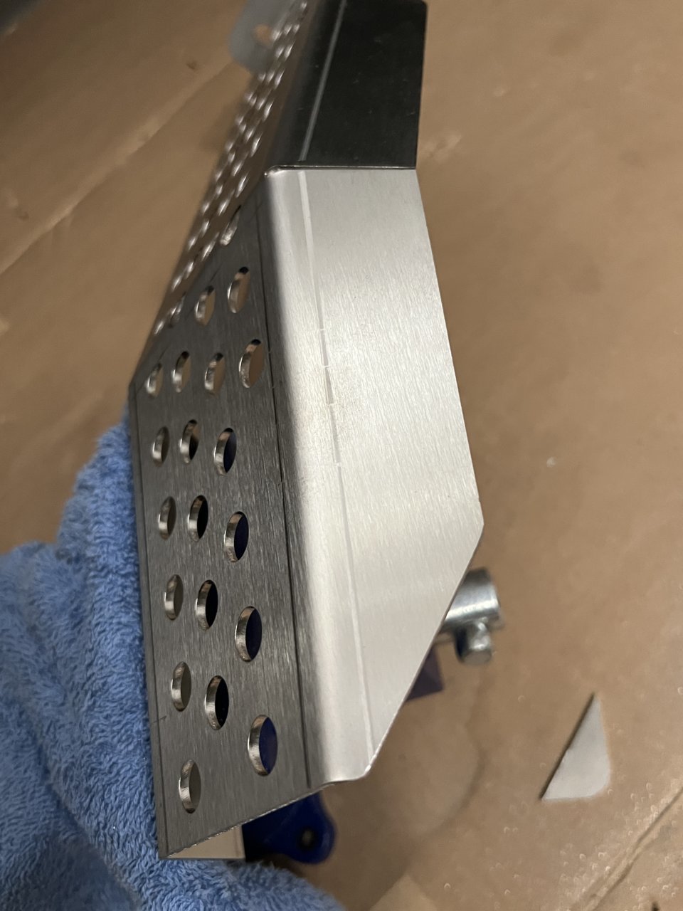

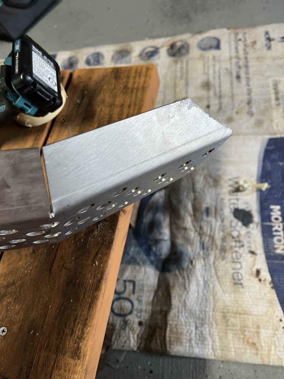

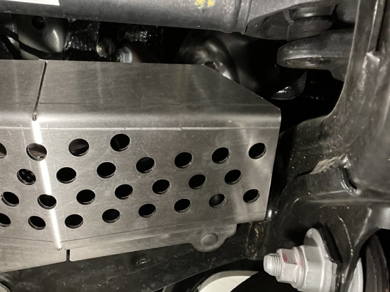

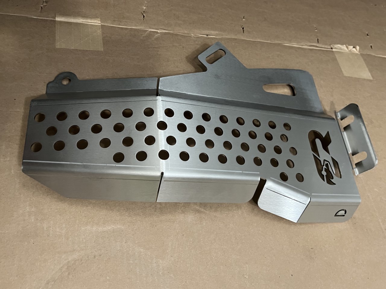

    Received my shield few days ago.

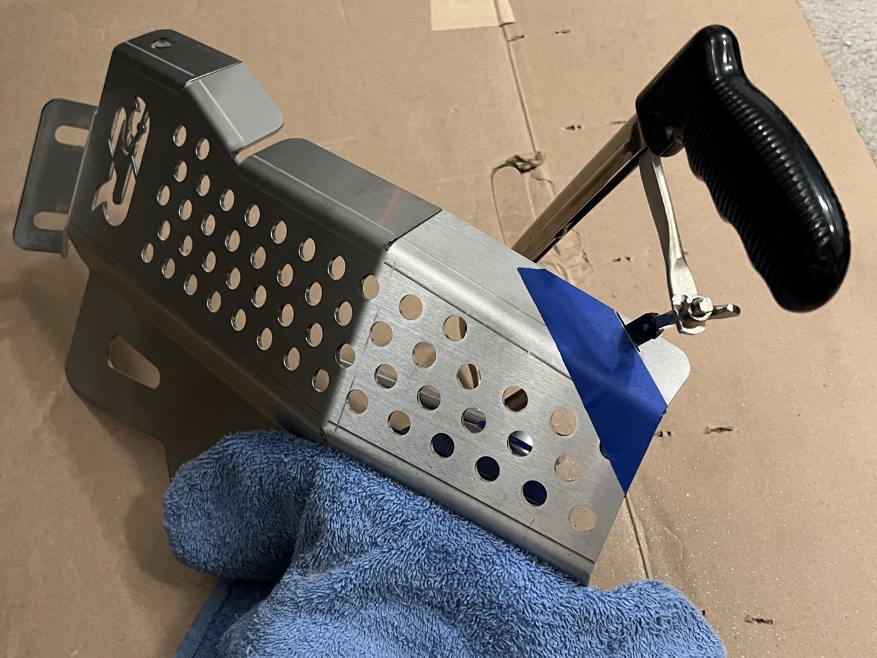

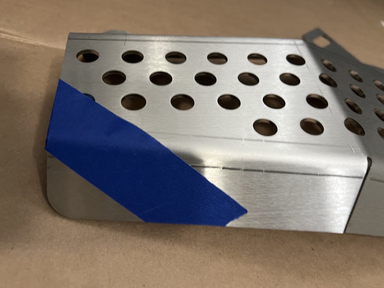

    Marked up with tape to cut the corner off for more clearance from drive shaft.
    Aprroximately ten minutes of workout with the hacksaw. Man that blade was dull!

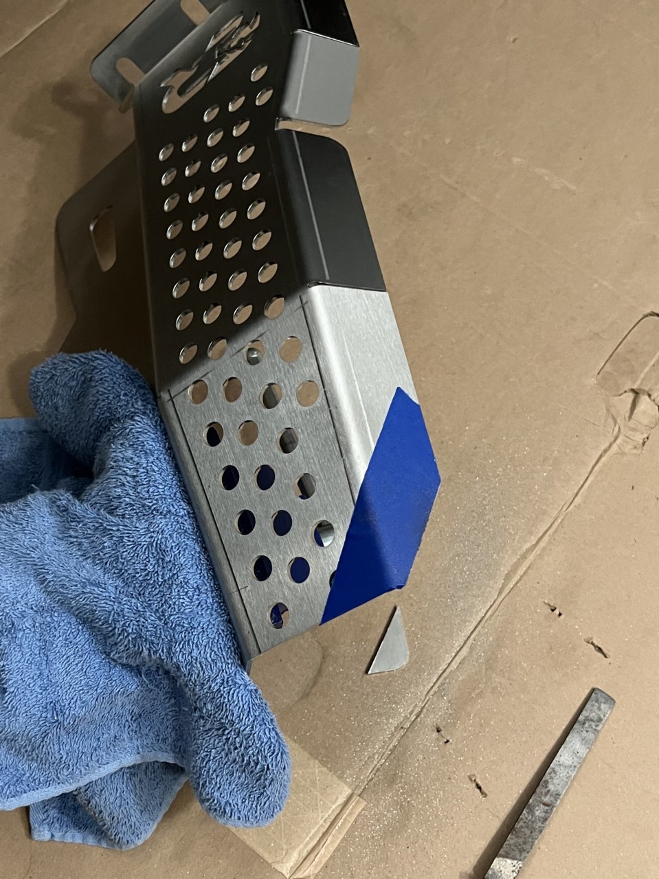

    Cutting completed. Hit it up with the file.
    All filed up and it turned up pretty good.
    Getting ready to install.

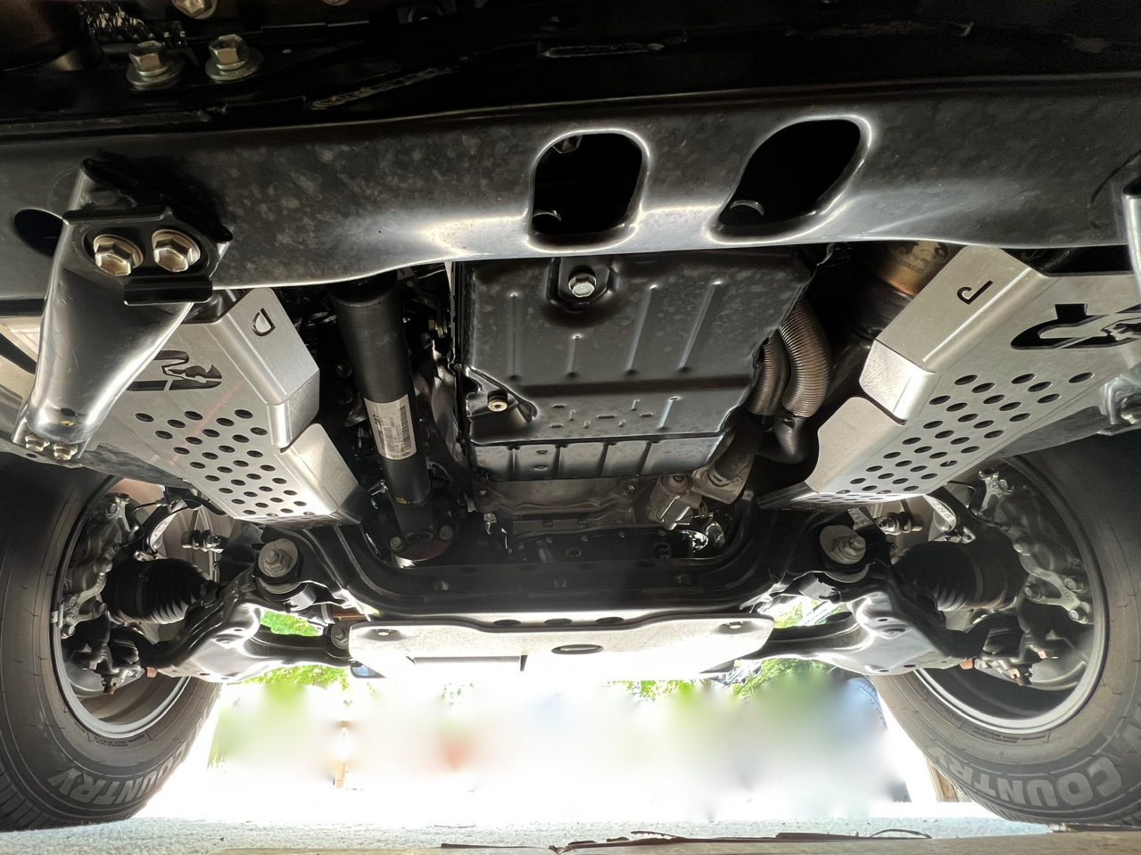

    Installed. Cleared the drive shaft nicely.
    About an inch away from the shaft.
    All torqued up and ready to go. Man that looks sharp! I love it.
    Shout out to @AZPhys13, @mobySR5, and @50Buck for sharing the torque specs!

    Nice work... looks great! Let's hope you and maybe your mechanic are the only ones that ever see them! ;)

    how long did it take to cut that piece with a hacksaw? Really curious
    TRDRed and MTBTACORN like this.
  10. Apr 24, 2023 at 1:36 PM
    #1110
    ThAkki
    ThAkki ¯\_(ツ)_/¯
    May 12, 2016
    #186748
    284
    About ten minutes. Blade was dull and I didn’t want to run to the hardware to get a new one. Lol

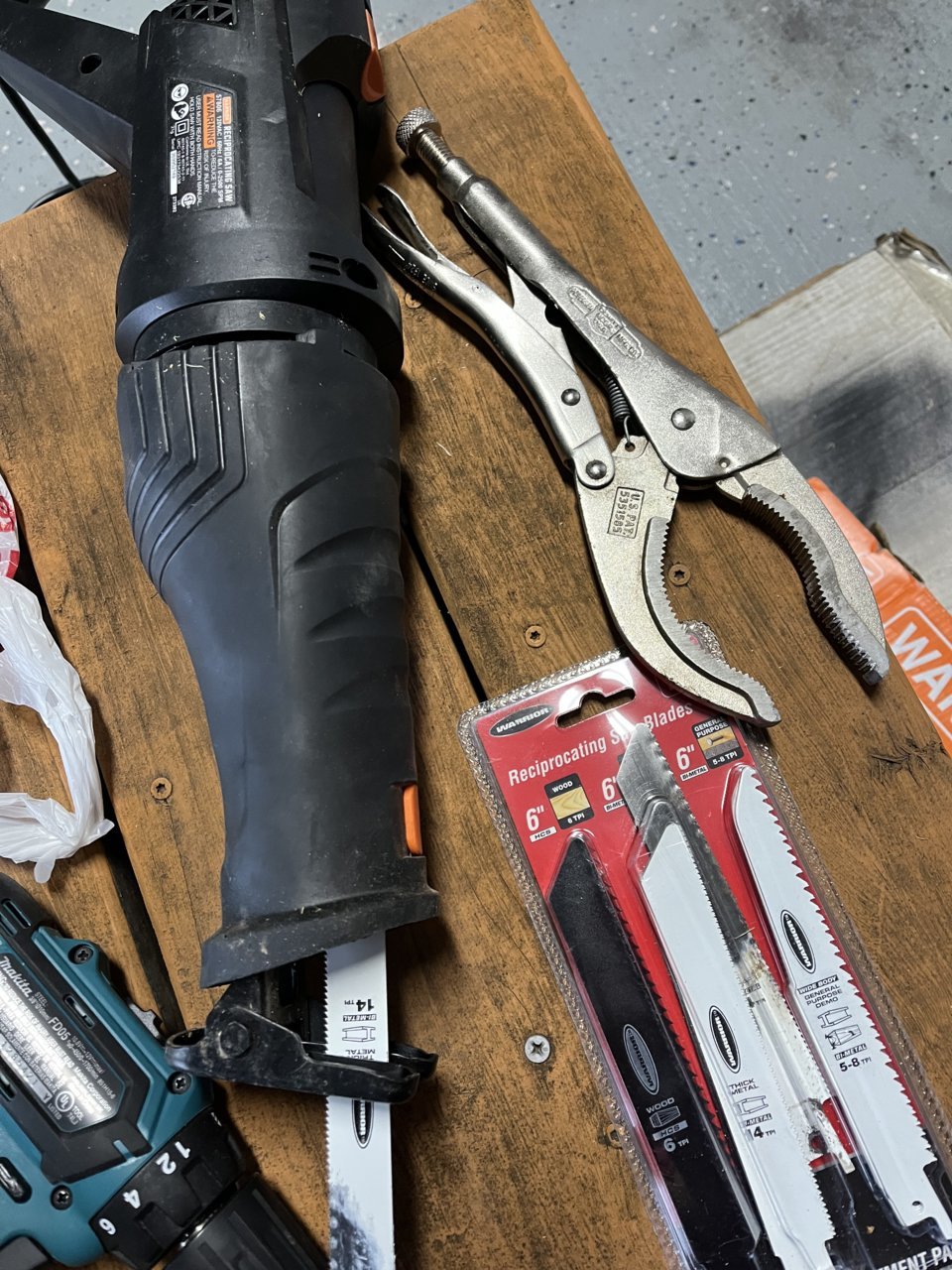

    Forgot I got a reciprocating saw. Done in 5min
    might be an overdo. But it made me smile

    Nice solution. Maybe better than my grind and file.
