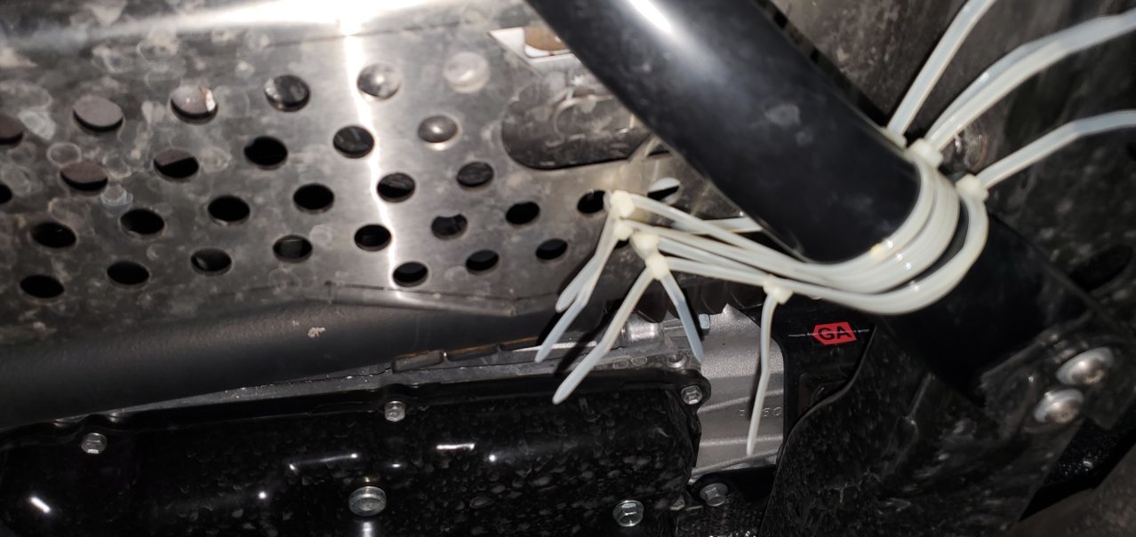

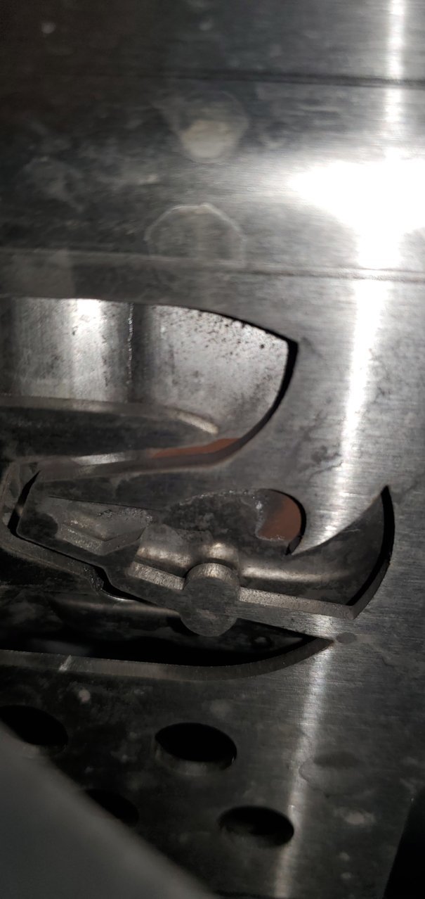

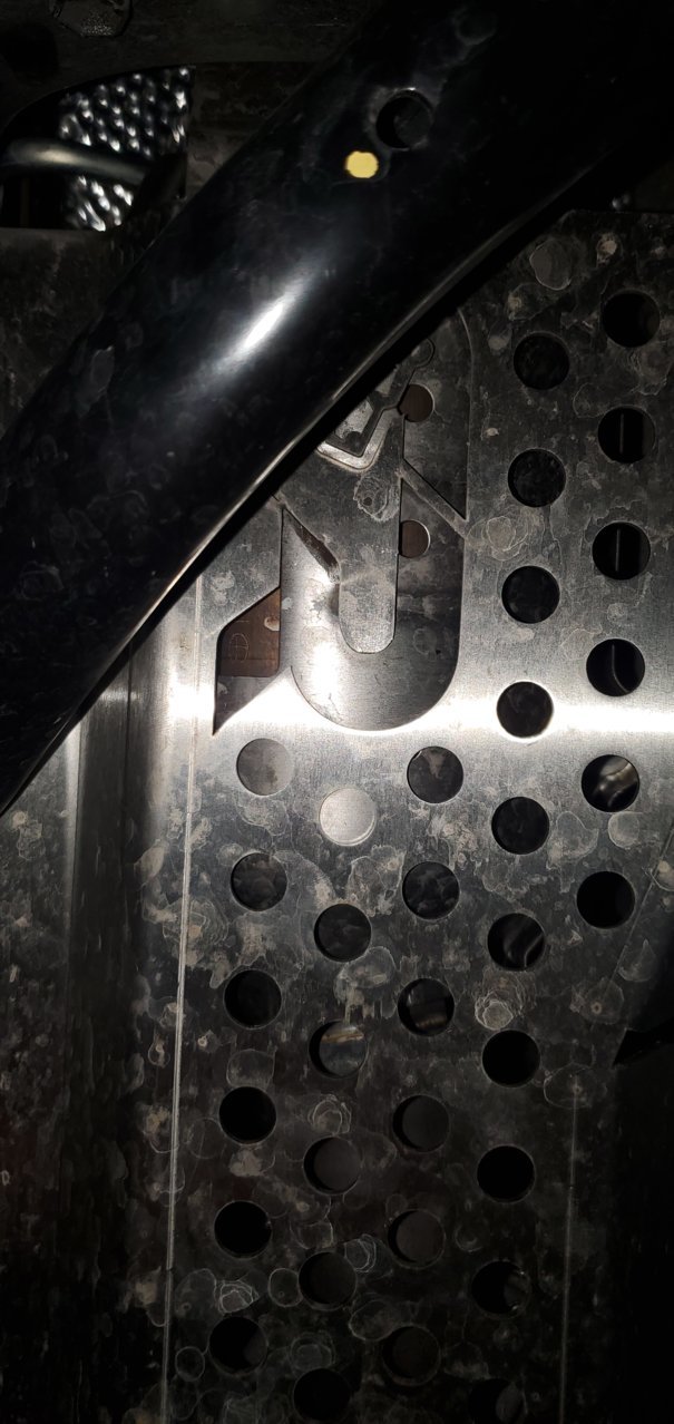

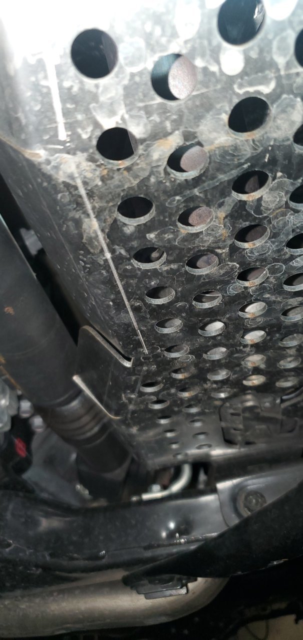

    So I looked under the truck and drivers side is definitely making contact- I noticed this when I installed them as well- there are clear rubbing marks. That would conclude they are V.1, correct? The last photo is of a temporary fix to see if this is the cause of the vibration noise; just enough zip ties to pull the shield away from the cat. I know these won't last long but I have not yet heard back from Cali Raised and the first set of shields took 6 weeks or more to receive, I will likely get some metal zip ties at a later time as I do not currently have the tools to take the shield of completely -which I would prefer as I do not know the long term impacts this issue may pose. I hope these photos are enough for them to help me out. I will keep posted.

    Those are the V1 shields as they go over the tranny crossbar. If you're going the zip tie route till the new set arrives then use some metal zip ties.

    That's the plan, I'm just hoping the plastic ones will work long enough to help me determine if the vibration noise is actually coming from the shield first, after which I will apply some metal ties until I can-hopefully- get the help from Cali Raised to send the new version.

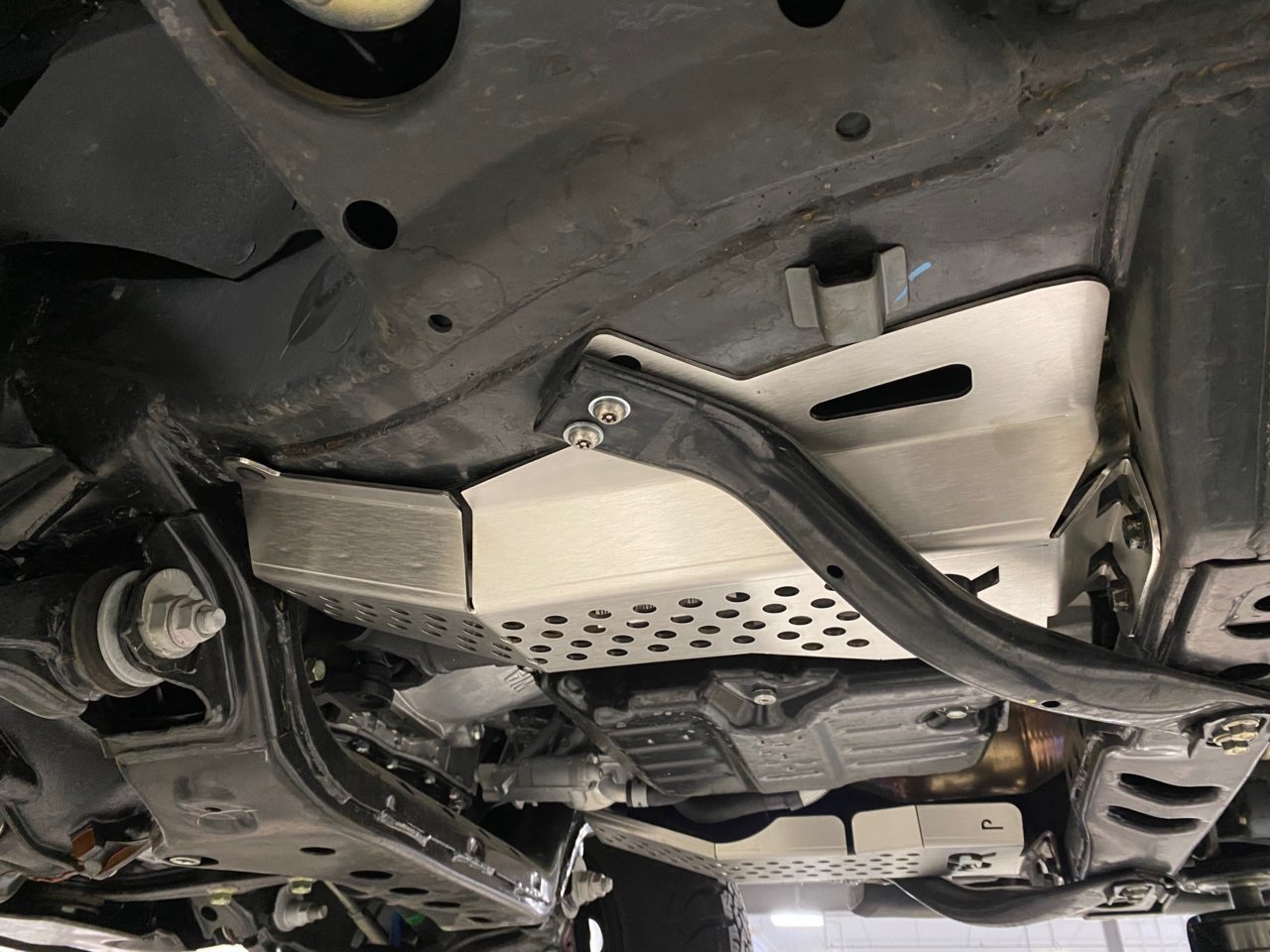

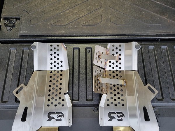

    Yes, per @MTBTACORN those are the original v1 designs. The v2 are actually easier to install. As I mentioned in my other post, I only replaced the driver's side shield. The passenger side doesn't touch the cat and doesn't make any noise. Photo of the v2 shields below another member posted.

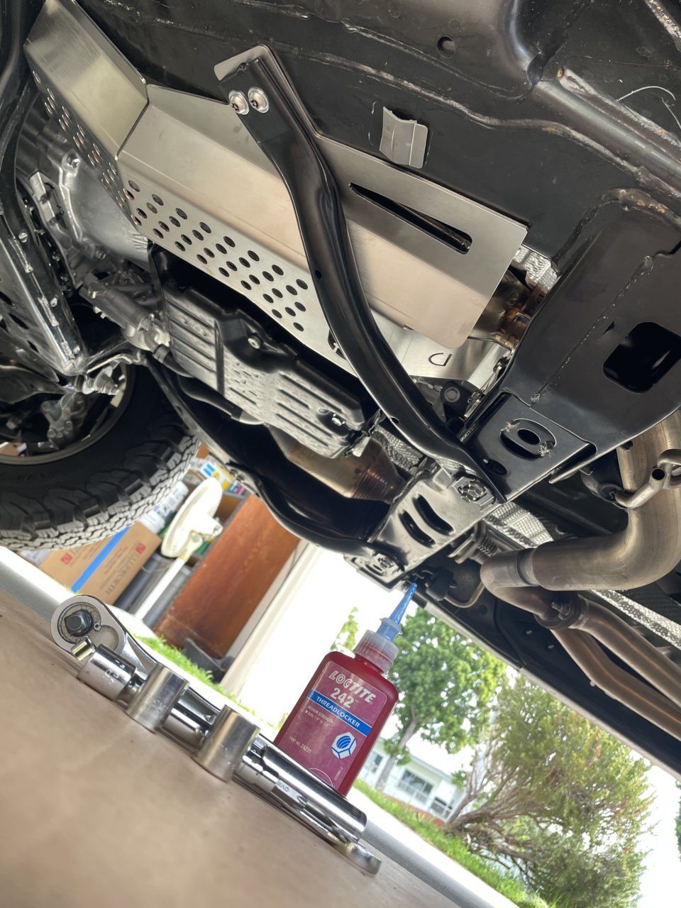

    @TRDRed thanks for your input in this thread :thumbsup:
    I researched them ALL & decided on the CaliRaised shields & they're right up the freeway from me, so bonus!
    I finally got around to installing them this am;
