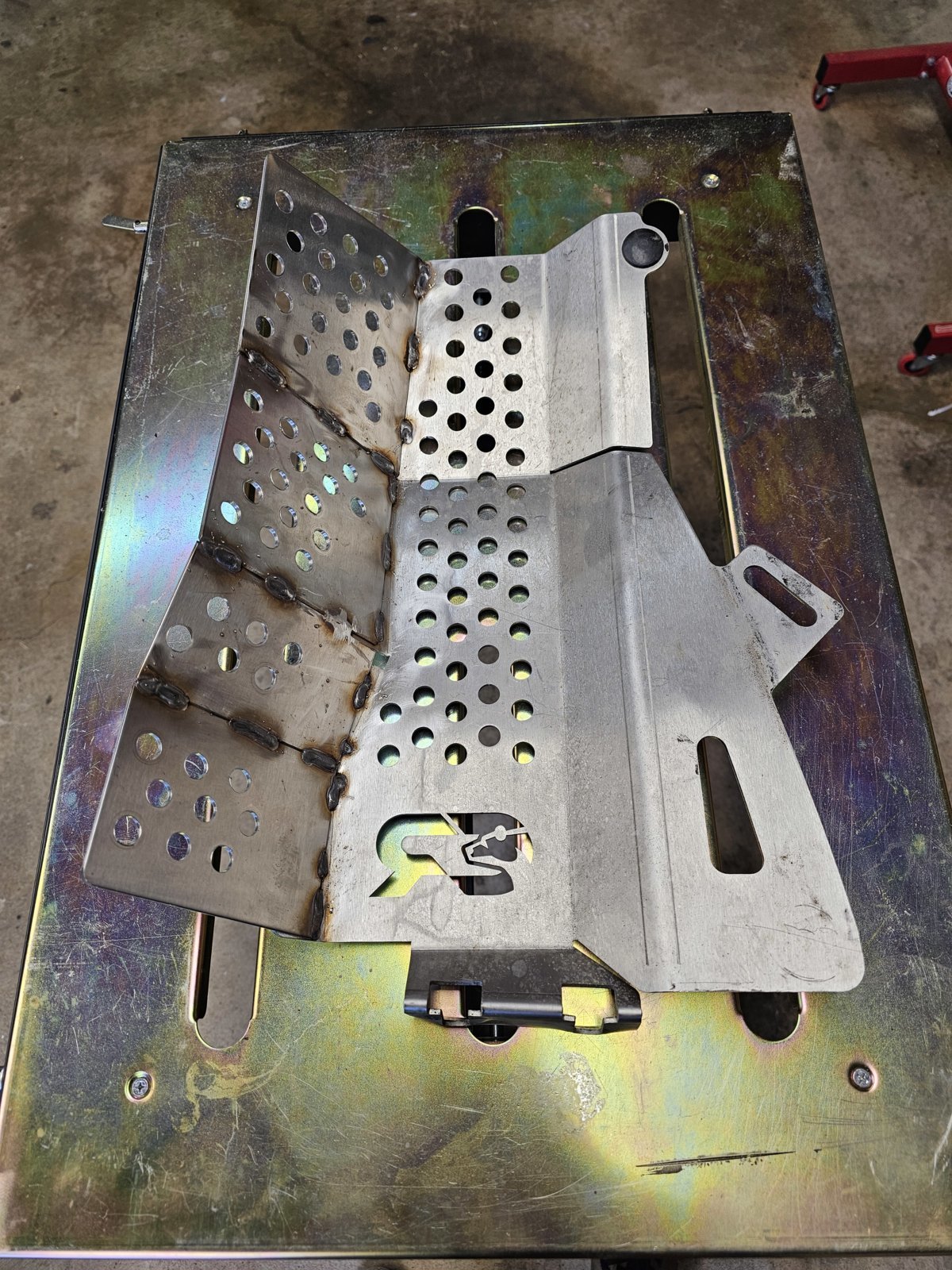

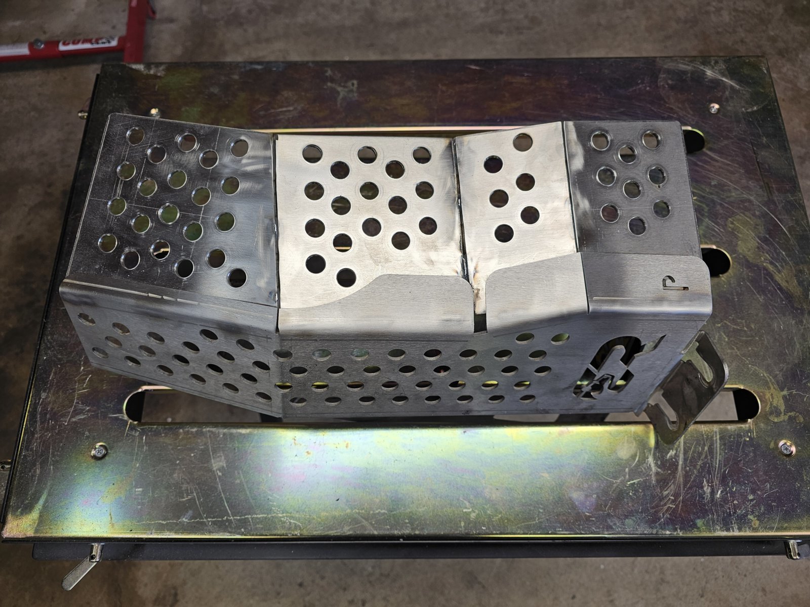

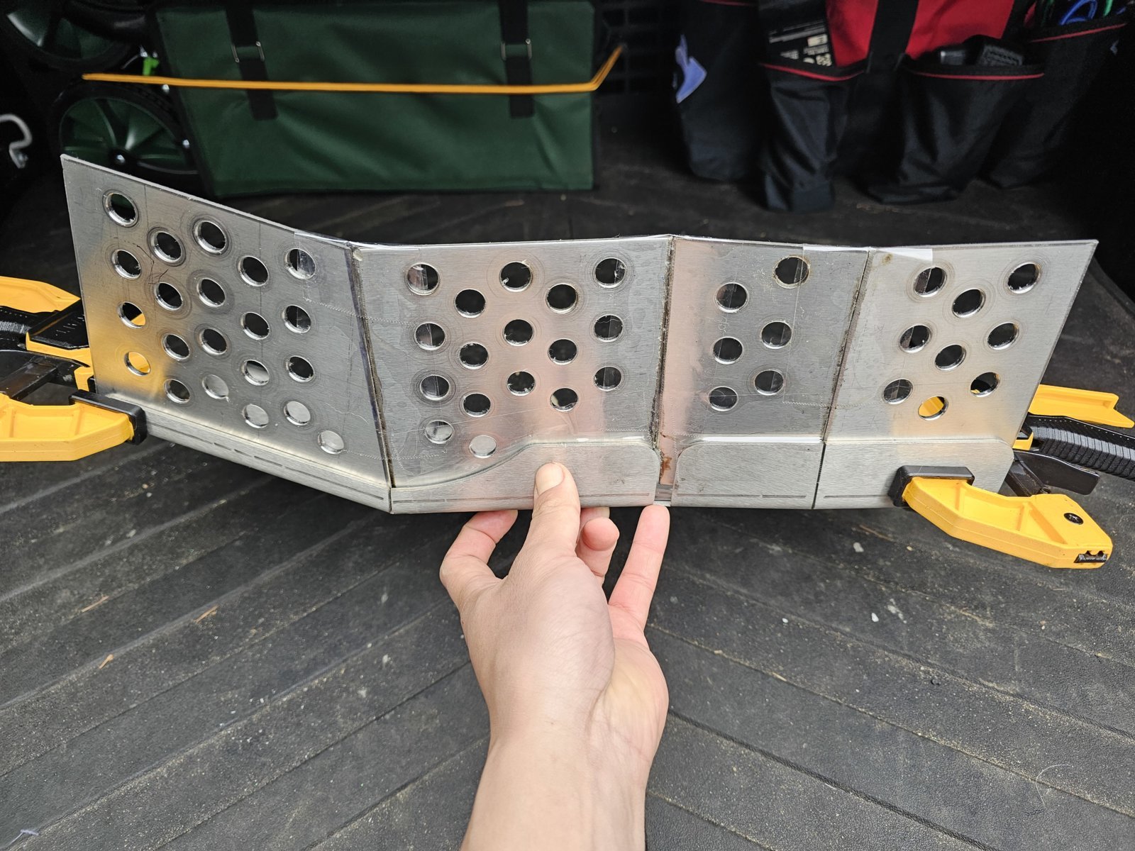

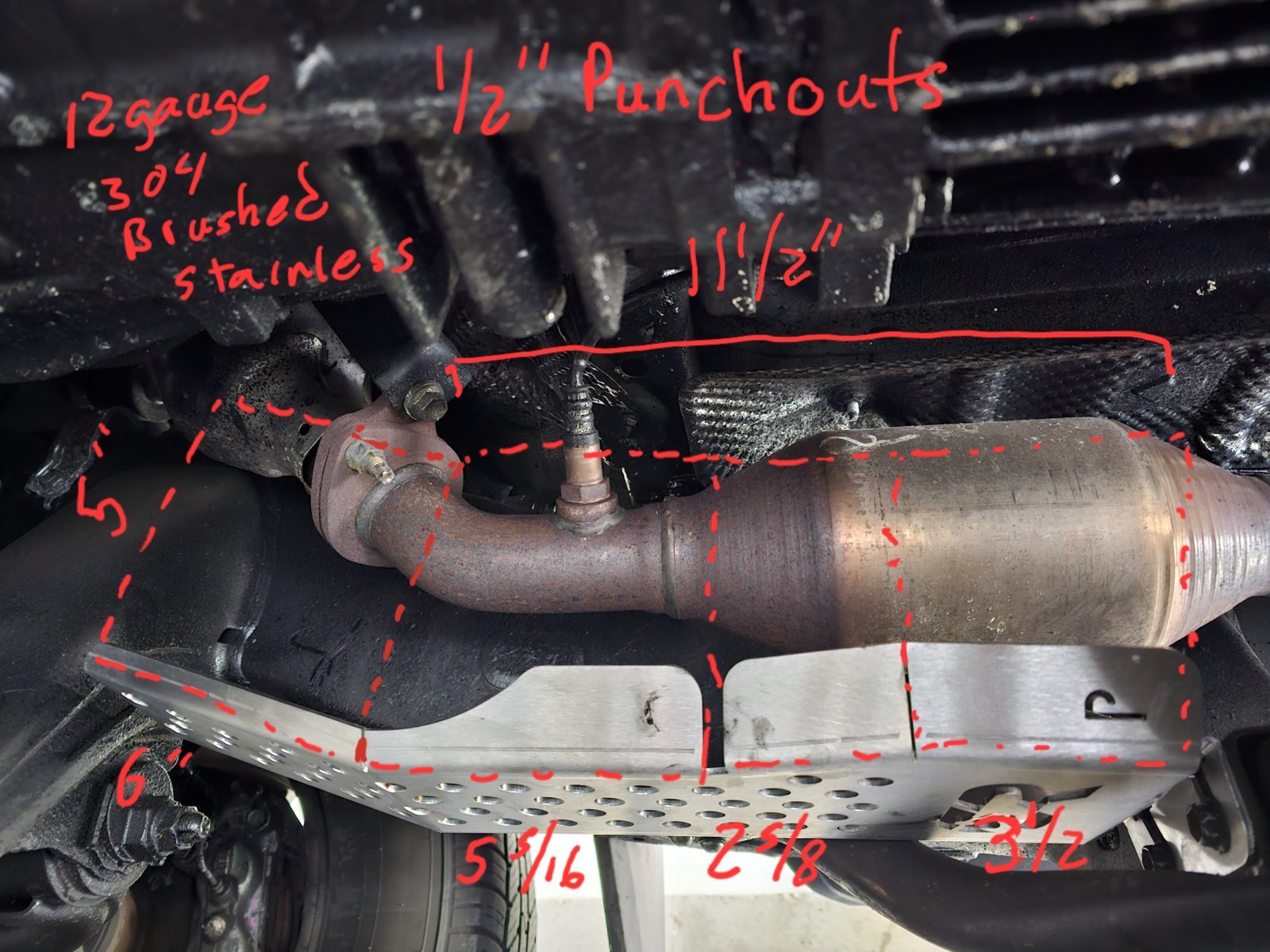

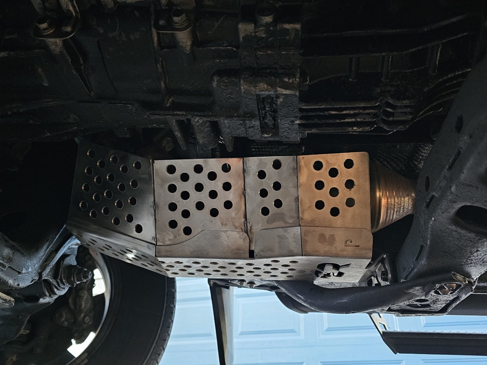

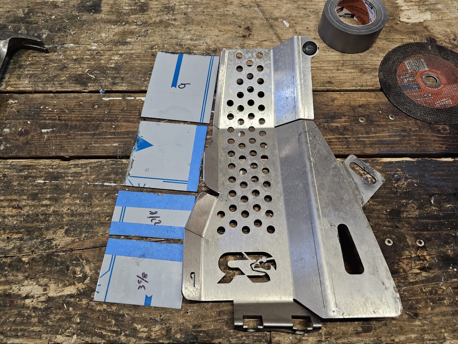

    Couldn't wait for Cali Raised to release a manual version any more. Decided to make my own extension plates and weld them on with my uncle's help.
    Measurements
    Cut pieces
    Traced the hole design and drilled out the holes, then test fit
    Welded
    Installed
