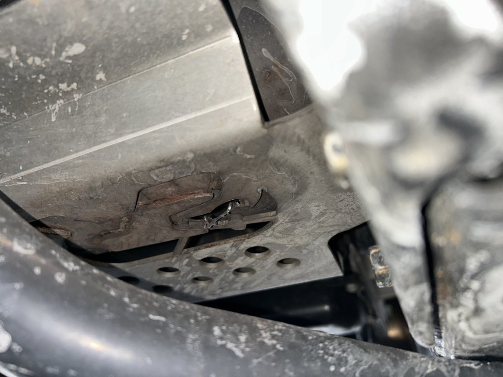

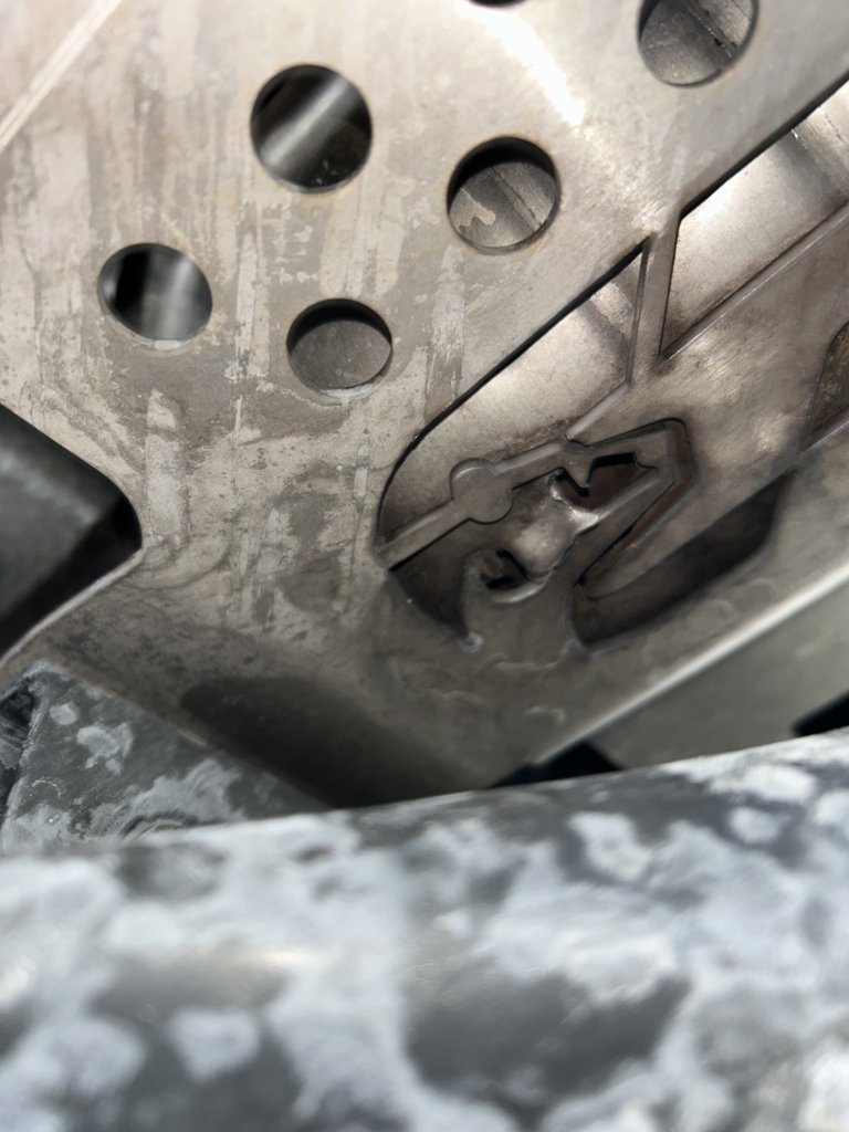

    So what is everyone doing about the damage caused by the 1st gen Cat Shield? Mine doesn't seem too bad compared to others, but it still is a decent hole to collect dirt/salt which will likely expedite rust and corrosion.

    Does the damage happen on both sides or is it concentrated on one side? I still need to swap to the 2nd gen cat shield and I’m not sure where to look for any damage.

    this is my drivers side. I didn’t check my passenger side. They are sending a new set so I’ll probably just replace both.

    The tight fitment was on the drivers side for me. Swapped both sides with the updated version over the weekend, kudos to caliraised led for standing behind their product.
    It should be very easy to visually check if things are too tight, just shove your head under and look near the logo cutout. If the catalytic converter heat shield is touching or very close it will be obvious.
    The new version is also a tiny bit easier to install, no longer does the shield need to be routed over the cross member.

    If it really bothers you I think the shield is sold on its own as two pieces. 18445-0P020 I believe is the lower piece... I'm not near my truck to verify so I'd double check before blindly ordering that part.
    That being said it's a heat shield that isn't sealed to the elements, you could argue that if you got a hole worn in it it will drain even better than stock. Any moisture that ends up in there is going to evaporate pretty quickly as catalytic converters get *hot*.

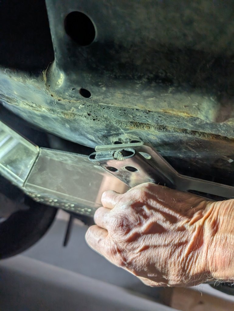

    Purchased for $190 shipped on 3/24/25, received days later. Finally installed today. Didn't have to lift the truck, just scooted under both sides (and my OR is stock height).
    One gripe is that the included T40 tamper proof Torx bolts used in the front of the support tube are shorter than the stock, when they should probably be 5mm longer to support the addition of the shield that they now support.
    But I'm glad I went this route rather than some of the Amazon options.

    Thank you so much for choosing us, and we appreciate the feedback regarding the bolts. We will absolutely look into this further!
