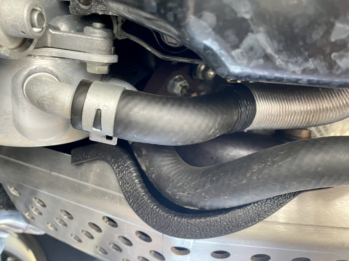

    Where did you get the edge guard material? I have extra door edge guard stuff, but it is not as beefy as what you have used.

    It was extra I had from my SSO bumper install.

    Here’s a little more of the coolant hose setup on my 2022 truck.
    Chris, On the truck you pictured the hose connections are further outside the shield area. Whereas on mine the shield was making hard contact on the outboard hose clamp and rubbing the inboard hose prior to me making modifications. It still needed to be deeper (cutout area) but I think I’m going to be fine with the edge guard installed.

    The edge guard is a good diy solution but you shouldn't have to do that. In a cold climate with snow or someone who goes off-road I can't imagine the edge staying in place long term.

    The edge guard was placed there after I ground off 1/8-3/16” of material that was hard contact/rubbing hose clamp and hoses. There’s about 3/16” clearance on the hose now. The edge guard is extra protection.

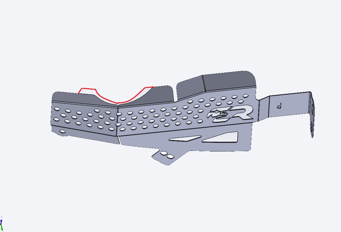

    Hey everyone, we just wanted to share the latest note on a change we made on Friday based on the notes from @JAL. Please see the attached pic that shows the area we trimmed in red. We removed the top of the flange to create more space and also enlarged the curved opening to ensure the hoses are out of harm's way. This area is important to keeping the CAT safe and not creating too big of a space for thieves, but we also need to protect those coolant lines. It is a fine line to walk and unfortunately, Toyota does not like to send us aftermarket companies comprehensive notes of model changes or provide CAD of any kind. So sometimes we learn about different configurations through our customers. We will keep an eye out for any other notes. With what we have received, we are confident that these are going to be perfect moving forward. We can't wait to keep getting these produced as fast as we can. Thank you again to the community for your amazing support!

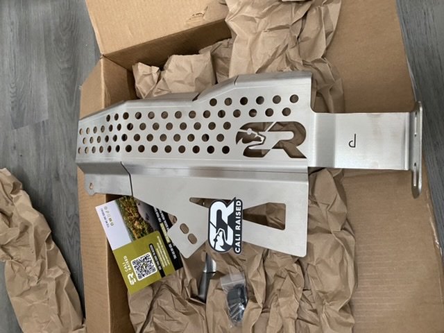

    I have a 2022 like JAL mine arrived with the area in red still there Can I get a replacement Passenger side so I can not have to modify the one you sent?? Really don't want to modify a new product

    I have a 2020 and the shields are supposed to be here on Thursday. Do you know when the changes were made that required these changes to these shields? Alternatively, what year did you test fit on?

    Look forward to people posting once they receive and install the new version reporting if this creates a grab point to pull the shield down without any front secure points.

    Just received mine yesterday. like mentioned, I also have a 2022, would it be possible to swap out the side with the coolant hose to the updated version?

    It might not be an issue with the 2022 during install. We encourage you to give the install and if you have an issue reach out to our customer service. We are unable to assist on tacoma world.
