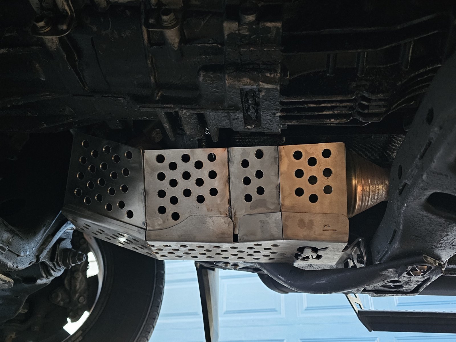

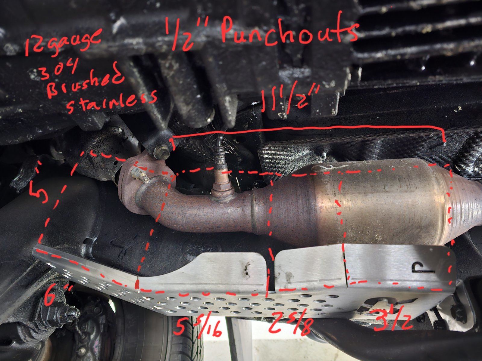

    I originally had the Talon's Garage one. But I recently switched to the Cali Raised one since I like the design a lot better. The Talon's Garage one was like a giant skid plate and blocked access to parts of the truck and would make maintenance (30K specifically) annoying since you would need to conpletely remove it. The pro is obviously it provides more off road protection.
    The Cali Raised one is very low profile and covers only the cats. The downside to them is that they don't come in a manual configuration, which I see is what you have as well. The passenger side is completely exposed. You would have to weld on some plates like I did to make it work.

    good catch on the OP having MT. cali raised in that case is a rough way to go, requiring welding, but congrats on making it work.
