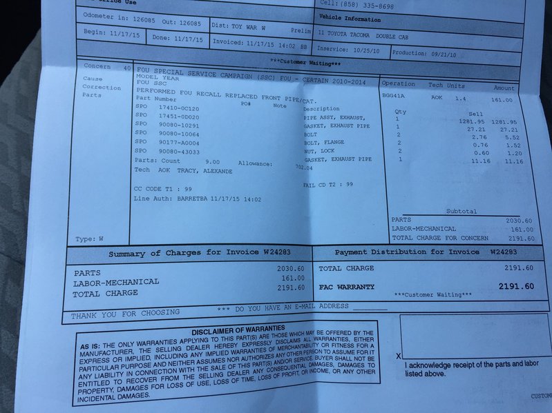

  17. Nov 17, 2015 at 2:38 PM
    #57
    FlightMedic178
    FlightMedic178 Well-Known Member
    Dec 2, 2013
    #117789
    112
    Nate
    Phoenix
    2020 SR Utility, 2013 Land Cruiser
    Bone stock
  18. Nov 18, 2015 at 3:39 AM
    #58
    tomwil
    tomwil Well-Known Member
    May 15, 2014
    #129887
    8,025
    East Coast USA
    2014 Reg Cab 4x4
    Like how the 9 total parts only come out to $1,328.56, and the dealer pads $702.04 to soak Toyota for $2030.60.
  19. Nov 19, 2015 at 11:03 AM
    #59
    Canufixit
    Canufixit Well-Known Member
    Aug 9, 2012
    #84402
    2,072
    People ask me "CANUFIXIT"!
    New England
    2020 Red SR 4x4 Taco
    "Access" Tonneau cover. Bed Mat. Hitch, Timbren SES
    With knowing the ways Different dealers are repairing vehicles with various parts and costs back to the owners/corp, Does anyone have a Actual repair instructions from Toyota? for the Service campaign listing with parts?? I just want to be sure I/we get was supposed to be covered/replaced and not what the dealer just decided to do... and double dip to the Till. i.e. - Previous post - Was the $702.04 for parts that they charged Toyota for but did not replace ???? (Muffler, tailpipe, etc.)
