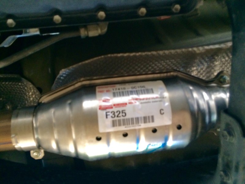

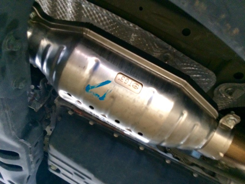

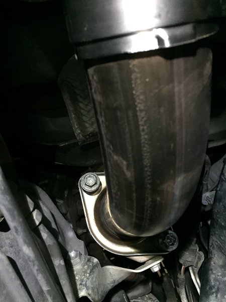

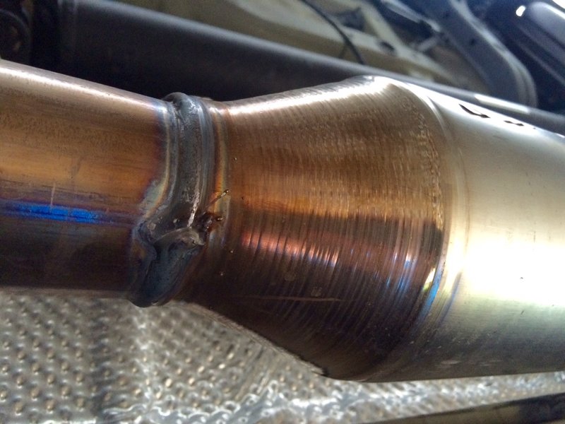

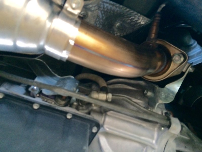

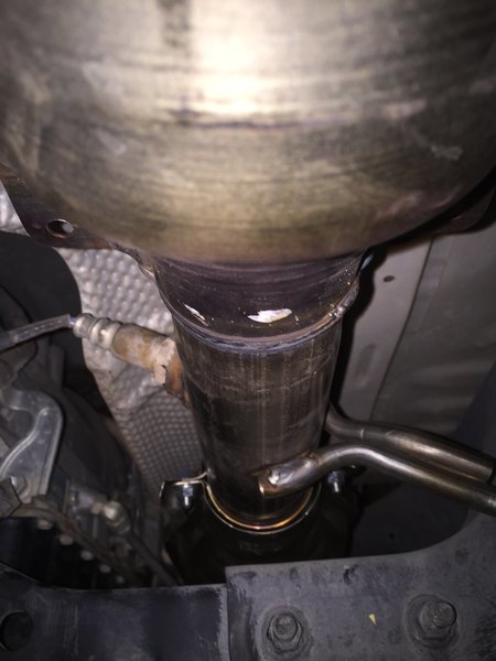

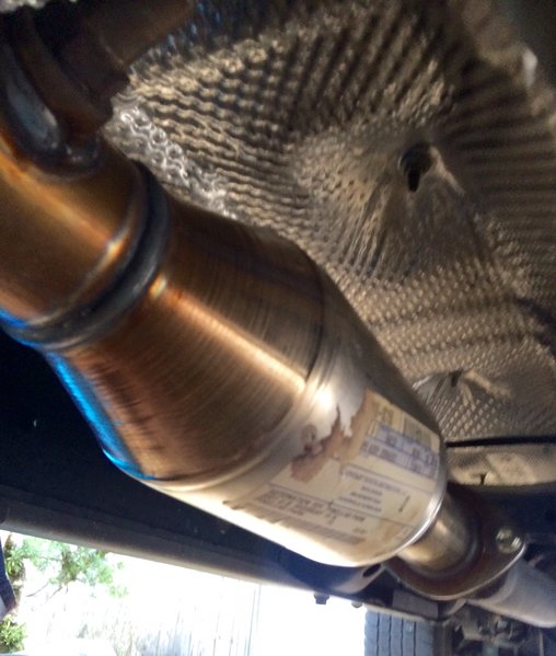

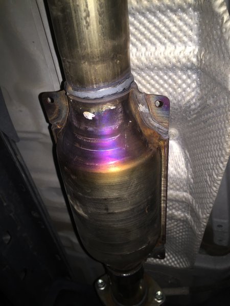

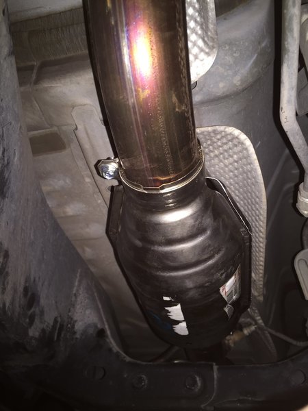

    Not sure of technical names but everything from bottom of header to muffler was replaced. Here's some pics of the new items:

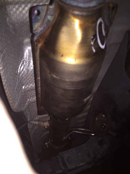

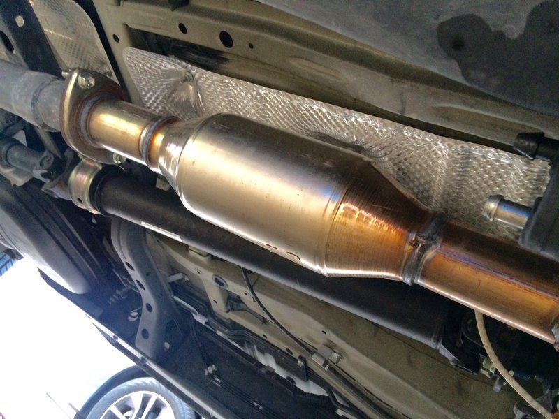

    I have a 2013 4cyl Pre-runner. I had my cats replaced last year under warranty when they failed suddenly and totally blocked the exhaust. I just had them re-replaced under warranty again yesterday with the newer design. It took about an hour at the dealer. I called ahead of time to make sure they had all parts in stock and they did. They look like titanium in person-absolutely gorgeous. My truck runs the same, no difference.

    Thanks Nate & Billy! :) It would have been nice if they had replaced the O2 sensor (Nate's pic 4). What bugs me is that if you had to pay it out of pocket, it's more than 10% of what I paid new...:drevil:

    It would be nice if they took off the sticker after installing the part.... Unless if they are not suppose to?
