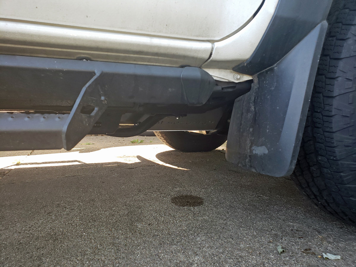

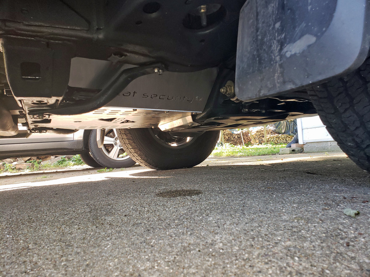

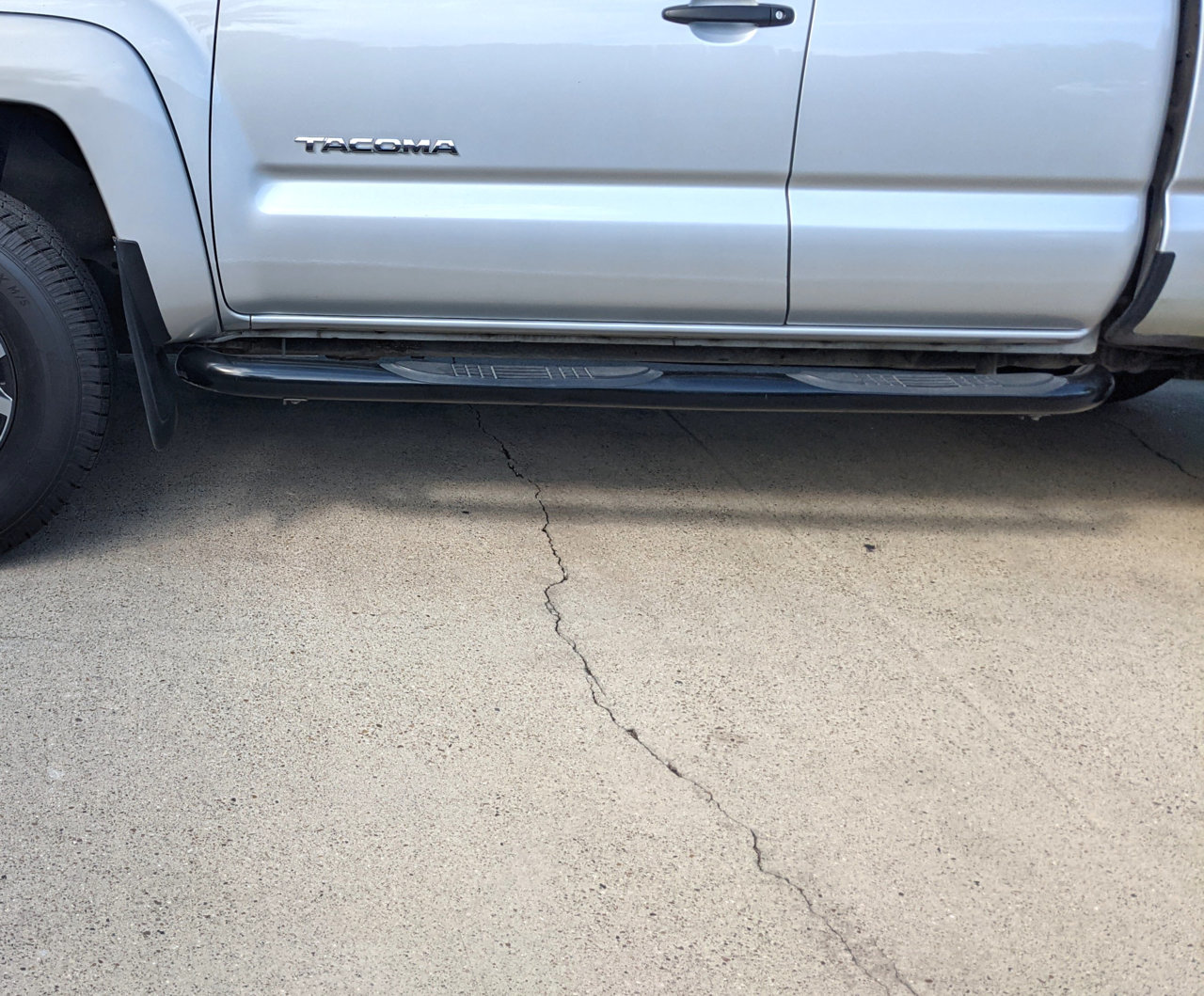

    Do you have a photo of your install you can share? Wondering how the shield looks like from a side view when standing a few feet from the truck. Appreciate.
  2. Jun 29, 2021 at 7:28 AM
    #242
    CrufflerJJ
    CrufflerJJ Active Member
    Dec 26, 2020
    #350720
    44
    Jeff
    2019 Taco OR
    See pics...

  3. Jun 29, 2021 at 7:32 AM
    #243
    Simba001
    Simba001 Member
    Sep 29, 2012
    #87957
    13
    The Beautiful PNW
    06 4x4 Taco
    Thank you. Appreciate seeing it actually on a ride.

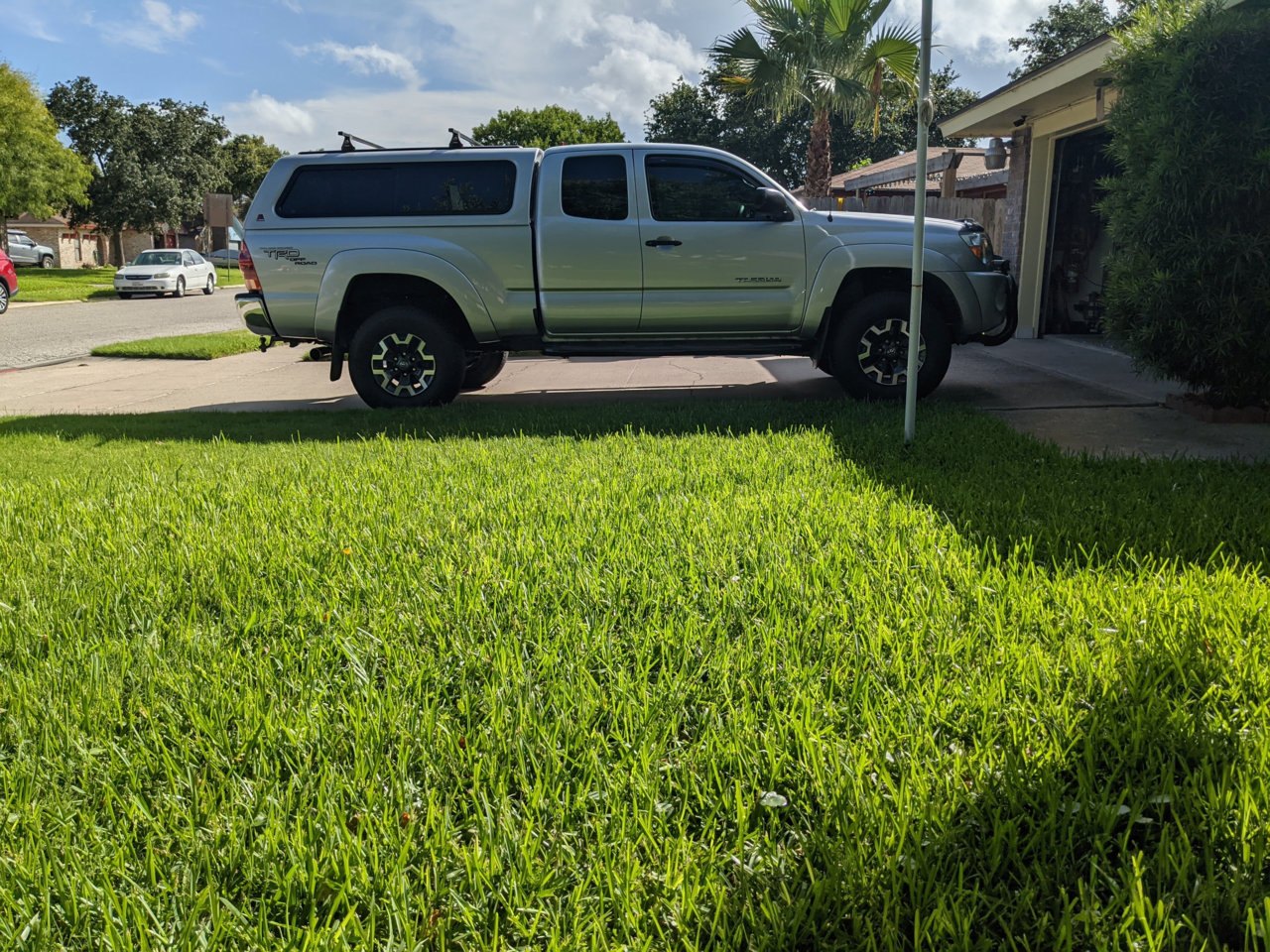

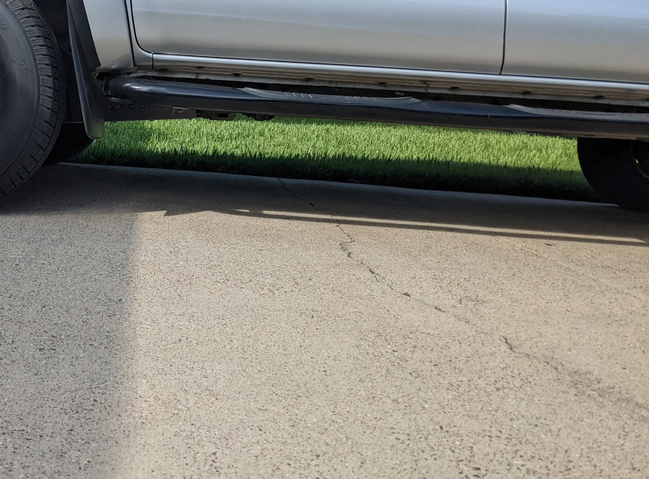

    Just finished installing one on my Gen2. I'm not lost, but when I did a search this thread popped up and I read your request for pictures. Here's a few of pictures taken from a few feet away and further. There's no visual evidence of it being there.

    Thank you so much for these pics! I actually have a Gen2 also and have been having problems finding information/photos related to the Gen2 and end up in these other threads… This is very helpful.

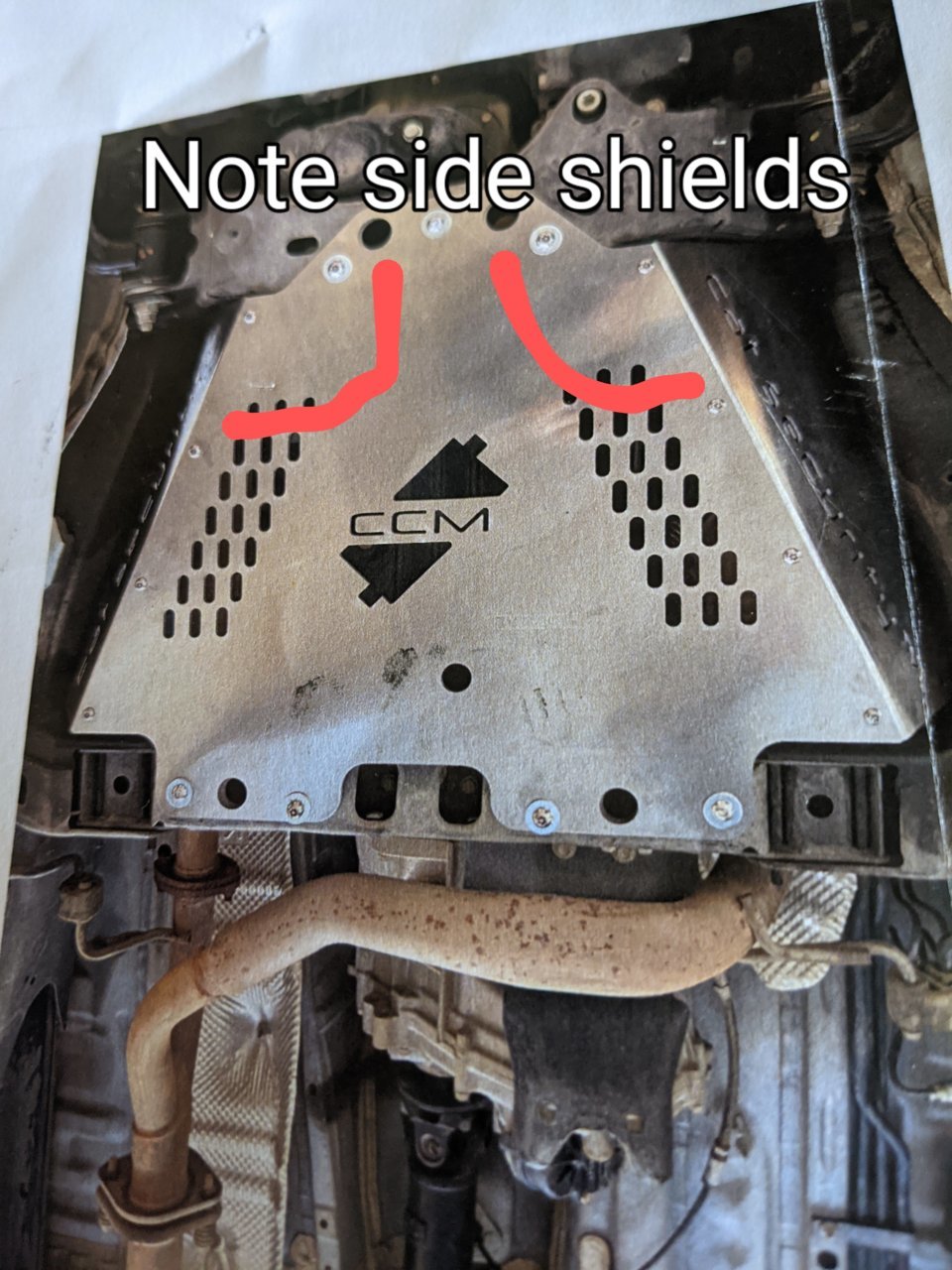

    @SeoulMan82 my bad, it's actually called Cat Security. Here's a couple of pictures I took from the included directions from the one I ordered. May give you an idea what is looks like, before and after.

    This is a great post. It was exactly what I was looking for. The plate looks like a solid choice without having to install a full set of skid plates. Thank you.

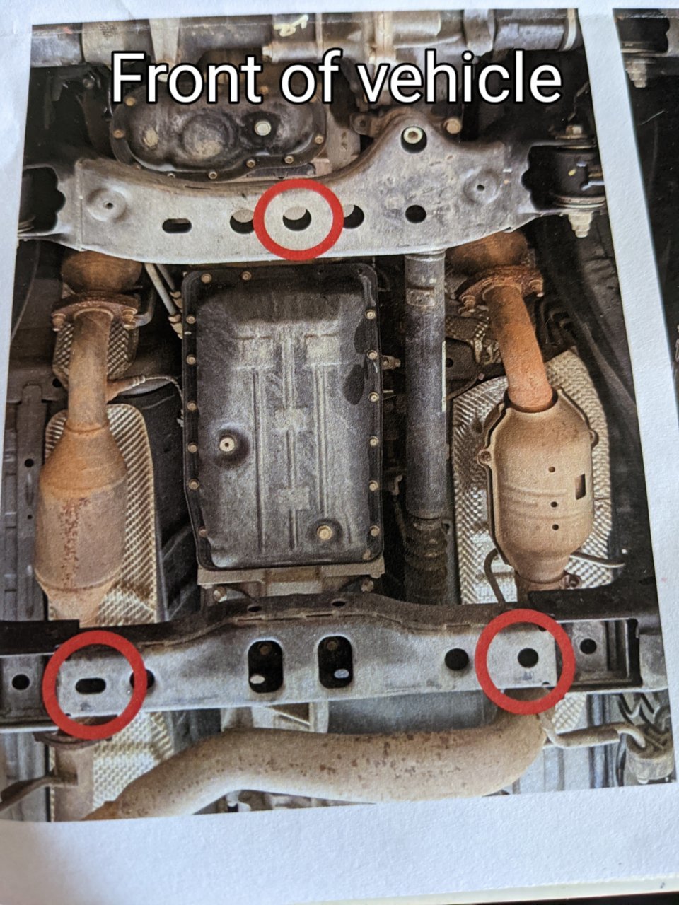

    I just wished this used existing holes in the frame.

    The three red circles are existing frame attachment points. They supply four revnuts for additional attachment points that I didn't use. I only used the three because I felt it was strong enough and would be enough of a deterrent that the would be thief would move on to easier prey. I put two nuts on each bolt, first the regular nut (good and tight) followed up with the nylon insert lock nut, again good and tight. It took some time to do, so I know it's going to take some time and a lot of effort to remove. Because of the front skid plate it took a good deal of contorting to do the front attachment point. The rear two were not too bad, but with the double nuts on each bolt I figured it going to create a huge hassle for anyone. After doing all this I opted out of drilling for the other attachment points.
    I know, nothing is theft proof, but here's the way I look at it. Do I leave the front door to my house wide open or unlocked so some "ner'er-do-well" can walk in? No, I create a deterrent by locking the entry door knob and using the dead bolt. Then I keep my trusty "pistola" within reach just in case I need to properly greet them.
