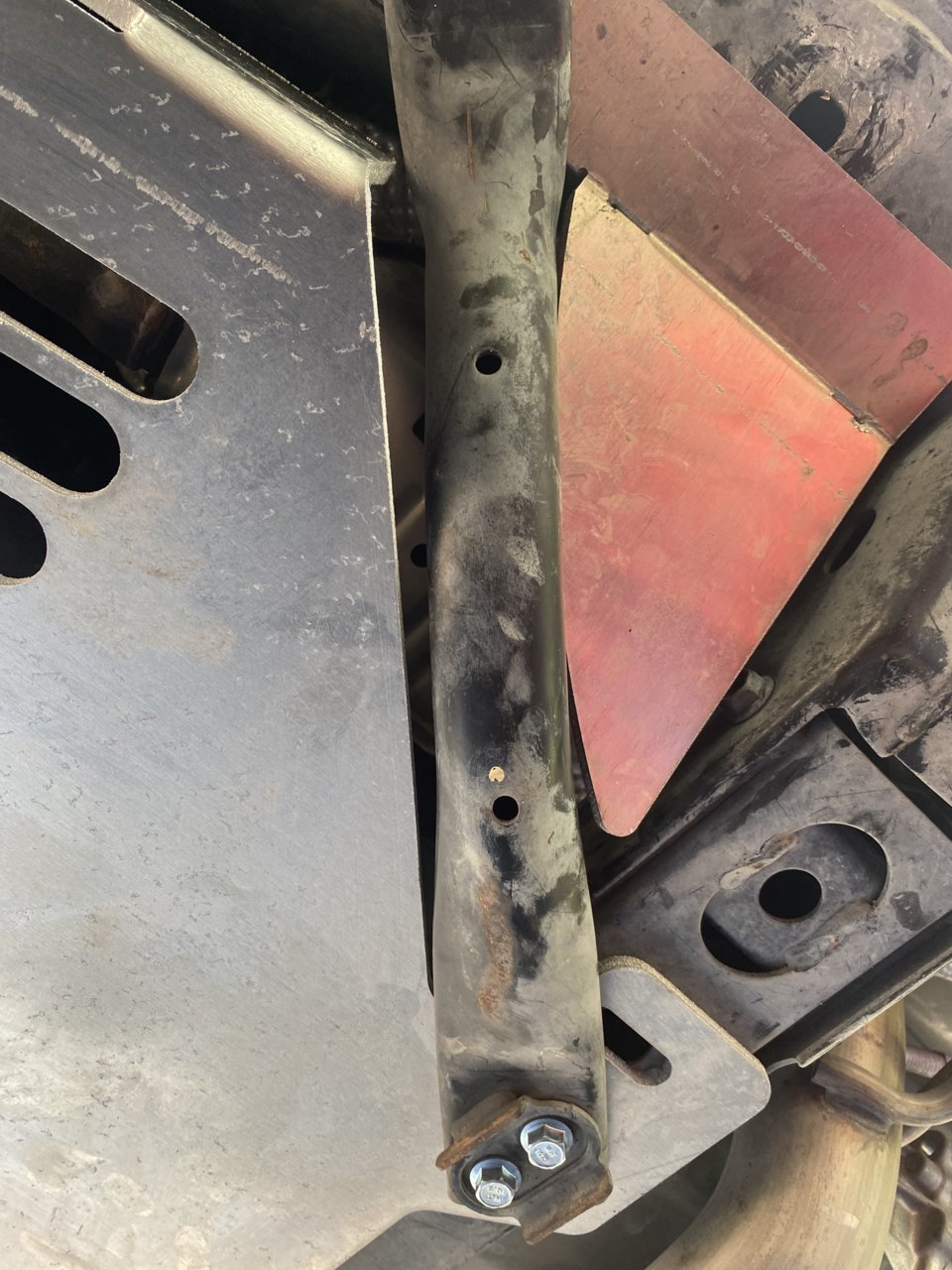

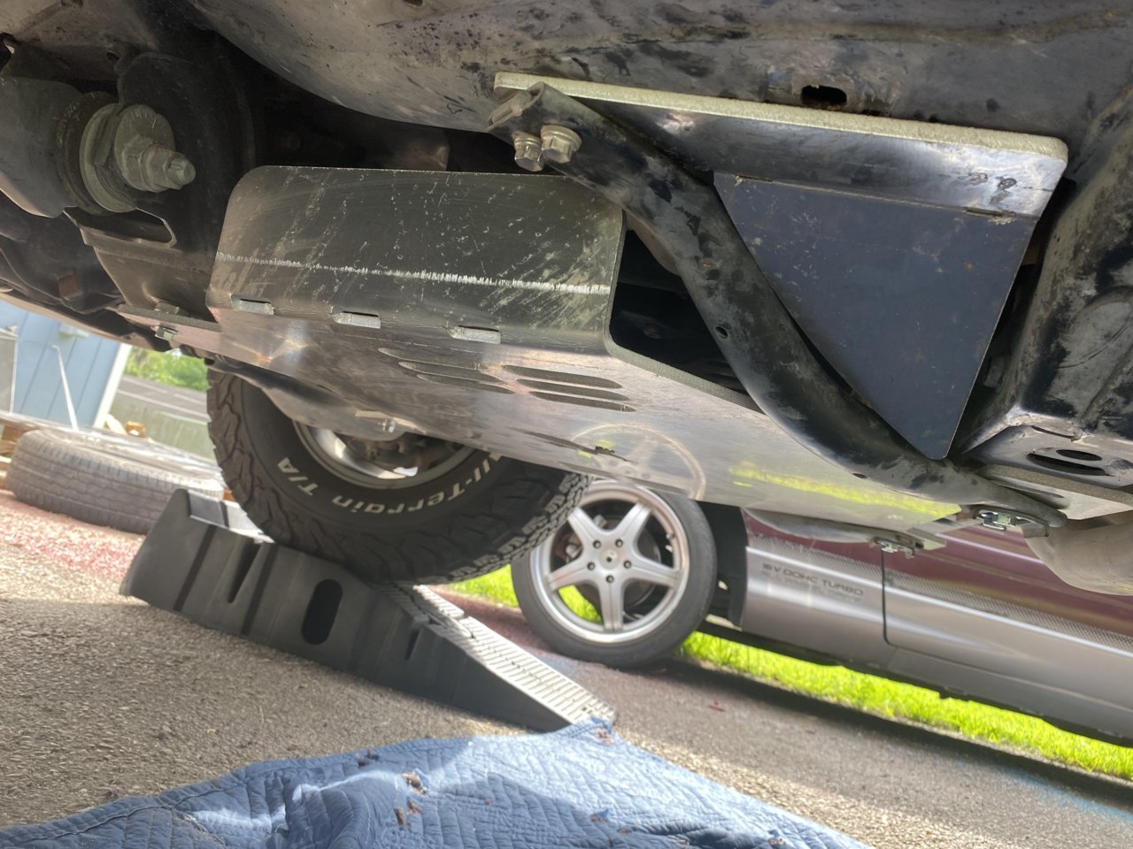

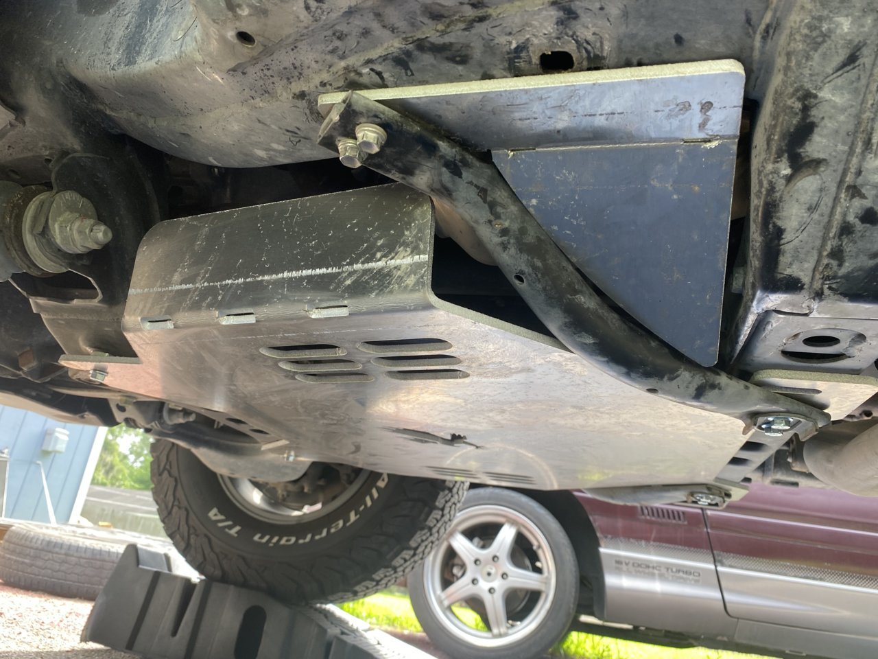

    Well…
    Just had a Tacoma over. Had to adjust a few things… but good news, I now have a transmission skid plate/ cat protector for the Tacoma.

    Let's not forget, this this will also work as a functional off road skid plate being 1/4" Aluminum. I believe other guys are offering them in 1/8" which is very light in aluminum. I plan on also offering this in 10 Gauge steel... Maybe 3/16th....
    Right now the limitation of this plate is it needs locking hardware... which is something I am going to get rolling Monday. Having trying to cut some 1/4" aluminum, they are most likely not going to cut this off, easily. Their 60 second job just became 5-10 minuets.
