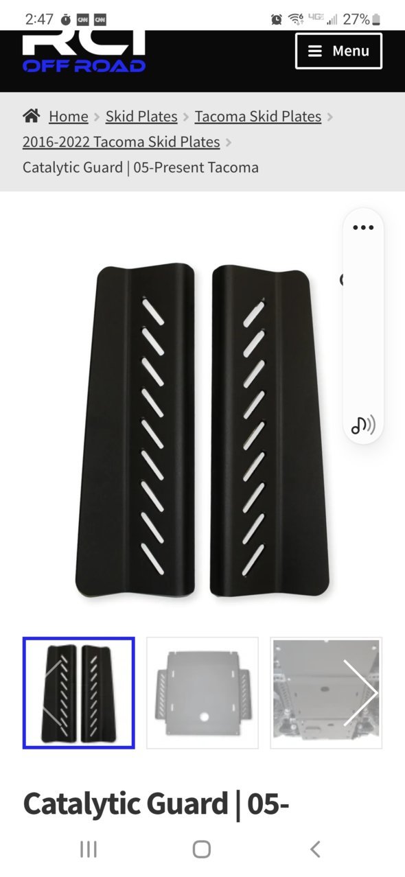

    A few, mainly added skids. I like leaving the suspension alone. I drive forest service dirt roafs in the desert west extremely extremely too fast. Toyota nailed this suspension going 65 across desert terrain. Changing it is dumb unless you have a specific need like crawling or mud.
    RCI makes a great Catalytic guard. It can't be removed without unbolting the transfercase plate (you need it too) . But the transfer plate is actual 2 parts and unless your a taco Catalytic converter pro you will just cut and cut and cut, only to find out you can't remove the transfer plate without losening the transmission plate. Which you guessed it. You can't lose without losenening the engine plate.
    Good luck to anyone who wants to attack that. The cat would be completed destroyed if you went at it with a saw. They know that, and move on to the next tacoma up the street (hopefully not yours)
    I'd love to see someone cut through my 1/4 inch steel.
    I realize for most this option is a bit of overkill. But if you plan on completing your skid plate package anyway this could be a great option with a company with well thought out designed product
