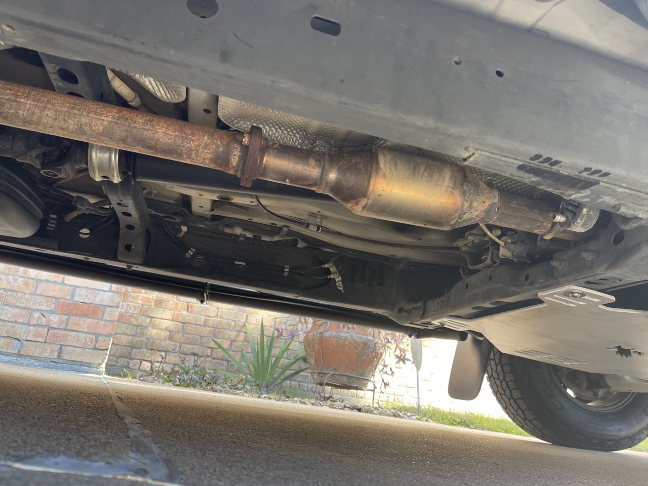

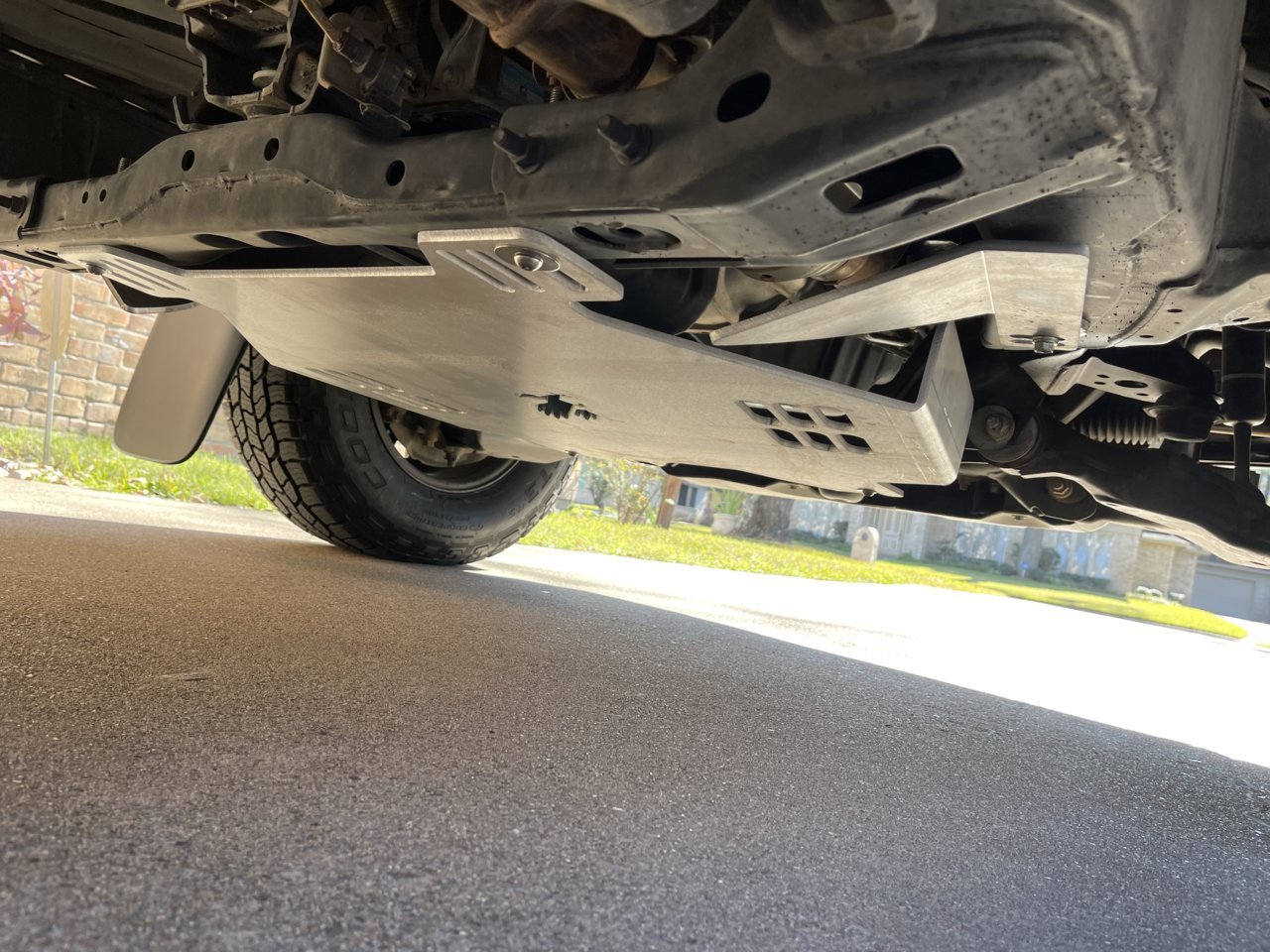

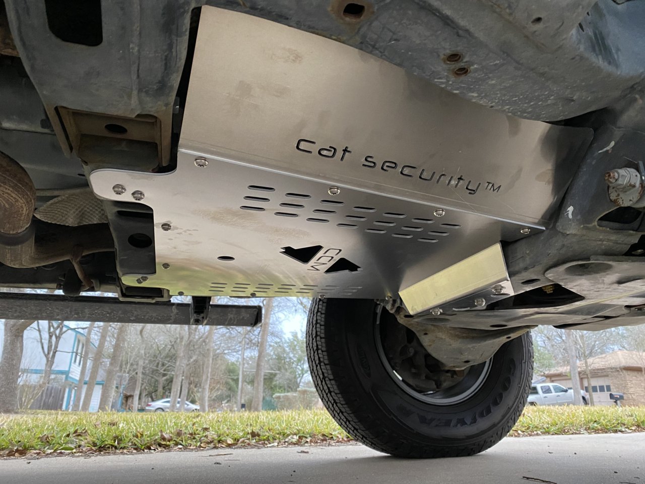

    This is the shield that's on my 2013 DC that I recently purchased from a Toyota dealer. They install this shield on all their Tacoma's and tundra's due to being targeted multiple times with the catalytic theft.

    I recently purchased a 2013 Double Cab, 4 cylinder at a local Toyota dealer and they made a point to mention that the Tacoma has CAT shield Protector installed by them as they install these on all their used tundras and Tacomas due to recent theft of CCs at their lot.
    I don’t see how this plate is protecting my CC. The two smaller pieces on each side of the shield can easily be unbolted or slid to one side. I also don’t see how I can change my tranny fluid. I guess it’s a deterrent but doubt if it’s a good deterrent. Do the 4 cylinders have one or two CCs. This is all new to me which is why I am asking.

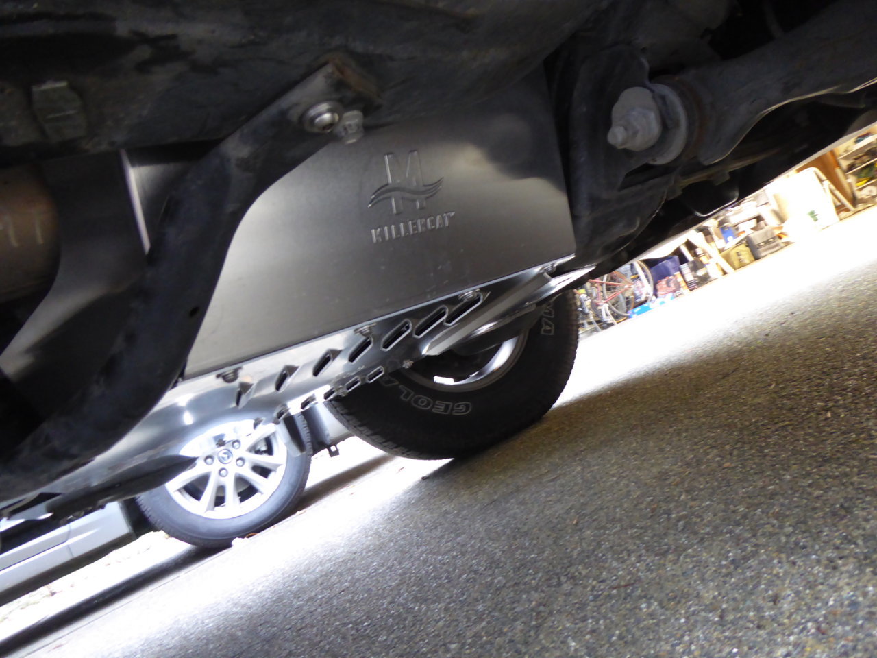

    Went with the Millercat as recommended by my Toyota dealer. Installed today on my 2017 SR5.

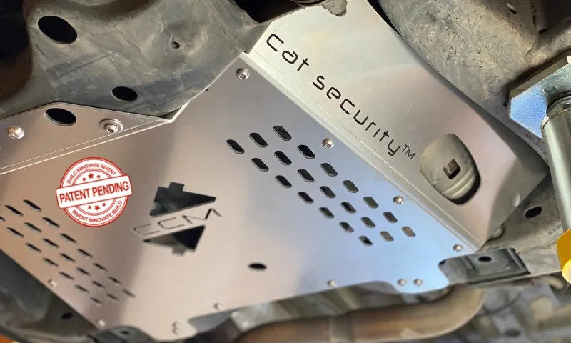

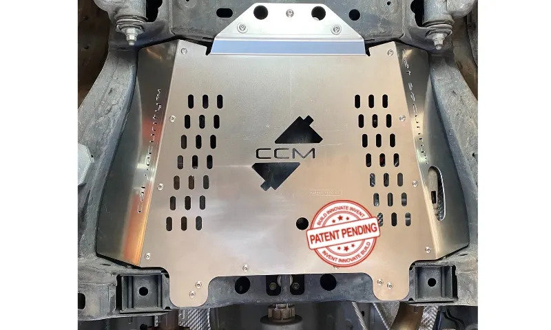

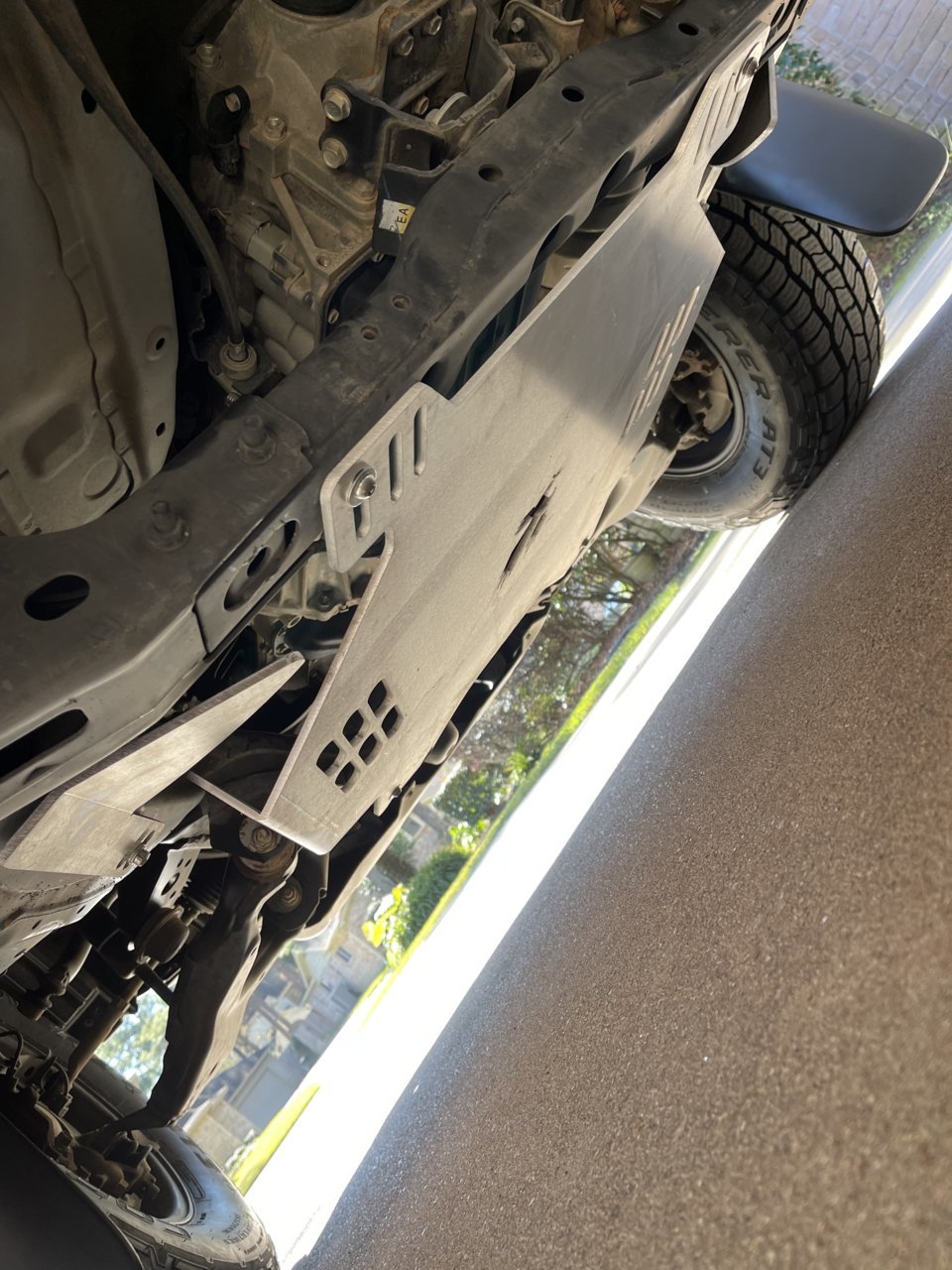

    Hey guys, I just received my Cat Shield from Cat Security, for my 2006 Tacoma Pre-runner Extend Cab V6 2WD, and after doing my homework it was the only true shield for a 2WD. There are other companies that say theirs will fit on a 2WD and they will not. The major difference is the height level comparison of the area's where you attach the shield. The 4WD's transmission crossmember and front suspension are level or flat, so a completely flat cat shield for a 4WD is needed. The 2WD has a lower front suspension so a step down type of shield is needed along with a smaller area to bolt to the trans. crossmember. I wanted the thickest one available, 1/4", and I thought I found the company that could make them, Tacoma Cat Shield-.jpg Tacoma Shield-1.jpg but they stopped replying to my emails? The one I settled for is 1/8" which is still pretty thick. I will provide photo's of my progress and tools needed to complete the job. In the two photo's the shield with the letters "CCM" in the middle is for a 2WD and the other Car A More is for 4WD. Can you see the difference.

    From what I can tell those plates from RCI are for 4WD. In the photo provided for 2WD you can see that the front suspension, top left side of photo, is lower than the transmission crossmember on the bottom of photo. That's something that is getting overlooked when some of these companies say there's will fit a 2WD. I paid $389 for the complete shield and hardware with free shipping. Tacoma Cat Shield-1.jpg
