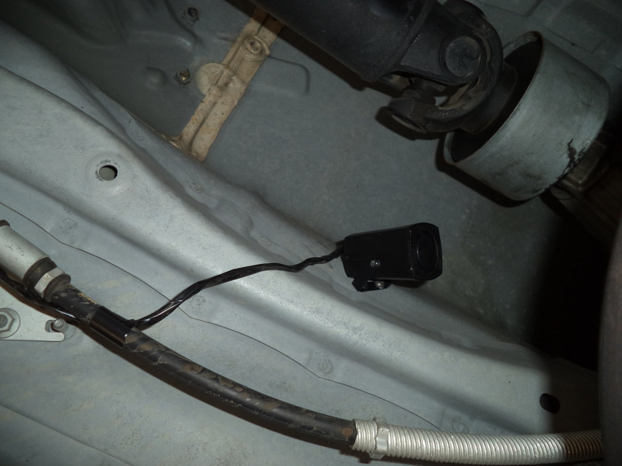

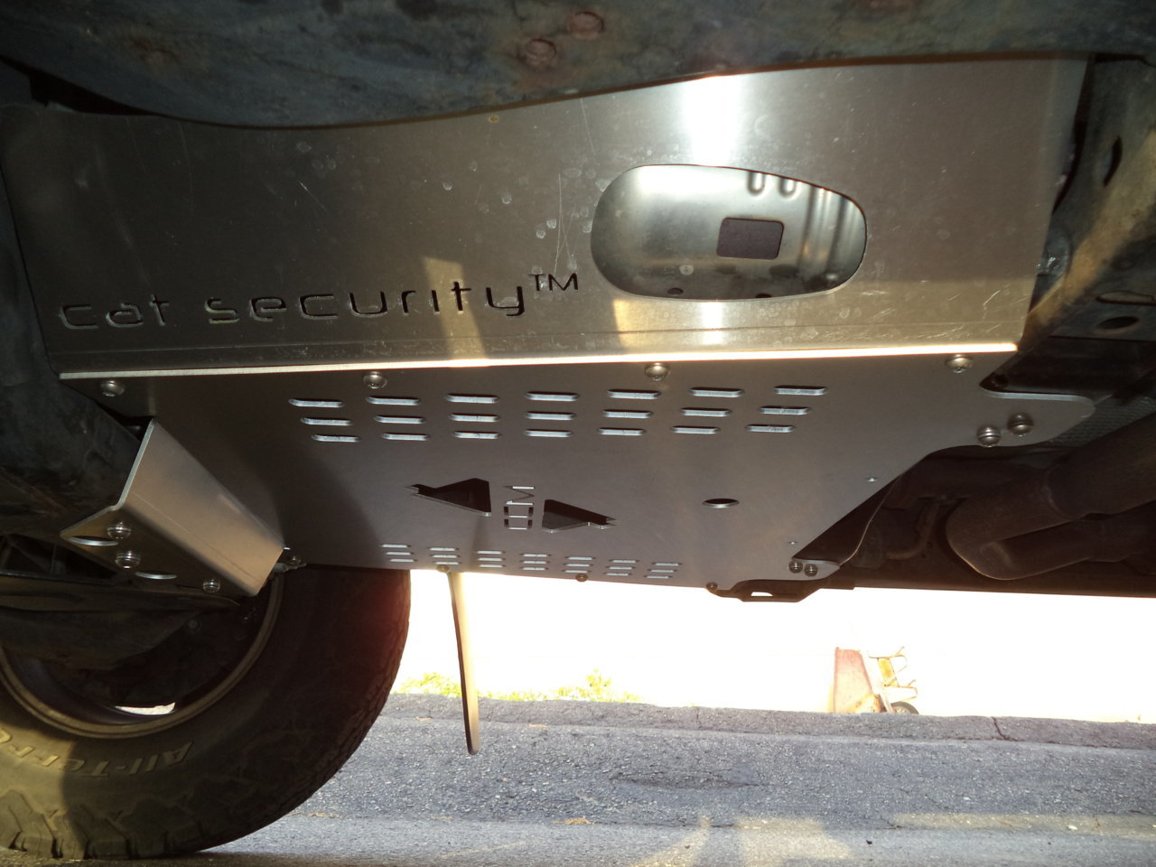

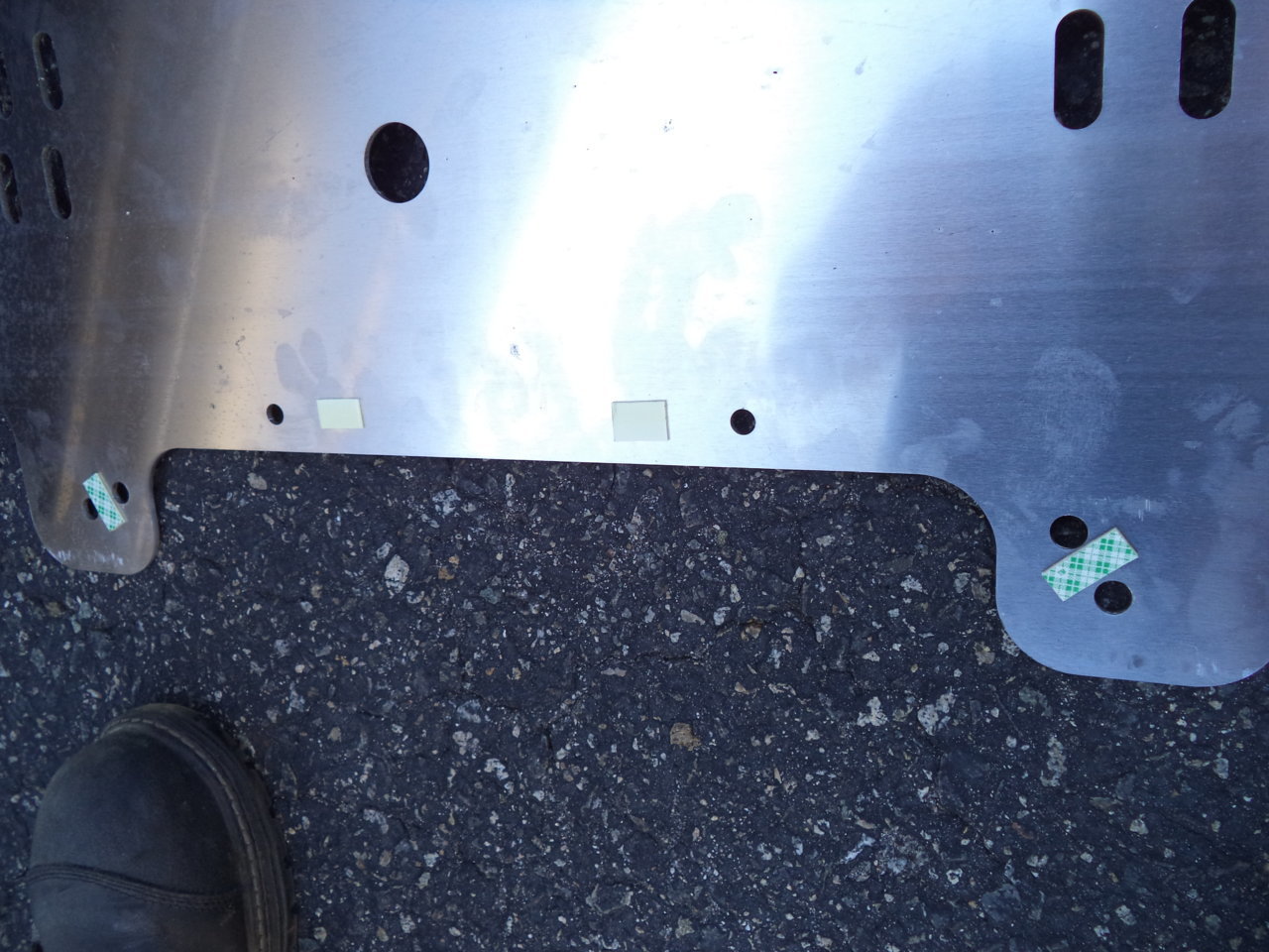

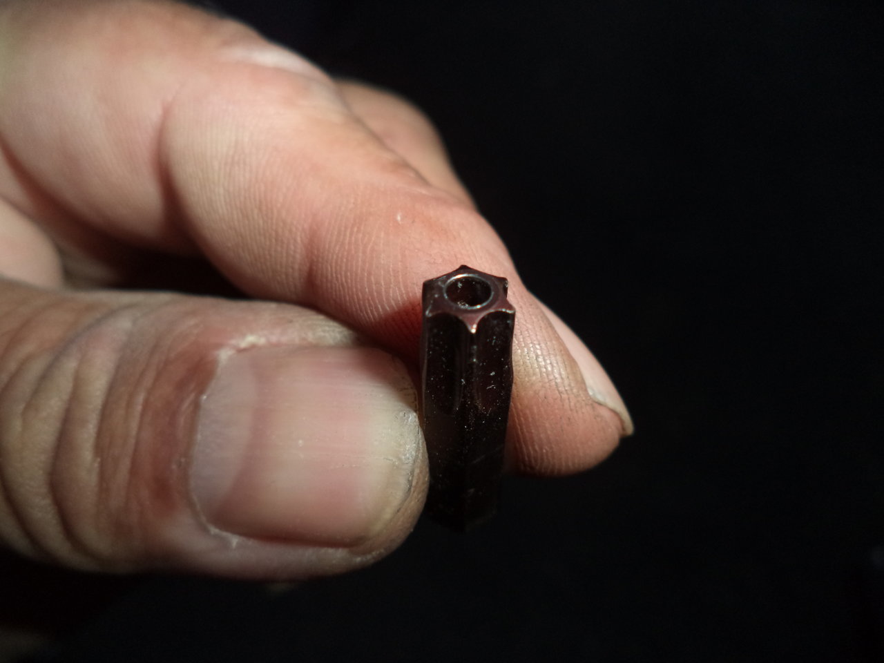

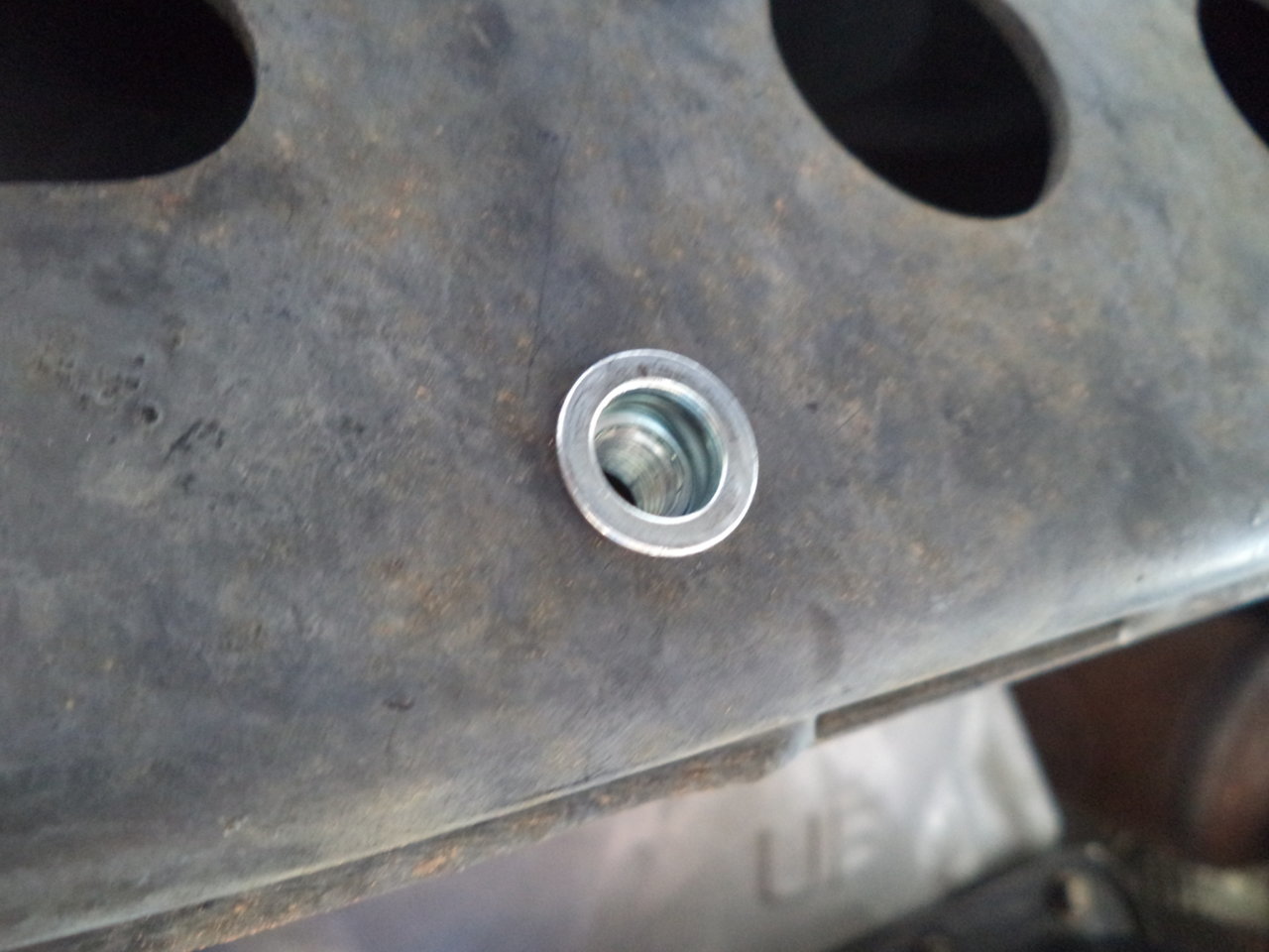

    Catback Flowmaster dual exhaust system-Serve duty tow package brake system for front and back-
    Tools needed for the job. The rivet tool makes installing the two rivets easy and if your like me, I've never used one. I goggled, How to use this tool, and got plenty of videos that helped. I purchased the tool from Harbor Freight at $50.00 and kept the tool clean, since I was only installing two rivets. Afterwards I returned it for a full refund. The bit to tighten up the mounting screws is a T-40 and I inserted it into a 1/4" socket with socket wrench. I took some 1/8" double-sided adhesive insulated foam and put it between the shield and where it mounts to and tightened everything up. This should eliminated vibration or rattling noise. Job took a few hours at home.

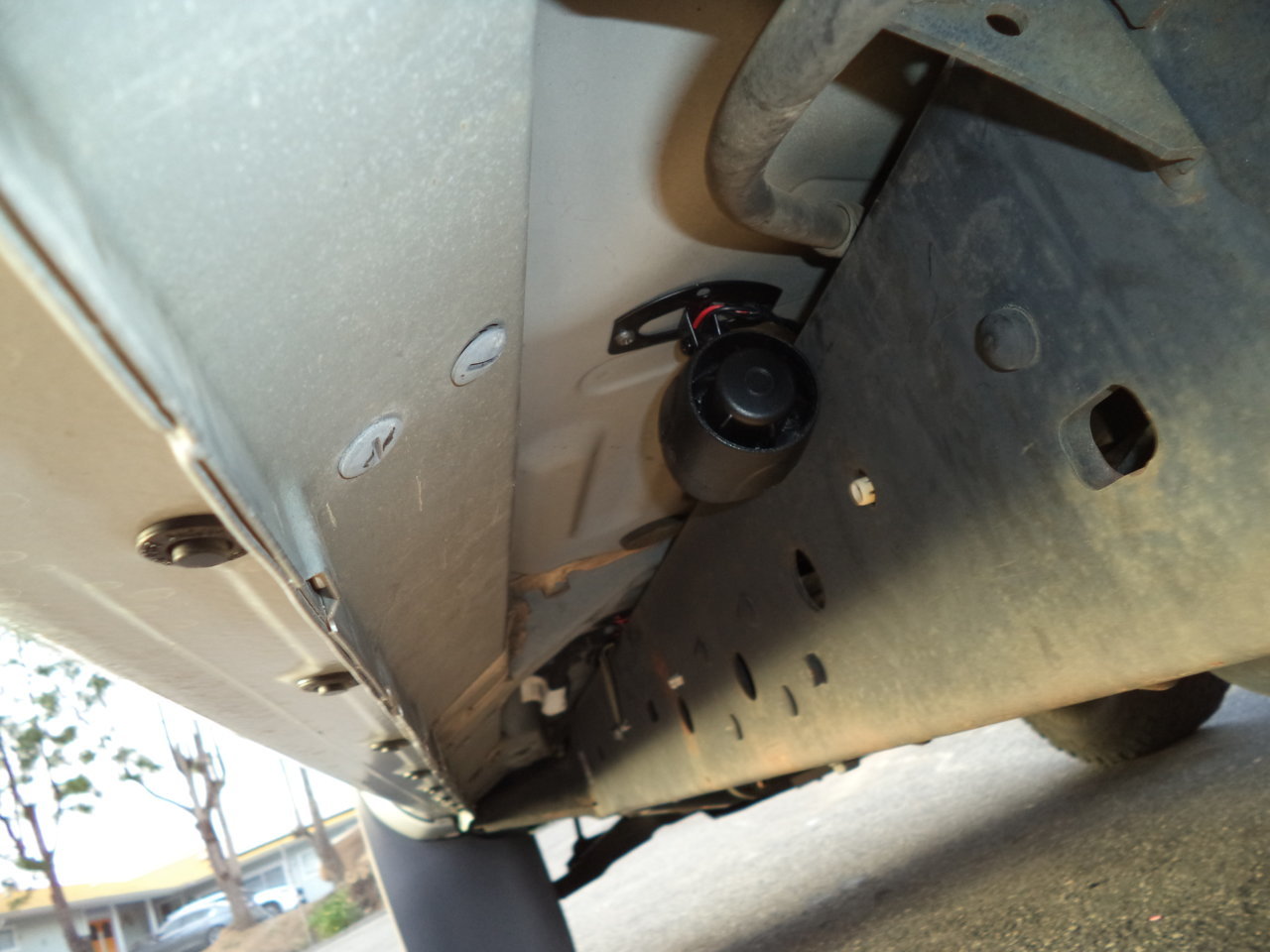

    I did have an alarm system installed with two extra sirens, making three altogether. The alarm is very loud and has sensitive shock sensors on the fuel tank and on the cat shield. The extra sirens are under the vehicle, one near the fuel tank and the other near the cats. That's it, that's all I can do aside from hiring a all night security guard. Yeah call me crazy but if this prevents me from spending thousands of dollars that I don't have, so be it. With the shield, the alarm and labor I spent $750, money well spent. Losing two of four cats would cost close to $4000 with parts and labor. Does anyone have a lead on fuel tank shields for a 2nd gen. Tacoma 2WD.

    Talon's is the thickest on the market, at 1/4", but in their photo I can see an open area, on the sides, where a sawzall can get in a cut the pipe ahead of the cat and then behind it and remove it with some effort? Also where their shield mounts to the front suspension I'm seeing where the mounting bolts are vulnerable and can easily be cut off. The Cat Security shield covers those area but is only 1/8" thick. I did bring up the question of the shields being cut, to the techs at Cat Security, and they said that the aluminum would clog the blades or grinding cutoff wheels and they would need to change the blades or wheels over and over before the thieves could cut the shield off. With an alarm system all this extra movement of cutting or pulling the shield would set off the alarm, and if you've got one like mine it will draw attention. I'm not puttin down Talon's shield, the thicker the better but they need to address the weak area's and they would own the market on these shields. It's ashamed that we have to do this but what are we going to do. Honestly I do feel much better knowing that I've done the best I could to prevent, not stop, these thieves from stealing my cats. The shields in the photo's are for 2nd gen. 2WD Tacoma's.
