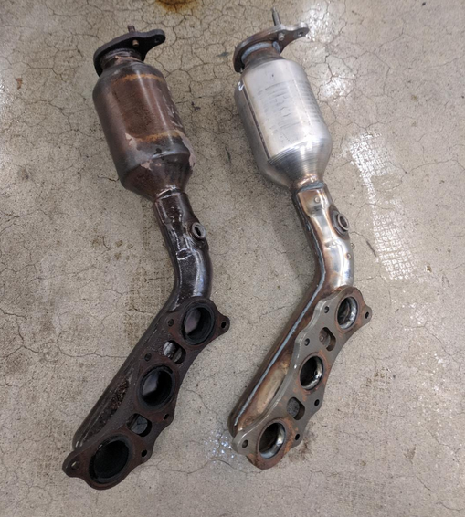

    Well I replaced the driver's side cat today. The catalyst material itself still looked OK from both ends, but when you shake the cat around you can see white sandy stuff coming out of it. Ive seen this happen with cats that fail prematurely, tiny specs start coming off and it looks like white sand. Glad I went with the OEM replacement, replacing was a breeze especially for anyone who has done exhaust work before. Should take care of the P0430 code, now ill just wait for the P0420 and do the other side when it dies eventually :hattip:

    Nice, how did you get the manifold off so easy? I have a 2005 with 130,000 miles and everything looks pretty rusty to come off "easy" Thanks

    Mine is the same year with 211,000 miles. The key for exhaust systems is using some kind of rust penetrate. I used a can of BG In Force, it was given to me for free by a BG rep that comes by our shop from time to time. PB Blaster works great as well and you can get it at Autozone. Spray every bolt on the manfiold, the y-pipes, the O2 sensors, let it soak and keep spraying. The longer you soak the easier it will be. I did have one nut that twisted off with one of the cat studs, but i was replacing the cat anyway so it didnt matter. As far as clearance goes, you dont have to take off any cross beams underneath or anything up top, except some of the fuel vapor hoses and vacuum lines just move those out of the way.

    4 1/2 years later and the P0420 code pops up, time to do the other side! Driver side is still holding up, I knew this day would come haha. I've had zero problems with my truck in that span, its at 285k miles now. Glad i went with OEM before, I just hope i can find the passenger side cat for a reasonable price.
