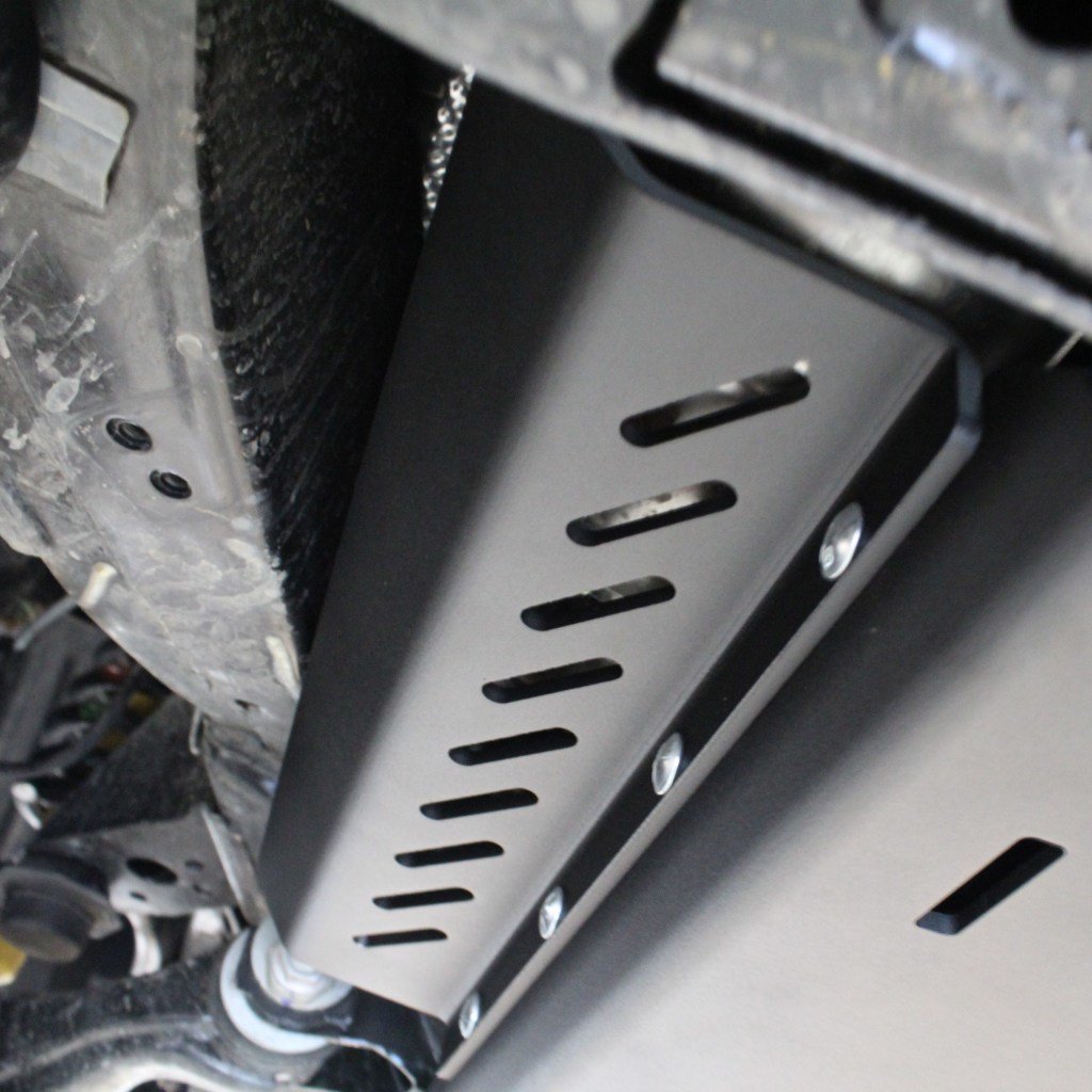

    Need to install a set of these to prevent this from happening again.
    https://rcimetalworks.com/https:/rcimetalworks.com/catalytic-guard-05-present-tacoma/
