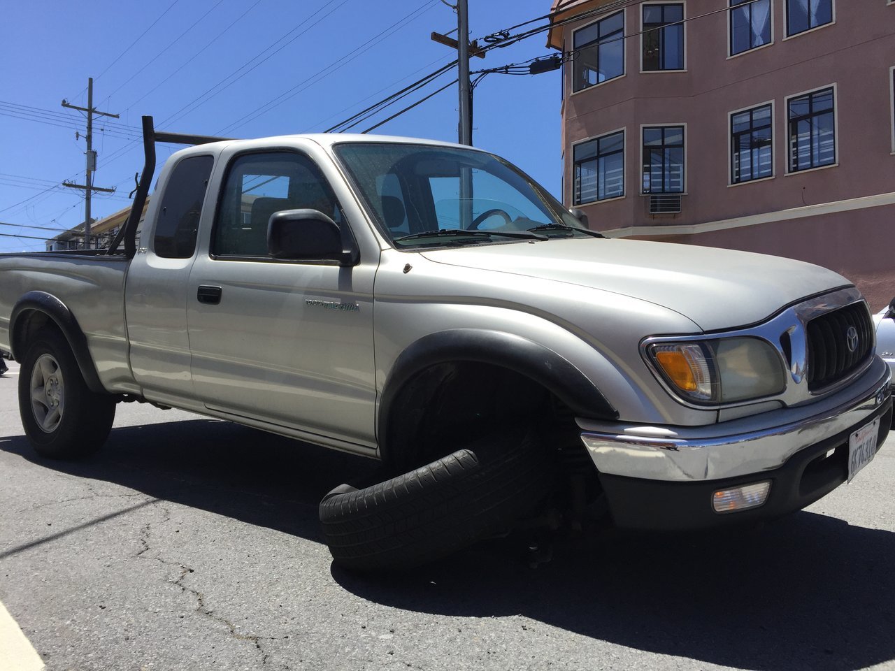

  13. Aug 19, 2017 at 5:08 AM
    Caquon
    Caquon Member
    May 27, 2017
    #220066
    19
    Bay Area
    2002 Prerunner V6 AT
    JunkButLoud speakers, Kenwood DD, Pro Comps and Ko2s
    IMG_0088.jpg We're twins
