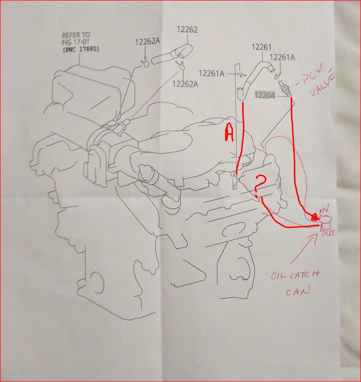

    Pictures of how and where is installed please. Hose connections with pictures in details appreciated.

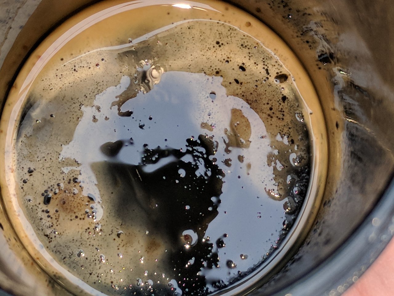

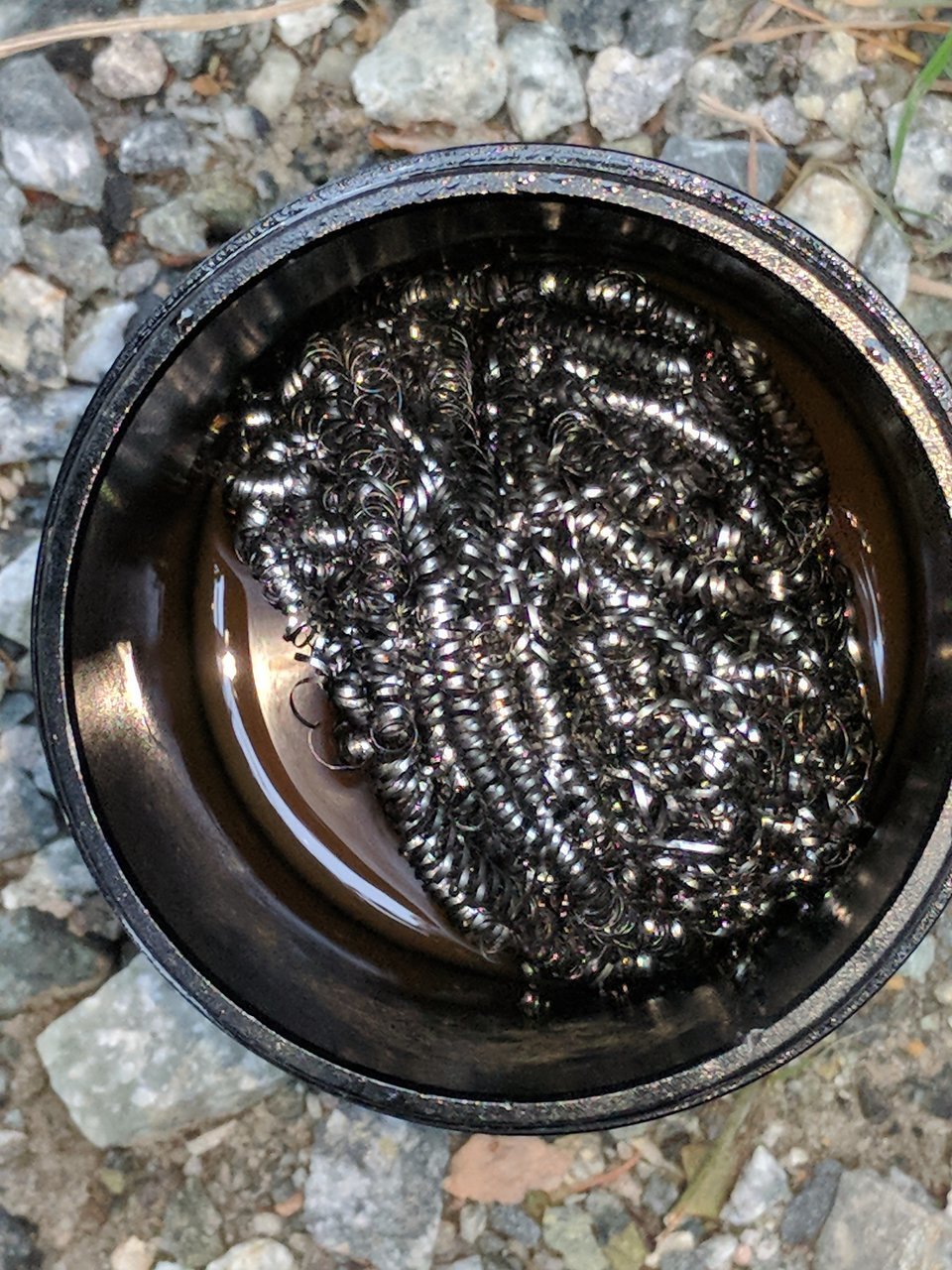

    Here you go
    DustStorm4x4 and tcjacado like this.

    In stock form, hose A is connected to port down (red line) that goes to PCV and from there to oil can IN, right? SO where is the OUT going to? In your diagram it shows OUT to PCV port IN. Will check mine tomorrow but I like to have knowledge in advance.

    Yes there is a hose from A to B stockwise, its part 12261. Remove that hose at pcv valve @A and run new hose to in on catch can. Then run a hose from out on catch can to location B
