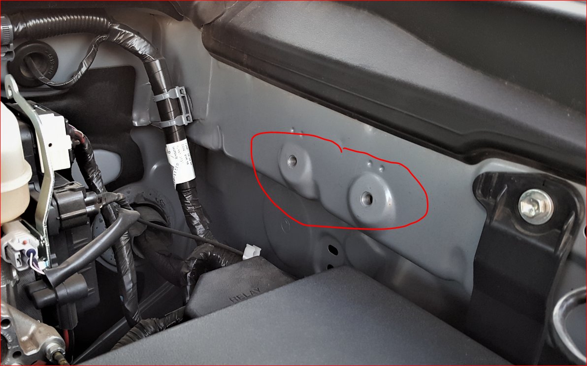

  13. Nov 21, 2017 at 7:26 PM
    #73
    Dacon
    Dacon 2017 Tacoma TRD PRO Quikrete
    Dec 20, 2016
    #205354
    2,932
    Danny
    Gilbert, Arizona.
    2017 TRD PRO DCSB. DOP 02.20.2017
    TRD PRO Cement 2017 TRD CAI and AFE Magnum Flow Dry Air Filter Camburg KINETIK Series Billet UCA Icon LCA skid plates Icon Coilover extended travel shocks with 700# springs Icon 2" rear shocks Icon RXT leaf springs full pack (new rims and tires soon)
    ...and what size are those threaded holes? Have tried a handful of M and S screws and none fit.
  14. Nov 21, 2017 at 8:14 PM
    #74
    Nitori
    Nitori Well-Known Member
    May 3, 2016
    #186058
    4,878
    Maricopa AZ
    2021 T4R SR5
    If I remember right, it's M8x1.25 :)
  15. Nov 21, 2017 at 8:44 PM
    #75
    Dacon
    Dec 20, 2016
    #205354
    2,932
    Danny
    Gilbert, Arizona.
    Got 7 of them. Must be a Chinese M8...none fit, hole is clean. Time to tap.
