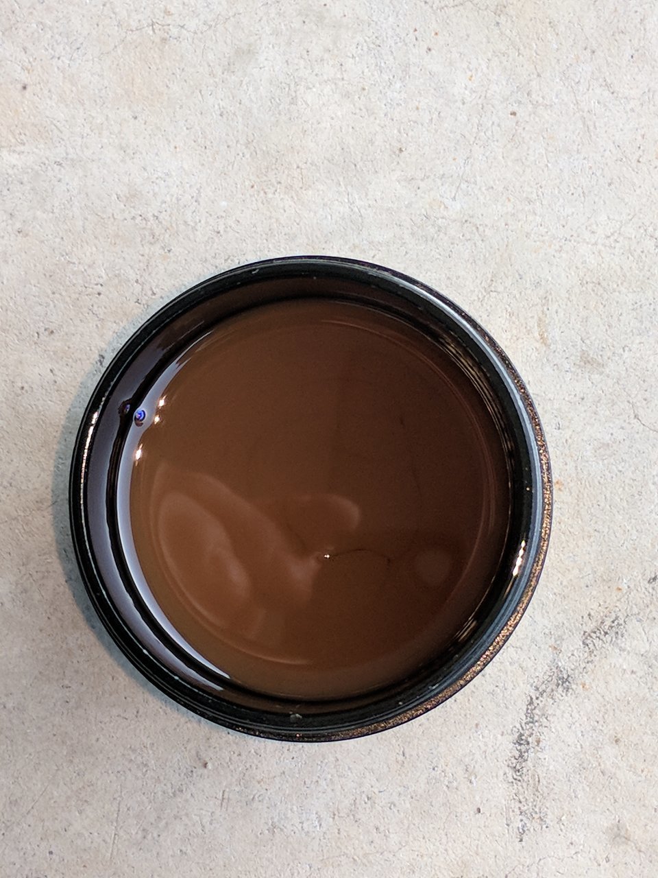

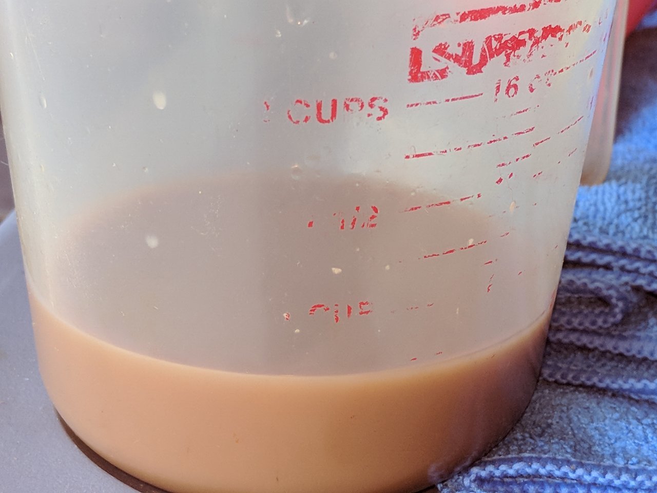

    Update, another 5k and this is the crap it has stopped from going in my motor. No coffee for this turd,
    IMG_20180114_160548.jpg IMG_20180114_160844.jpg IMG_20180114_160548.jpg IMG_20180114_160844.jpg

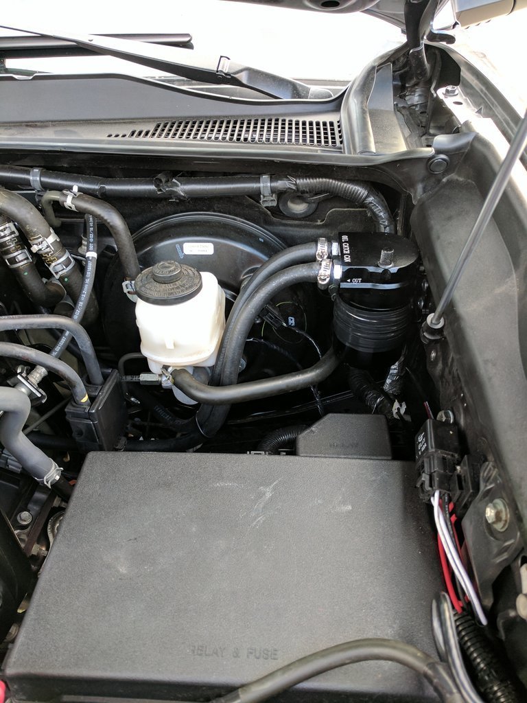

    [​IMG] My setup for those interested. I've put a catch can on every car I have ever owned. A debatable subject for sure but every time I drain mine I'm like, yeah this was a good idea!

    That milky oil is being created by your catch can. Water condenses in the can itself, and the can never gets hot enough to drive off the moisture. It’s creating moisture where there should be none, just like any bottle or vessel that is constantly heated and cooled, but never allowed to boil off like the engine itself is.
    Most of the water created by your catch can probably ends up eventually getting sucked into your engine, leading to increased wear.
    Id get rid of that thing before you join the “55k engine failure” club.
    There is no way I could sleep at night knowing water is condensing in my catch can.

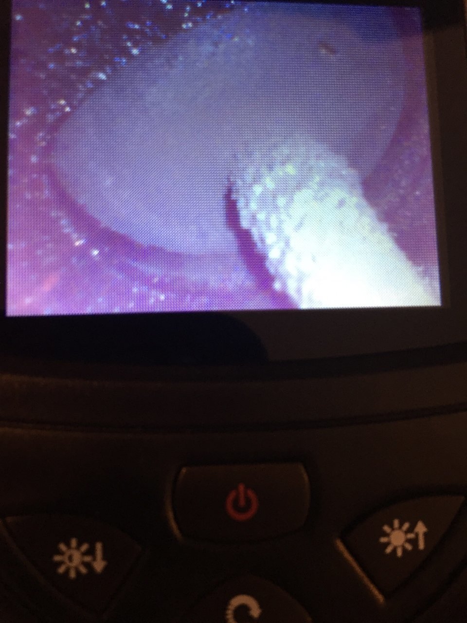

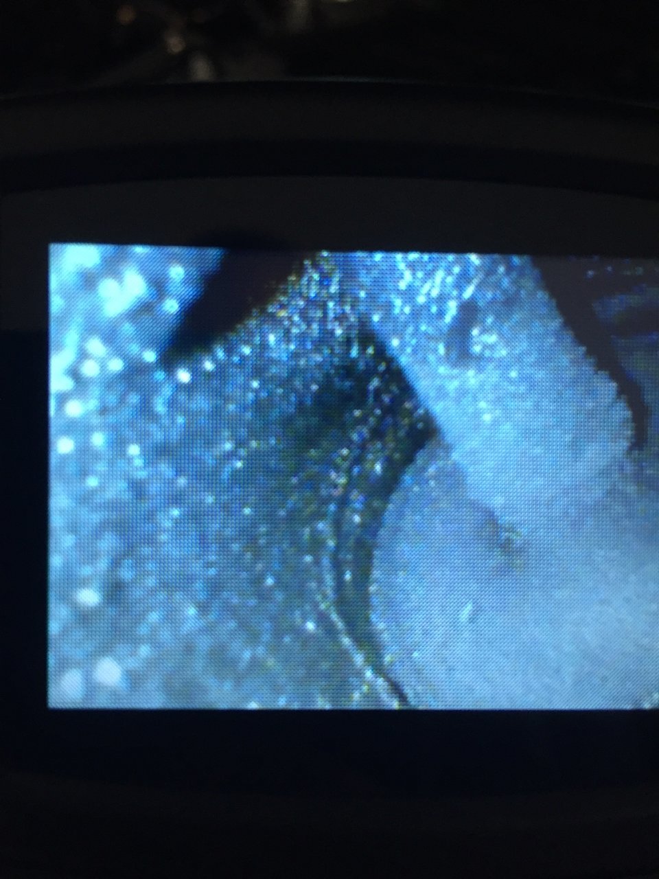

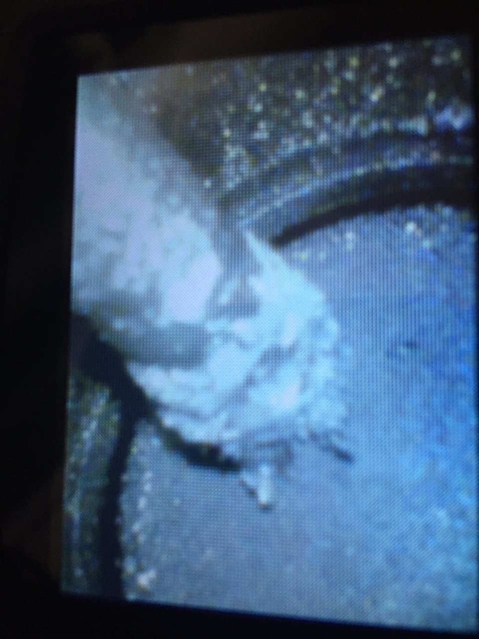

    Don’t worry, our Tacomas are safe.1733BBD7-35A7-499B-A218-73FB1AD461BD.jpg 822CFA4C-A42C-4BC1-89DC-621A20AAB635.jpg D36EDD39-8A79-43F9-AF9D-3CC4AE7AE466.jpg D2CFEFC4-11E9-42EF-860C-8E5BB567D115.jpg

    Pics are of my first generation twin turbo 2.7 eco boost engine with only direct injection.
    Ford added port injection to the new 2017 3.5 liter ecoboost and new 2018 2.7 liter ecoboost engines.
    I purchased a cheap bore scope from Harbor Freight and fished it into the disconnected air intake at the top of the engine because I was curious as to what the valves looked like at about 12,500 miles because the engine was occasionally stumbling slightly at idle while at stoplights.
    So, I decided to start looking into it. A better borescope would be good for better resolution.
    I held open the intake flap with a screwdriver, fished around to various cylinders and took pictures of the borescope screen with my phone. Carbon was building up on the stems, but the back of the valves weren’t too bad at all... yet. The pictures were taken after doing about 20 miles of high rpm freeway driving shifted into lower gears in attempt to remove some of the buildup. I had the motor humming loudly. That didn’t work.
    The first oil change had been done at several hundred miles, then at about 5,500 miles and 11,000 miles using Mobil 1 5w-30.
