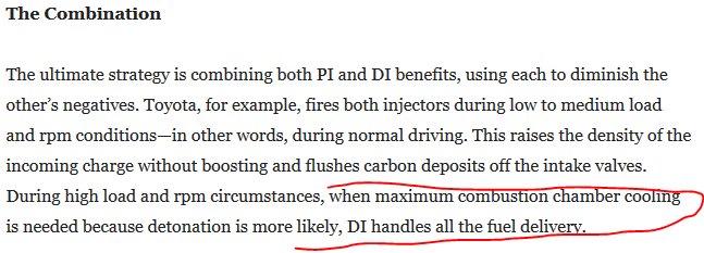

    Since many taco owners like to reeve up the engine to compensate with the lack of power, DI takes over.
