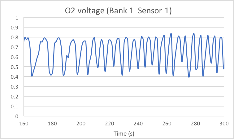

    I've suspected that my 3rz has been running a bit rich for a while. Long story but I replaced my head twice in 3k miles. When I took the head off after 3k miles I was really surprised how much carbon buildup there was.
    I got a CAN data logger and watched the O2 voltage. I don't have the fuel trim channel for this dataset but based on my understanding of what a healthy system's O2 data looks like, I think something is not right with mine.
    Here is a plot under steady state highway driving, all warmed up:
    As you can see, the dc bias is about 0.6V instead of 0.45V like it should be. The O2 sensor is a new Bosch 13104. The engine has new plugs, fuel filter, air filter, and a fresh valve job.
    Any ideas what to check?

    EGR Valve, try to block it off with some tin from a spread out coke can and recheck readings.
    What I do is unbolt it to the manifold, take the gasket, trace it and simply reinstall a gasket without a hole for exhaust gasses to pass through.

    Hadn't considered EGR. I'll give it a try.

    how is/are the cats and the rest of the exhaust system?

    Might need to clean or replace your MAF sensor.

    Typically MAF issues are lean, unmetered/registering air getting past a sensor results in lean.

    I don't know why the EGR valve would cause a problem with the O2 readings. The exhaust gases are inert, CO2 and H2O, so they don't affect the fuel/air (O2) ratio at all.

    O2 voltage looks fine. Why do you think it’s lean?
