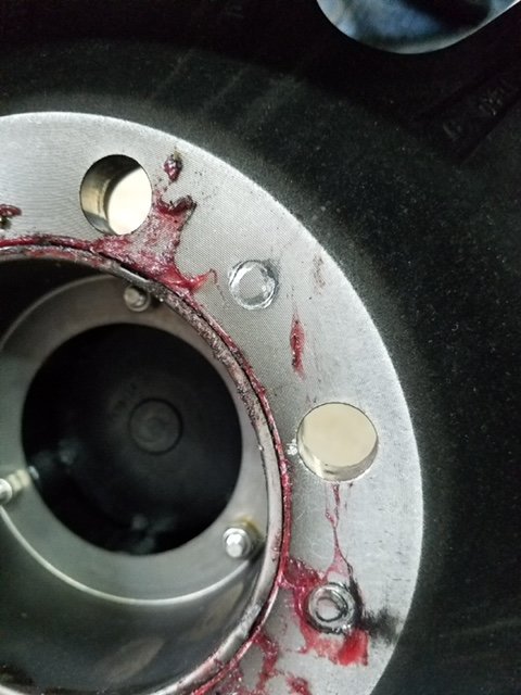

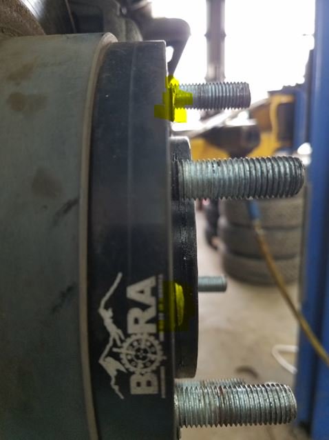

    jrmitt808
    jrmitt808 [OP] Well-Known Member
    Sep 30, 2010
    #44036
    120
    JR
    Queens, NY
    2009 Toyota Tacoma DC Sport
    6" BDS Coil-Over System with Fox 2.5 coil-over Shocks , Wheelers 1/4" Top Plate Spacer, AAL, Total Chaos UCAs, TRD Single Outlet Exhaust, Tint,K&N 63 Series AirCharger High-Flow Intake Kit, All Pro Bumper and rock sliders.
    so check this out...went there and this is what I see. The studs are a lil too long for the spacers which was pushing on the wheel.
    I am a little annoyed because the installer should have noticed this.

    That makes sense the stock lugs are longer than 3/4". Same problem would be out back too I would imagine.

    The lug nuts they sent with my Bora's stick out past the spacer 1/4". o_O
    So they are sitting in the box. Yes that is 1.25" spacers too. Sticking with my Spidertrax.

    Some wheels have a small pocket cutout o the back, OP's wheels are flat on the back. Other guys could have had their studs cut correctly or they have those small pockets that accept the extra stud.

    Possible, when I bought mine I saw a warning to check your wheels, chop the stock stud, or replace the studs. My wheels had conveniently placed pockets right where the stock lugs poke through, so mine are fine.

    Had the same issue on my 4runner years ago. Couldn't get a vibration to disappear and finally after switching to a 1.25 everything was fixed. Some wheels (stock) have grooves in the back of the wheel that the studs can fit into and thus they don't cause an issue like with some aftermarket wheels.

    That is a user installed error not identifying and correcting the protruding studs before final install.
    I had to ground down the studs to make my spacers work correctly, took about 5 minuets of grinding so the studs sits below the spacer.
    My Bora .75" spacers have been installed for a few years now without issues.
