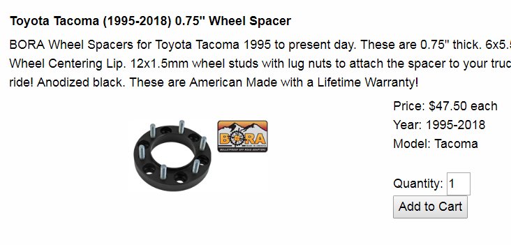

    Wouldn't adding any width of spacer require the stud to be longer than the stock ones? Using stock studs with a spacer seems unintelligent. Unless I'm missing something.

    They come with new studs built into the spacer, these studs are what you'll affix the wheel and lug nuts too. The stock studs in your hub use a small open end lug nut to hold the spacer to the hub.

    Oh I think I see. So his stock studs were keeping the wheel from seating all the way because they were sticking too far out of the spacer?
    So its more of an "adapter" than a spacer. I've run similar on Volkswagen's if the bolt pattern on the wheel was different than stock. Accomplished both spacing the wheel and changing the bolt pattern. Couldn't you just swap the stock studs with longer ones and avoid the multi-stud/nut combo?

    So an "adapter" would allow the use of a wheel with a different bolt pattern. These truly are just spacers as they keep the same bolt pattern and only push the wheel out further.
    If you ran a hub centric spacer without studs then yes, you'd need a set of longer studs.
    Either style is just fine, but with OP's style spacer the stock studs either needed a recessed pocket to accommodate the extra stud or have his studs cut down below the line of the spacer.
    You can see in OPs first two pictures where the extra stud length left small impressions on the back of his wheels as well as the ~1/8" of stud sticking out creating this issue.

    Makes way more sense. Guess I didn't know there were spacers like that. Would probably be more secure than a hub centric spacer I suppose. I would think whoever installed them would notice something was amiss but stranger things have happened.

    Well before you leave you should know these spacers are hub centric haha. It's ALWAYS better to go hub centric when available.
    Hub centric simply means the center hole on the spacer matches the hub diameter of your vehicle, and there's an extra lip to again match the hub dimensions so the wheel has a solid lip to seat to.
    But yes, you can get a design in which requires longer studs or a design where it comes with the studs built in.
