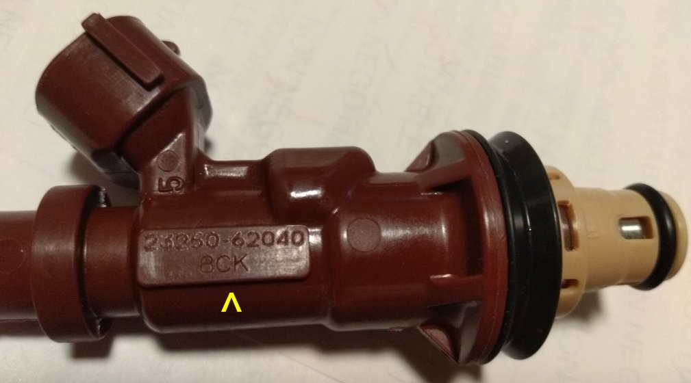

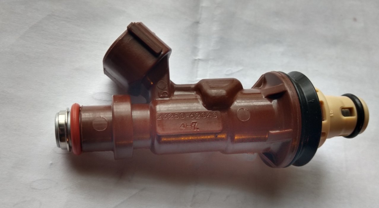

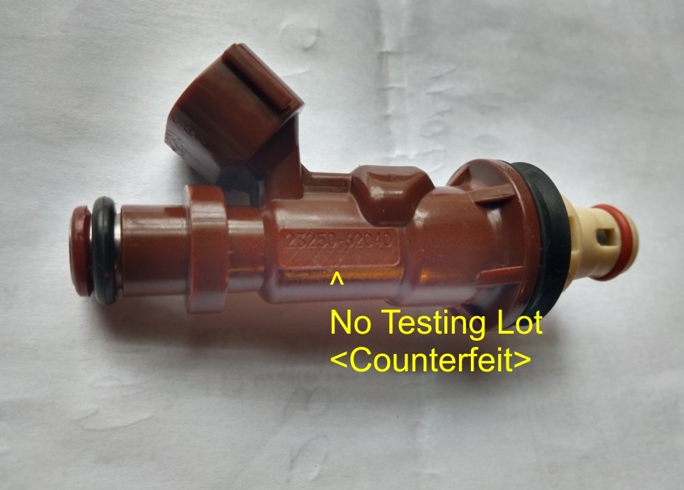

    Here are some counterfeit vs. genuine injectors in the picture below with some Genuine Denso coil examples. Once you get the knack of looking for QA Lot numbers, it's easy to spot the counterfeits.
    Counterfeit Example #1
    Real Example #1 - Quality Lot Number is 8CK
    Real Example #2 - Quality Lot Numbers will not use the same font as the part number and may not be perfectly aligned with the part number. The numbers are stamped added after the injector has been built and tested.
    Here's a pitiful example of counterfeit injectors.

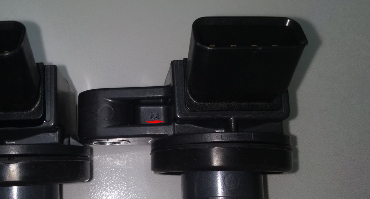

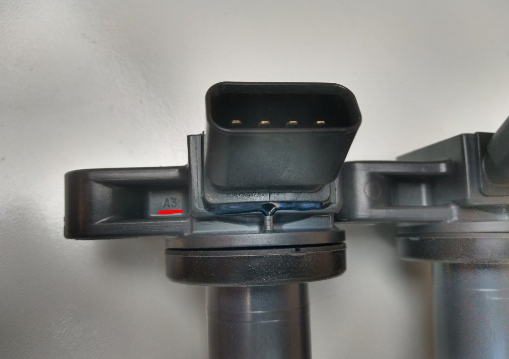

    Other Denso products like ignition coils use Quality Lot Numbers - The lot number for this coil is A3
    The Quality Lot number for this coil is A4.
